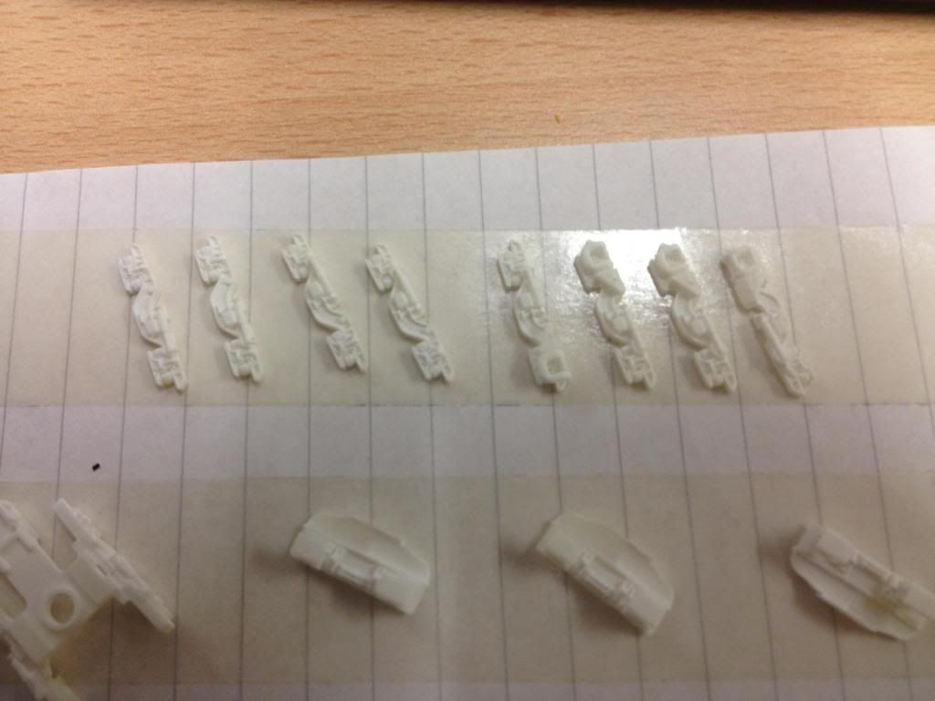

Here are the packets that you will receive from us:
Make sure that you give all of the components a good clean before you start any painting.  The 3D prints will be covered in a wax type residue that must be removed.  I have found that a soak in white spirit and a scrub with an old toothbrush is best, but other methods can be used.
Spray your 3D prints with a good quality ACRYLIC primer (not enamel).  Once dry you may wish to use a metal file to carefully hide any print lines that show up.  Many members use Halfords grey car primer, but I have used Hycote Grey Primer - purely as you can buy it on a well known auction site.  ;)
The buffers are glued into place on the chassis and are to be sprayed black, along with the chassis.  The Kato bogies are easy to place on the chassis, and simply use the screw provided to secure them.

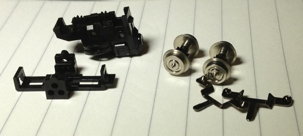

The motor is taken from the TM03 or TM04 chassis that you purchased.  You will need to remove the plastic surrounding it until it looks like in the picture below.  There will be two tabs left on it to which you connect the wiring.
You will need to remove the bogies from the TM chassis.  The non geared bogie is easy to remove, with the geared one being trickier.  I found that taking it apart was the best way to remove it.  You will then need to put the bogies on the 'cab ends' of the MPV chassis.
