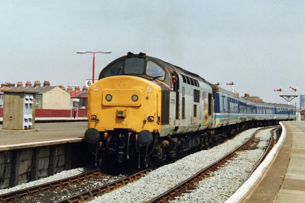

The Club trains to Blackpool used to reverse out to the carriage sidings to run round the stock then reverse back into the station.  The guard would be in the leading coach on the "butterfly" as with this pic of 37278 below 13/06/92 which worked in with the 10:33 from Manchester before working the 13:25 to Liverpool:
