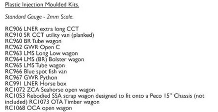

So, it looks like the n gauge kits are being reintroduced by five79. Fantastic news

Good news indeed! Not sure when stuff will be available though? Seems there is a lot of sorting out of what is quite a big range, with N a small part.

I would certainly be pleased to see the return of the LNER Extra long CCT and would buy a couple of LNER horseboxes as they haven't been available for quite a while, but I guess it is a case of being patient.

It is indeed good news though I notice the BBA steel carrier is missing from the list.

I got a message last night from Matt to say that the omission is a mistake
