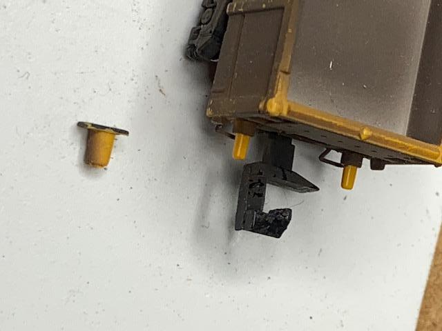

I have a couple of Dapol JNAs which have lost buffers
The image shows one of these wagons with its one remaining buffer detached. They very easily pull off and this is presumably why I have lost so many buffers.
Any one know of a supply for said buffers? I need at least 6.

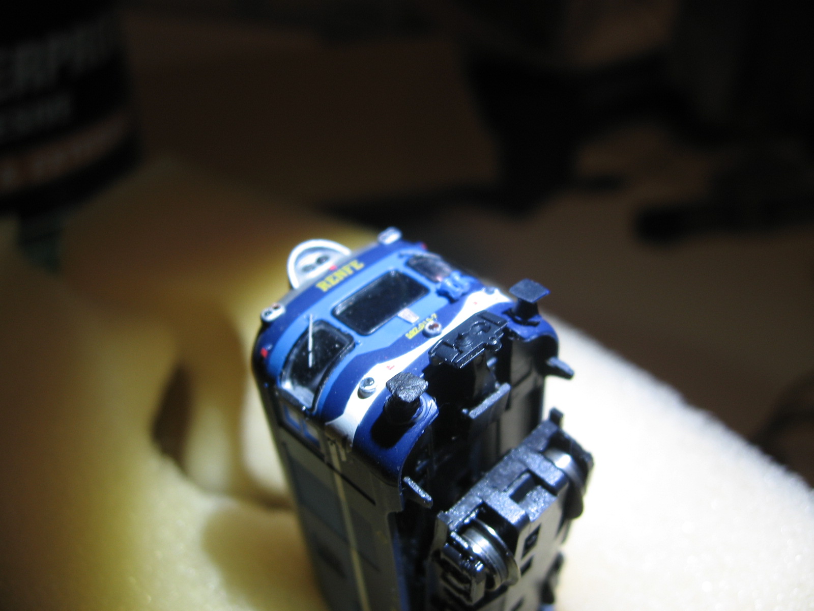

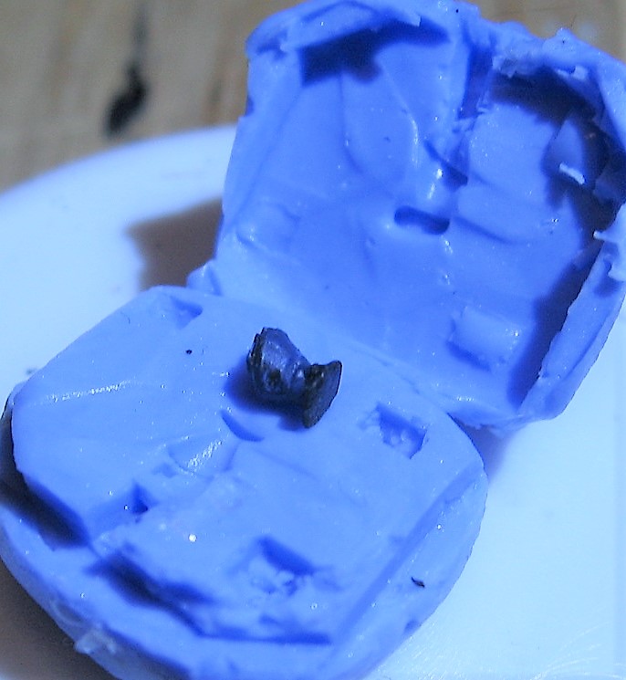

remembered I took a couple of photos whilst casting a replacement buffer for one of @weave 's Spanish units I was servicing.  The piece needed to be a specific curved shape to match the rounded ends of the model, so best option was to cast a new one based on the equivalent buffer from the other end.
Hopefully you can see that  after creating the main lower half mould I cut a recessed edge and some locating holes so that the top half mould would include some "keys"  and ensure the two halves fitted together accurately.
This was actually the first attempt, I wasn't happy with it and made a second casting  (and didn't take any more photos doh!), but you get the idea!

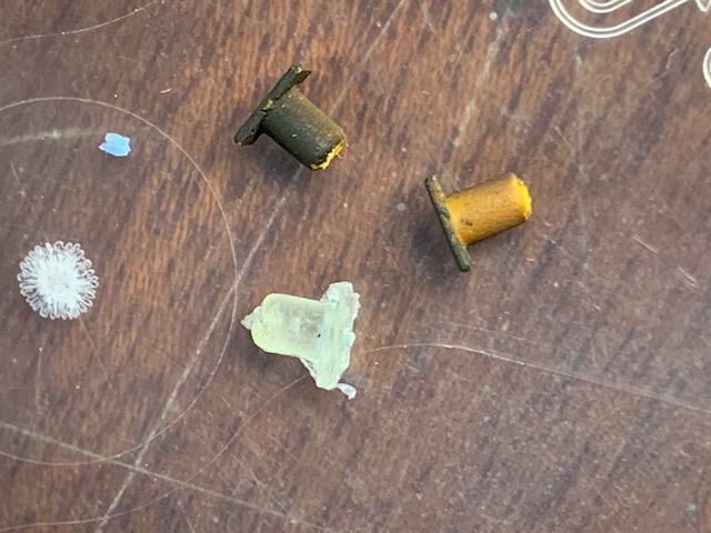

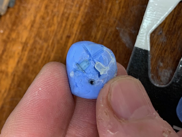

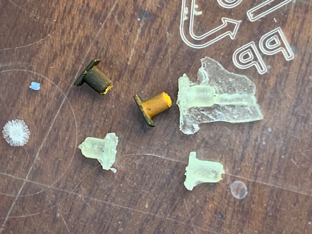

Here is my firt attempt. Im reasonably impressed (ooh bad pun).
I actually made two molds. The first pic shows one of them. Im pleased taht there is something which looks reasonably like a buffer that may possibly be tidied up enough. Ive currently got another two curing in the mold at the moment. Ill see what theyre like. Obvioulsy the resin will need to sure for 24 hours before I can really clean up the buffer.
Interesting little exercise though. And thanks again ntpnntpntp.
