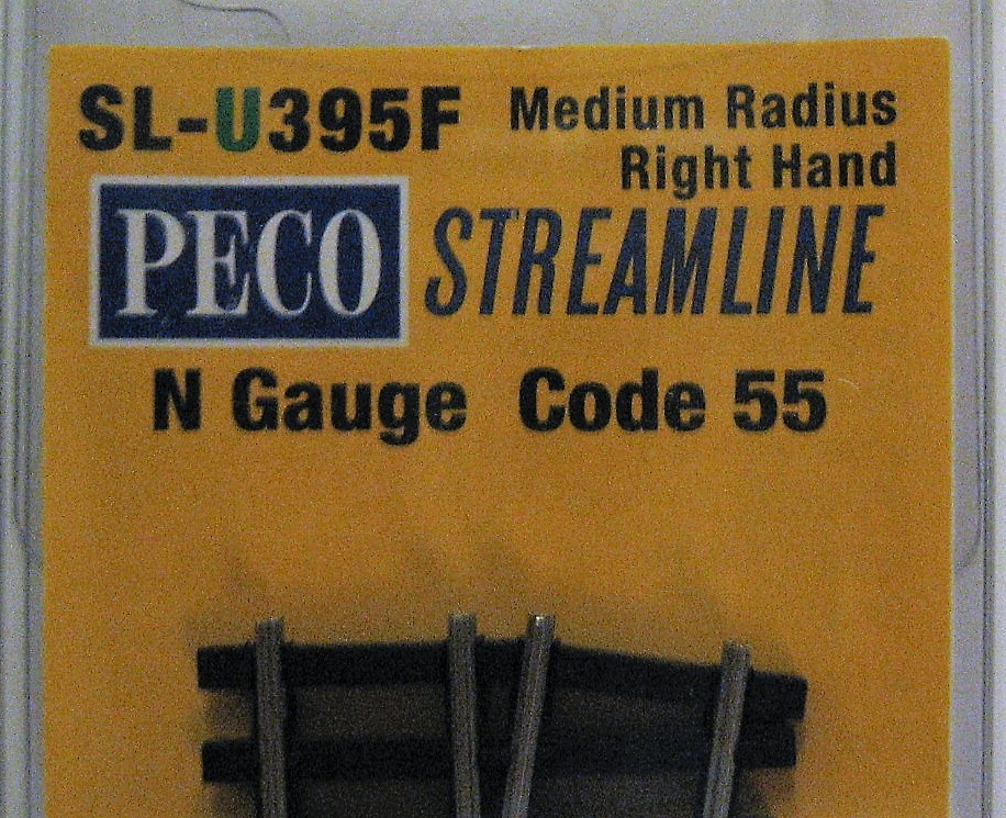

Incidentally Ted the reason you may be having trouble sourcing especially medium radius Electrofrog Code 55 is that Peco are changing to their new Unifrog design, and the medium radius are the first to change.  See specific threads on this.  To me they are replacing something which is so very simple and usable straight from its box to something which requires more complex wiring or alterations to its built in wiring to achieve the same effect.  I do not know if they will change code 80 as well.

395 and 396 have been replaced by a Unifrog design SL-UxxxF.   The old E models are getting hard to find, which is upsetting some folk as the Unifrog doesn't *quite* work the same electrically without modification (but that's a separate debate you'll also find on here).

The 'F' in the point names (e.g. SL-E391F) is for 'Finescale' = code 55. There is no such thing as Peco "code 55 flex" points. Code 55 comes as flexitrack in yard (or is it metre?) lengths and (rigid) points/crossings/slips (e.g. SL-E391F).
Streamline is code 80, so the "(streamline)" in your description is wrong and confusing.
Ideally I think you should stick to one type (e.g. code 55).
Neil
Quote from: NeilWhite on September 11, 2018, 08:38:52 PM
No, Streamline refers to both the code 80 and code 55 systems which include flexi, whilst Setrack refers to the fixed sectional track system.
