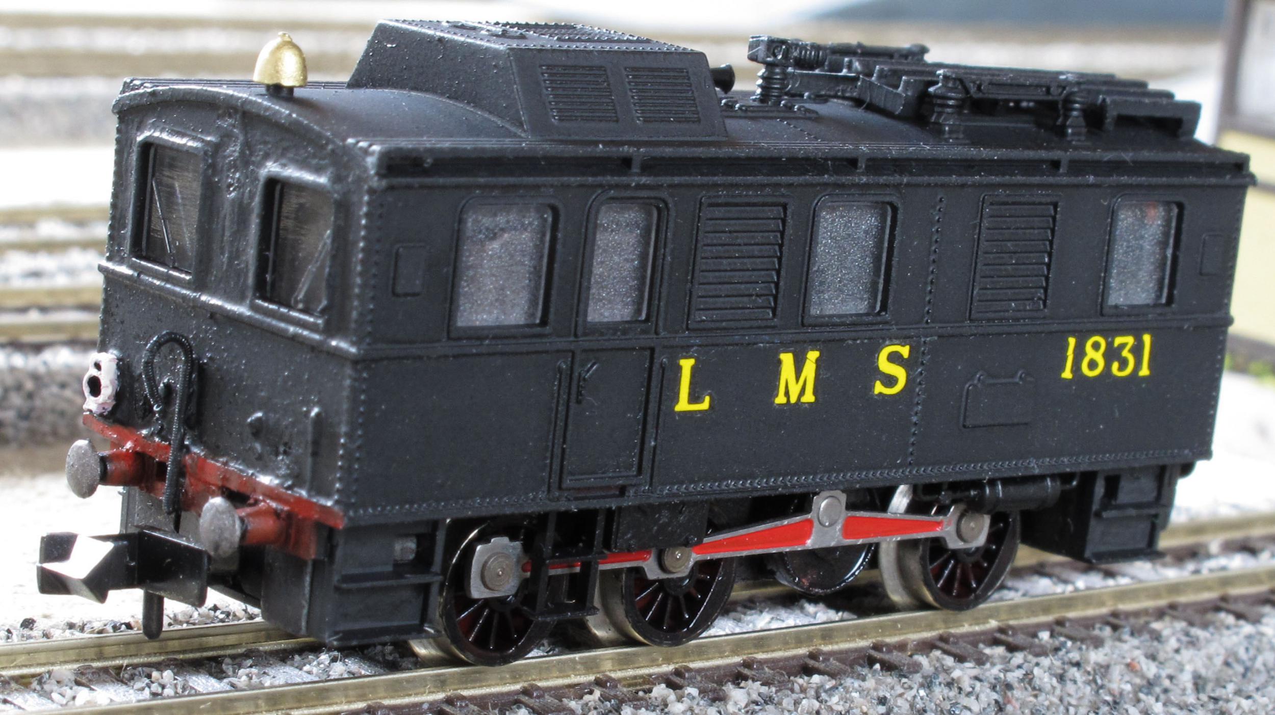

I beleive that the first mainline diesel shunter in Britain was 1831, built for the LMS. I produced one by a simple hack, little more than a repaint with addition of brass buffers, of a Fleishmann shunter (Cat. 7306).

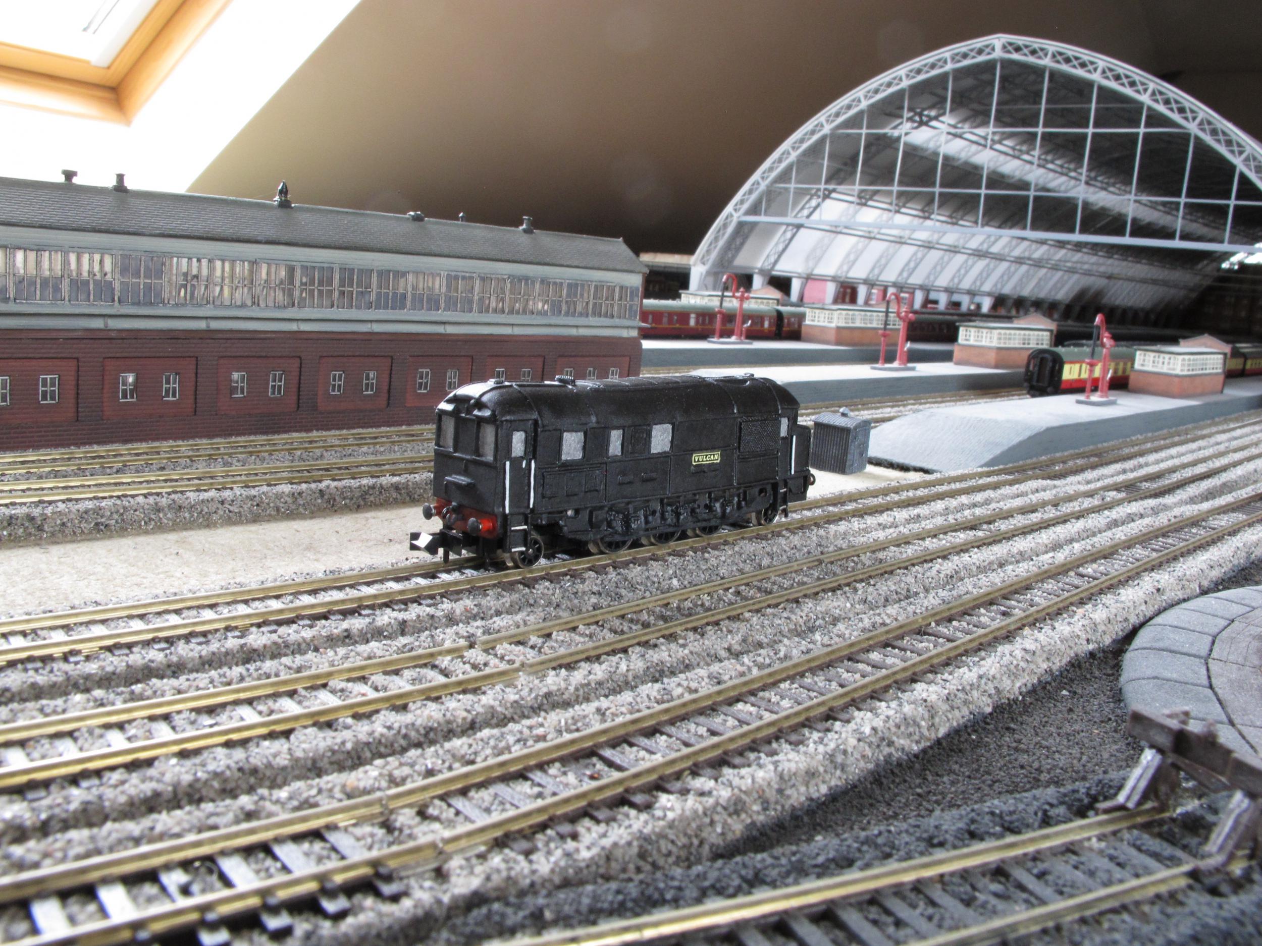

Armstrong-Whitworth produced a demonstration diesel which ran on the LNER. Parkwood recently released a body kit of this loco. I didn't like the blue livery and so have applied a plain black livery instead, which I think suits it rather well. Chassis and buffers are from the Minitrix 2-6-2T No.41234  - needed significant filing and sawing of its weights to fit within the resin body - attached to chassis by push fit with wood spacer.

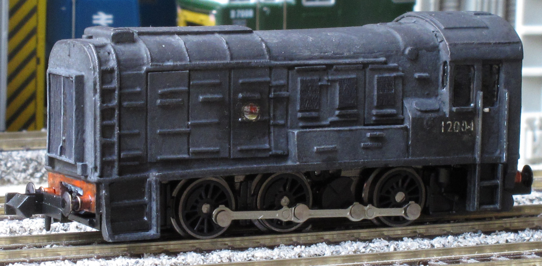

Parkwood produce various early generation shunter bodies. Here's one I've constructed. It was a simple body to prepare – removing a bit of flash, adding the buffers (N Brass) and then painting. It was supposed to be motorised using the chassis from a Minitrix V60 but instead I used the Hobbytrain Conrad DB BR 360 chassis which runs very sweetly.

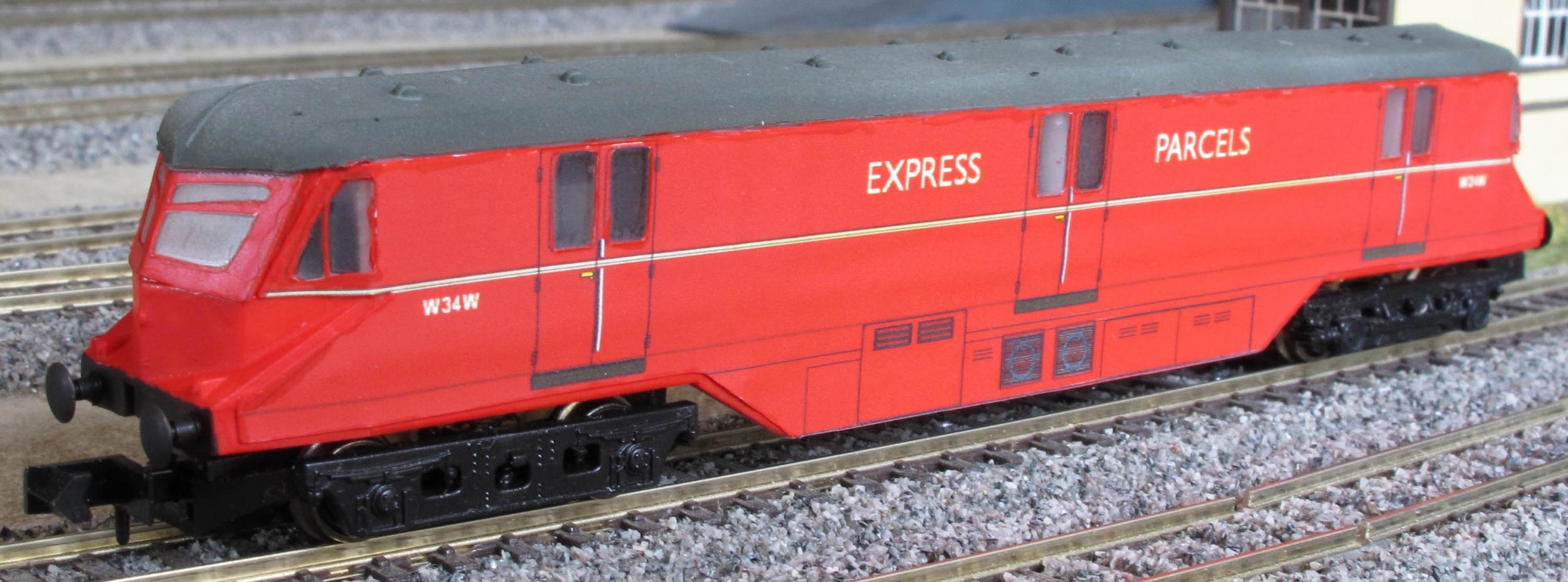

I have built an ex GWR parcels railcar using the ERG overlay, mine being in early BR livery. I think this is a really effective, and cheap, method of producing unusual stock.

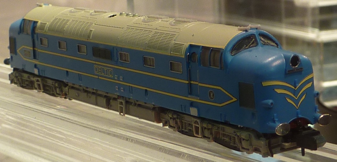

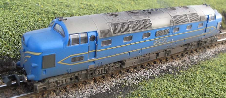

There are two DP1's, one in preserved livery and one as it ran initially. The primrose lining on the cantrail distinguishes between the two: this lining was worn in the 1950s but is missing from the preserved livery.

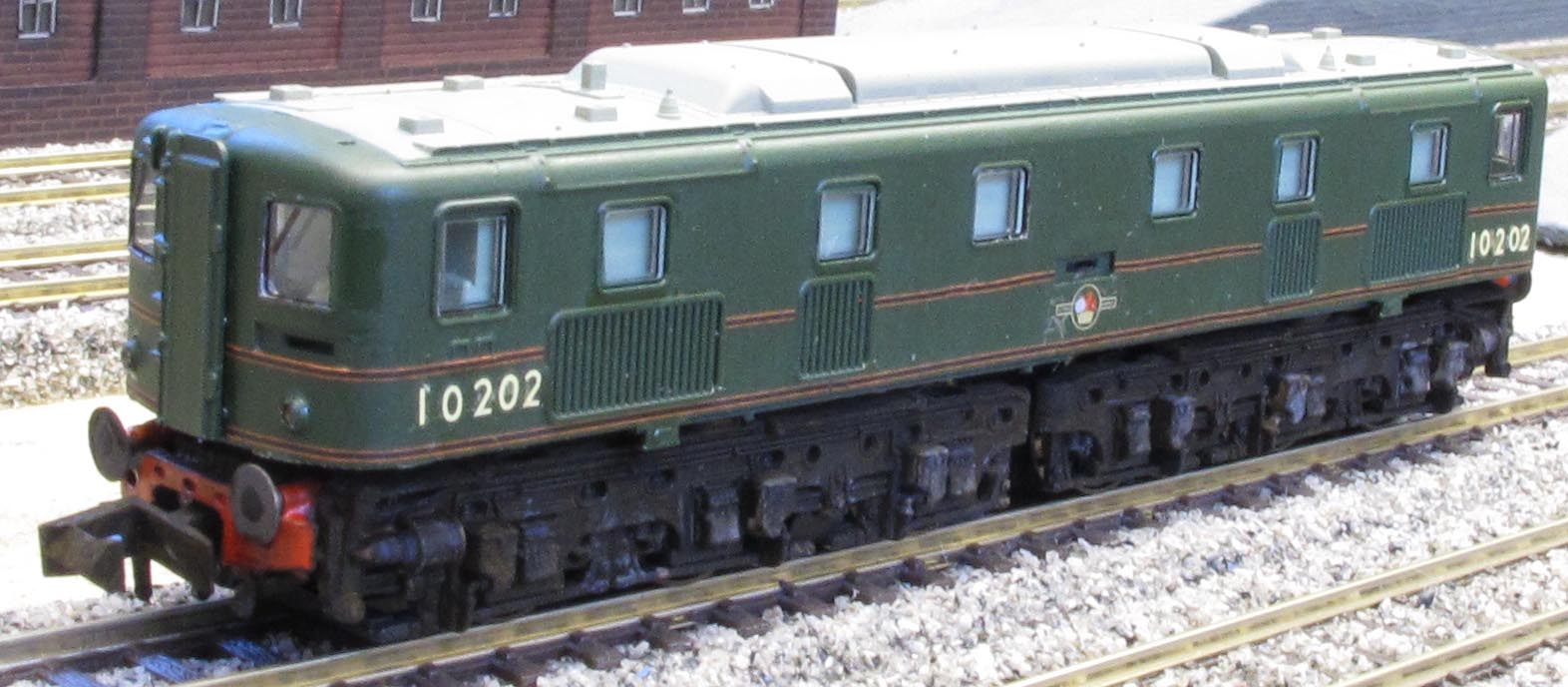

I am full of admiration  of the 10201 built by AndyRA. I have the body kit by Etched Pixels but have yet to summon the energy to build it!  Meanwhile I have made a representation using the Kato JR EF10 (Cat. 3077-1) as a base, removing the pantographs, reducing the bogie length (removing outer axle), adding buffers and adding corridor connections, and then repainting in BR green livery.

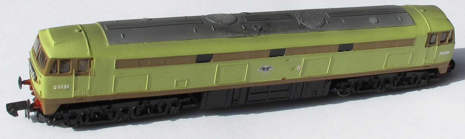

The Brush Class 53 prototype, Falcon, originally appeared in chestnut and lime green livery. Mine is a Britannia Pacific Models kit built by John Hazelton (owner of Silver Fox Models).

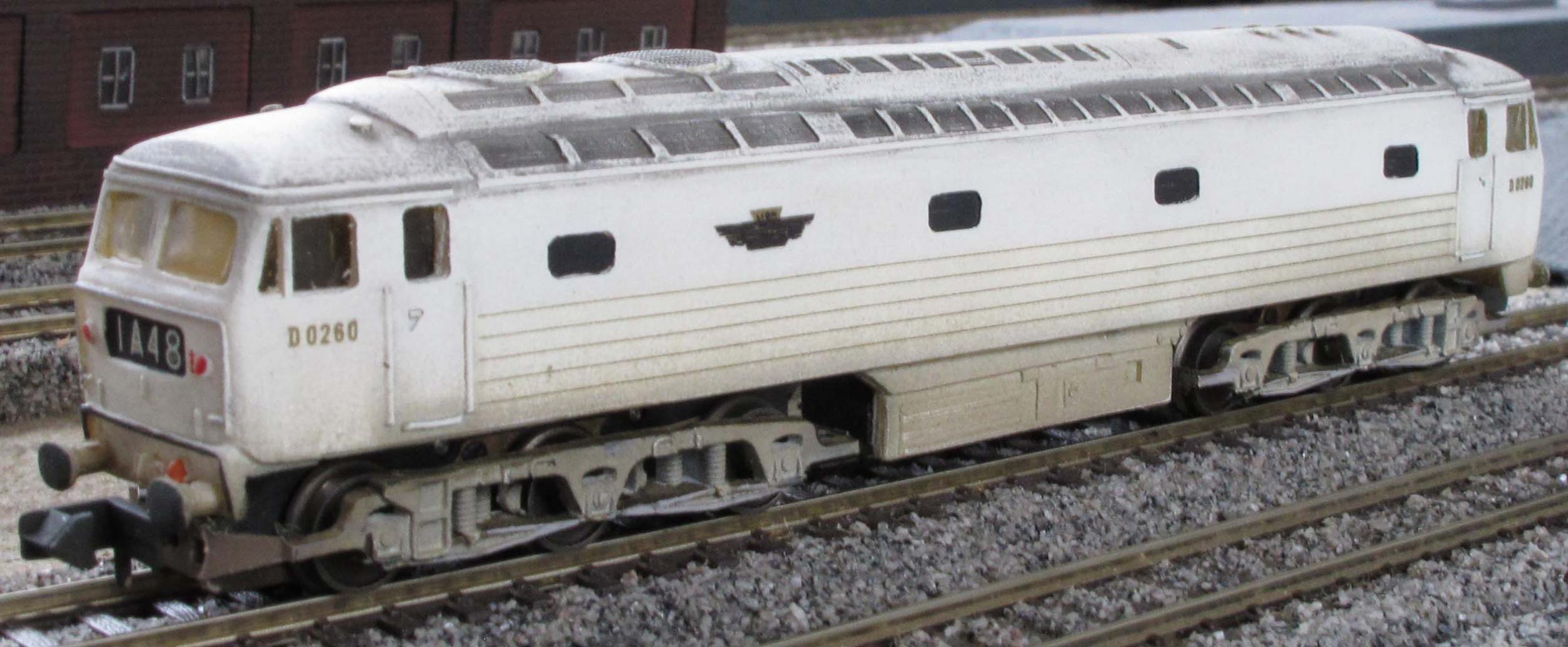

Somebody mentioned 'Lion'. My D0260 is a Britannia Pacific Models body on a Bachmann-Farish chassis with light weathering by CF Locos. After all, it surely didn't stay pure white for long!
