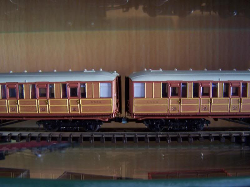

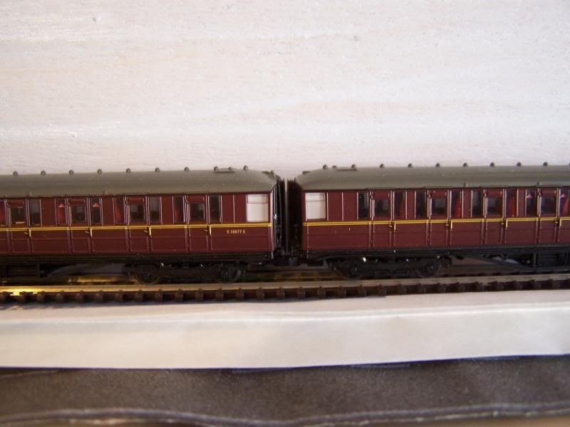

Dapol knuckle couplings are great for the connections between coaches.  I'm pretty sure you can even get away with two short couplings thanks to the close coupling mechanism on Gresley coaches.  Here are a couple of photos to show how the coupling distances compare with one short, one long and two short.
One short, one long:
Two short:
With the two short couplings the gangways practically touch.
