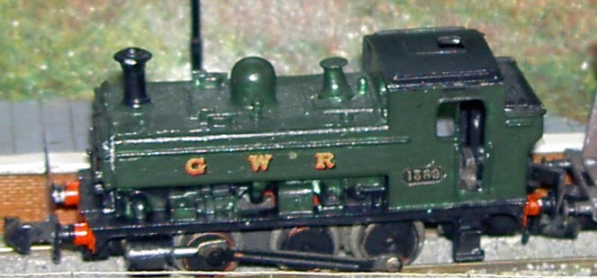

OK, this thread prompted me to get my camera out and take a quick n dirty pic of my MW as it stands now, a simple and very quick repaint is all it has had.  Runs well though, great pulling power!
Pictured together with a couple of other "timeless" engines..........I keep a few unliveried to allow use in any time period.

Alex
very nice looking engines there Dave. :thumbsup:

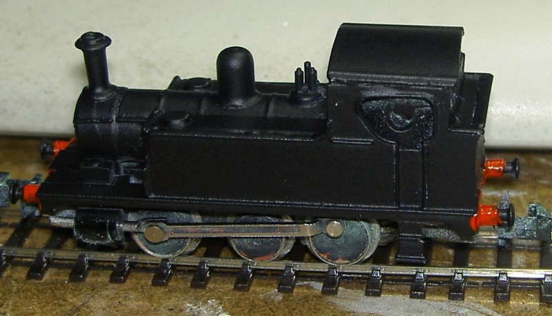

Midland "Deeley" 0-4-0T from a Fleichmann German origin loco.

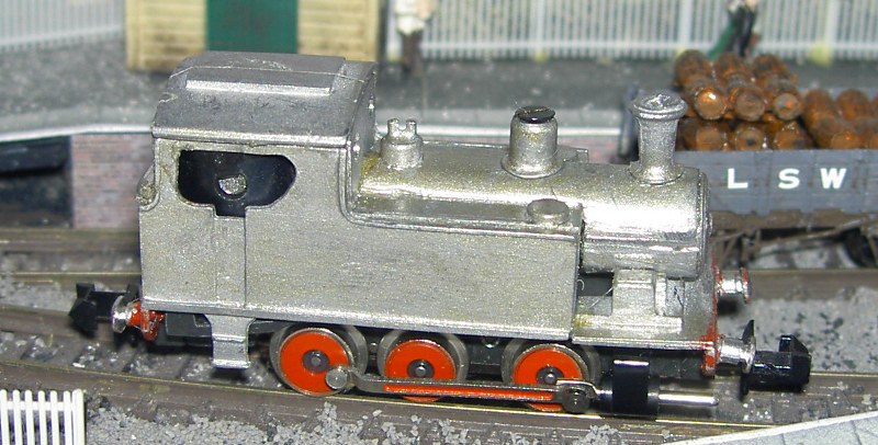

Peco B4 body in raw condition (sat on the same chassis as the MW, they swap in seconds)
North London Tank from a much hacked Fleichmann 2-6-0T chassis with an equally much hacked Shredded Wheat loco body. This is a particularly great little loco, far more pulling power than needed and a great resistance to dead-spotting due to the compensated chassis, even at a dead crawl.

EtchedPixels
Interesting NLR tank loco. Which chassis did you use - and did you not find the Fleischmann ones too wide for UK?

Quote from: EtchedPixels on February 21, 2013, 03:36:51 PM
Hey Paul A, you calling me a fibber??   :smiley-laughing:
Given the lack of available very small wheelbase/wheel diameter chassis, and the fact that I have many other time consuming interests totally disconnected with railways so don't have the time (or skills) to fully scratch build to scale, anything I do is always going to be a compromise to some degree, however, the chassis fitted the Shredded Wheat Tank framing and front end without any hassle.   Yes, I had to compromise true scale on the cab length due to motor length, but it looks the part to me, and I needed it for Cromford Wharf.
Yes, it IS a Fleischmann chassis, actually one that was being "outed" by its owner about 2001 as it was running like a kangeroo on steroids, I won't say how much it cost me as I don't remember accurately now, but I doubt it would buy some motor brushes today!   A quick dismantle, clean through, removal of most of the front end, painting (as it was a red chassis/wheels model, adjusting valve gear and compensation (which it gets from the tiop sprung pickups) and off it smoothly crawled over all Cromfords pointwork....and continues to do so.
I later bought a complete loco in case I needed to do another, same type but black chassis, Fleischmann Piccolo model No 7031.
