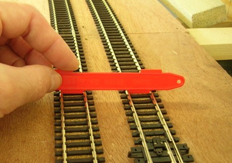

The lugs on the gauge sit in the track between the rails if you didn't know, as I didn't when I first saw one, like this  ;)
