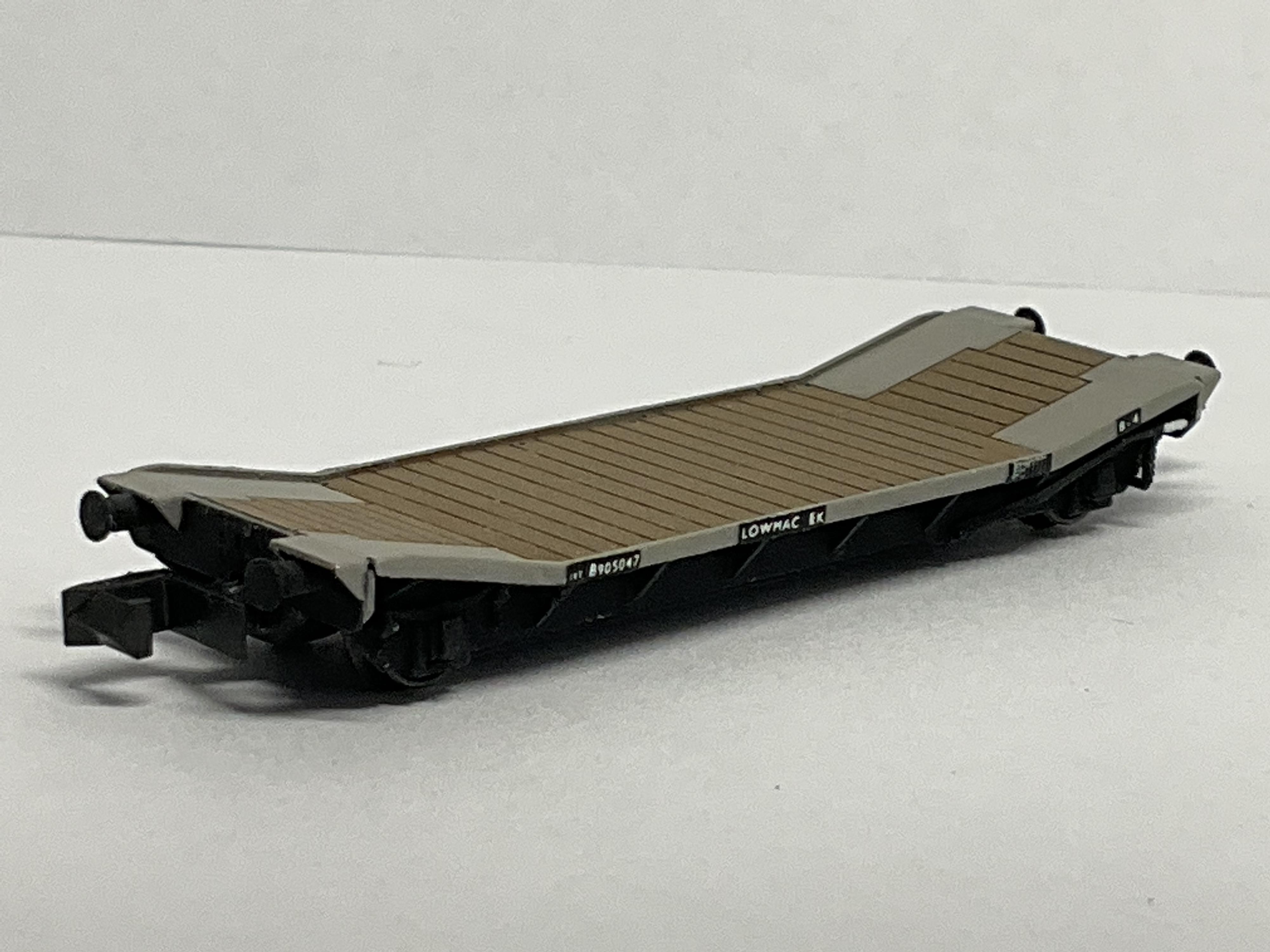

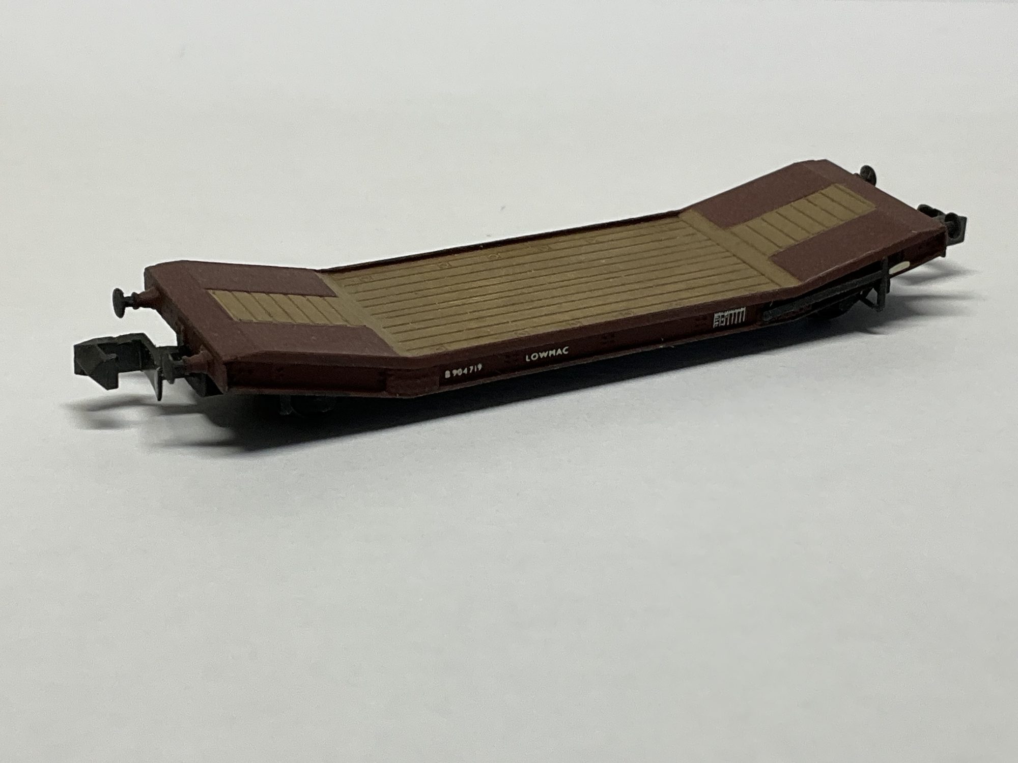

Hi
Having built both of those they are not too bad to do. You may have issues with finding suitable wheels though as the axle length needs to be 12.25mm.
Paul
Edit: having realised the pictures I'd posted originally were of the NGS kit and the 2mm SA kit I've now removed the NGS one and added the other 2mm SA one.
