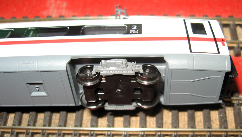

Quote from: ntpntpntp on February 17, 2024, 12:40:09 PMI have no interest in the Mk5 coaches, but with this talk of drag from internal bearings it's interesting to note that my Kato ICE 4 12-car set has internal bearings on some of the coach bogies (not all), and those coaches are perfectly acceptable free-running. Stub axles with live bearings ready to take light bars if desired.
We've come to expect nothing less from the technical team at Kato. I have been so impressed with the running quality of my Azuma sets, and fitting the interior lighting couldn't be simpler, a truly quality-centric manufacturer.
