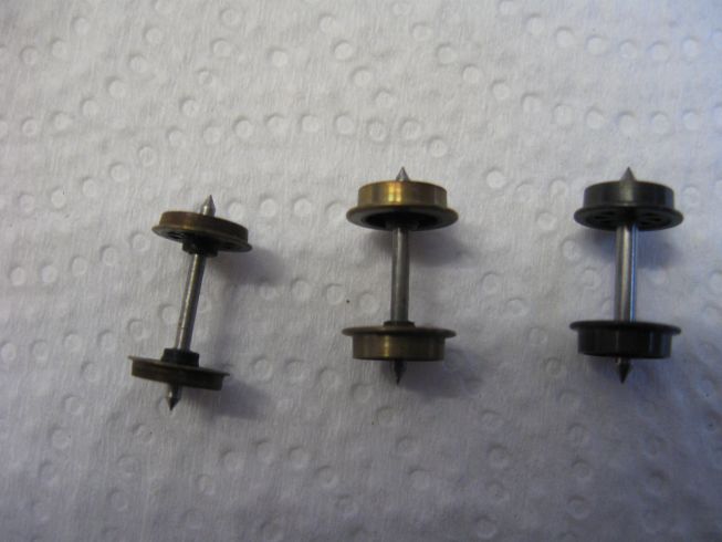

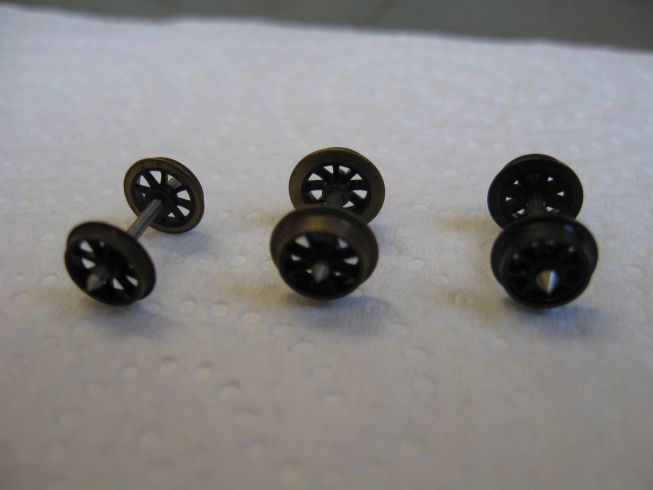

Ok. I went to the shed and measured and photographed some wheels.
From the left these are:
2mm wheels on 14.8mm axle for PECO
MBM (Mike Bryant, I think) N gauge wheels on 14.8mm axle
DMA8 ( This has to be either a 2mm or NGS part number) on 14.8mm axle
I think the 2mm wheel and the MBM wheel are made by the same supplier because of the similar wheel colouring and method of construction.
Another issue is that I am unsure whether 2mm wheels will work through N gauge point work. Maybe the flange is too narrow. Others here will advise on that.
Mark
