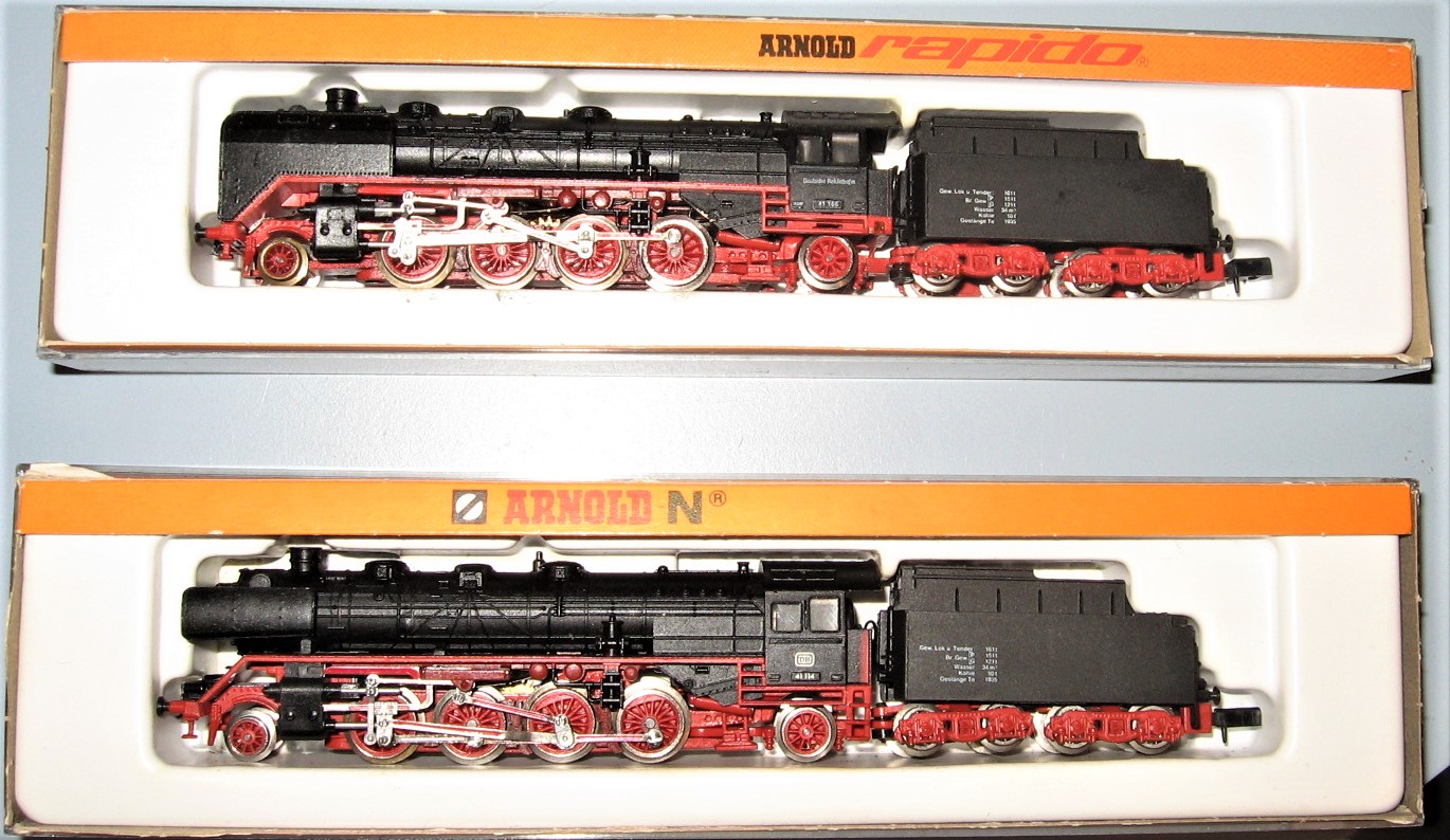

I have an Arnold #0251 (later #2511) BR 41 Reichsbahn loco with smoke generator.
Details and photos here:
https://www.spurweite-n.de/ncontent/ndb/ndb-artdetails.asp?ID=2738
I was wrong about my other one (lower), it's #2512 BR 41 DB and doesn't have smoke (but could have a generator fitted).

Factory fitted smoke.  Arnold were selling these way back in the early - mid 70s (mine has the old number #0251 dating from that time).
The smoke generator #7390 was a separate catalogue item and easy to upgrade into  #2512 if desired.
The models appear regularly on ebay.
