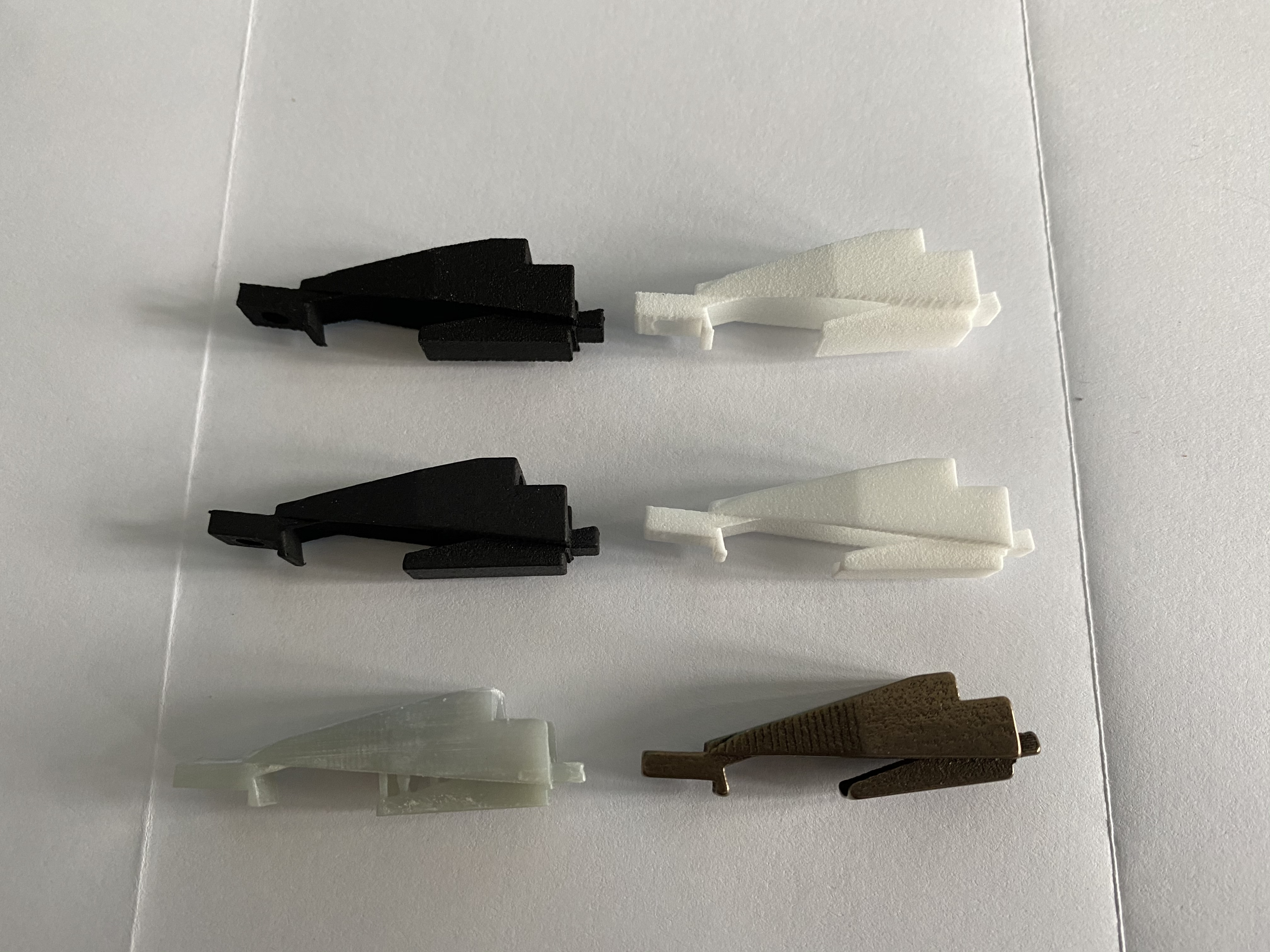

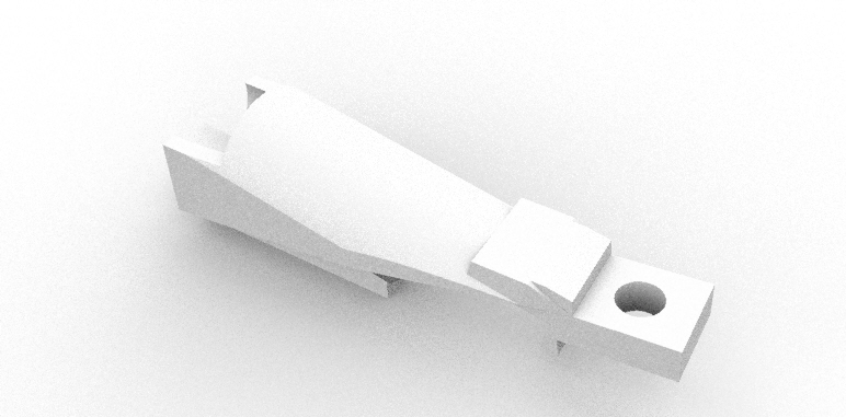

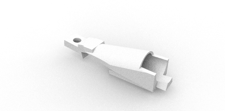

Snowwolflair
I have been removing material to make the motor mounting as small as is structurally stable.  I am still waiting for the material samples from Shapeways, however even in a brittle resin this new design is strong enough.  My guess the black polished nylon will be ideal.
