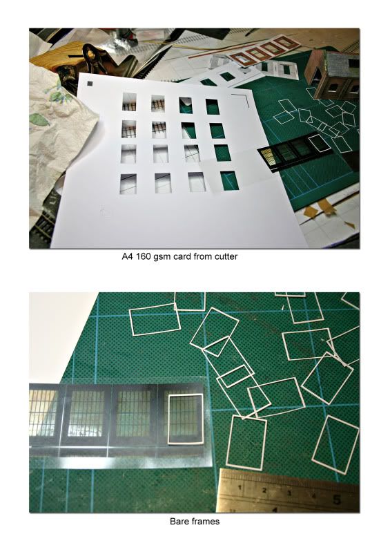

Discovered a benefit using the Silhouette Cameo today.
I use a laminate of 160gsm and 210gsm card to give me the heavy card for Scalescenes model,cut the parts out and glue two together to get approx one mm thickness.
I'm making the engine shed at the moment and there are a hundred oblongs of card to cut out to get the required thickness of four parts for the wall buttresses,shoved the A4 370gsm sheet through the cutter....ten minutes later I've got a hundred parts to laminate up,if I'd had to do it by hand I'd have been ages and a bit fed up and there would have been a variation in sizes as well.

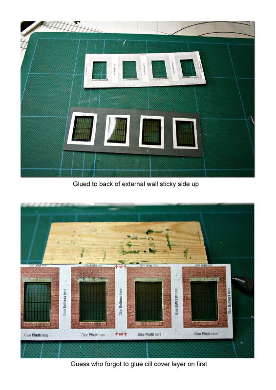

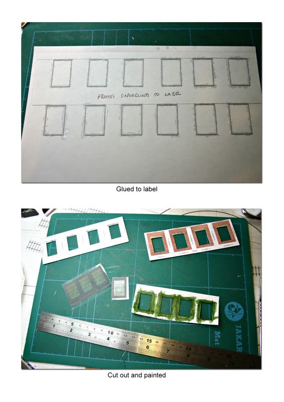

Something I've been playing,window frames with for the engine shed I'm building.
Allan
I'm not a complete idiot..some bits are missing.
