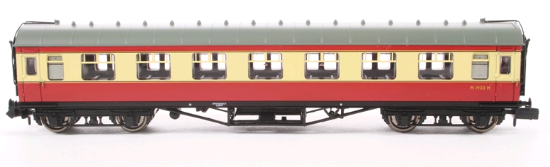

I have this set and was wondering what other coaches i should be getting to make it more of a prototypical length of train ? Not entirely sure what the coaches are that came with the set, tbh..
I'm a bit rubbish at knowing what i should be running. So if i wanted say a 7 coach train or longer, what else other coaches might there be in that train, preferably GF ones to match the ones that came with it which are  2 x Stanier BR Crimson & Cream coaches. Some pics might help  :) I'd be running as per end of steam/green diesel, era 5.

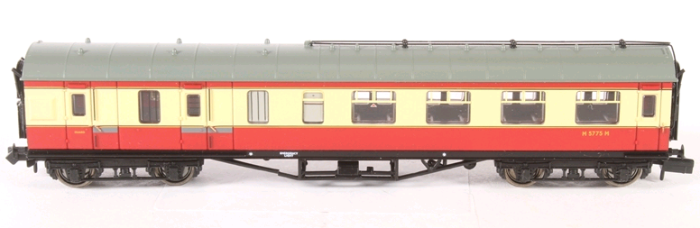

Coach with guards / Parcels area ? This would be at the rear of the train or would there be one at the front behind the engine as well ? or depending on length or train ? How many coaches would Dp1 normally be pulling anyway ?
Normal coach ? prior to mk1's ???

You have ex LMS Period 3 coaches (referred to as "Staniers" as he was the CME at the time of their introduction but how much input he had to the overall design is open to some debate...)
You have a Brake Third Corridor (BTK) and a Third Corridor (TK) type. The most likely make up of a train with those is more Staniers. Mixing with MK1s is possible but was avoided as much as they could due to differing gangway connections.
Yes - a train of any length would most likely have a brake vehicle at both ends, so another BTK for the other end is a good start. Also you are lacking any first class accommodation so at least one First class (FK) or Composite coach is the next priority. (unfortunately Farish only do 57ft length Staniers so we're missing the 60ft Corridor Composite (CK) - the most common type - almost every train had one! so we'll have to make do with the less common Open Composite). Some catering provision is a probability - The LMS only built a think 4 Period 3 Buffets and they're not available RTR so a Mk 1 Buffet is next best. Then really more of the same TKs/FKs to suit the total length you want...
