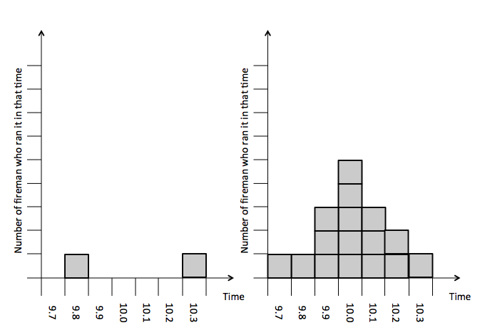

In terms of sampling, assuming a bell-shaped distribution, you would simply time one fireman after another, with time to run the distances on the x-axis, and number of fireman running a given time on the y-axis. Initially you'd have only a few results and the bell shape wouldn't be apparent, but as you add more and more results, eventually the bell will become obvious. That's when your sampling is sufficient. The image below suggests what this might look like, initially with too few data points (only two fireman) but the second with many more, and a bell shape starting to form:
I don't think, a priori, you can guess the perfect sample size, though I dare say there is some maths out there to determine one. But if you sampled 10%, say, 18-20 fireman, picked completely at random, and had them run the distance, I think that would be a justifiable start. If the pattern still isn't clear, then another 10%, so the sample size is now 20%.
