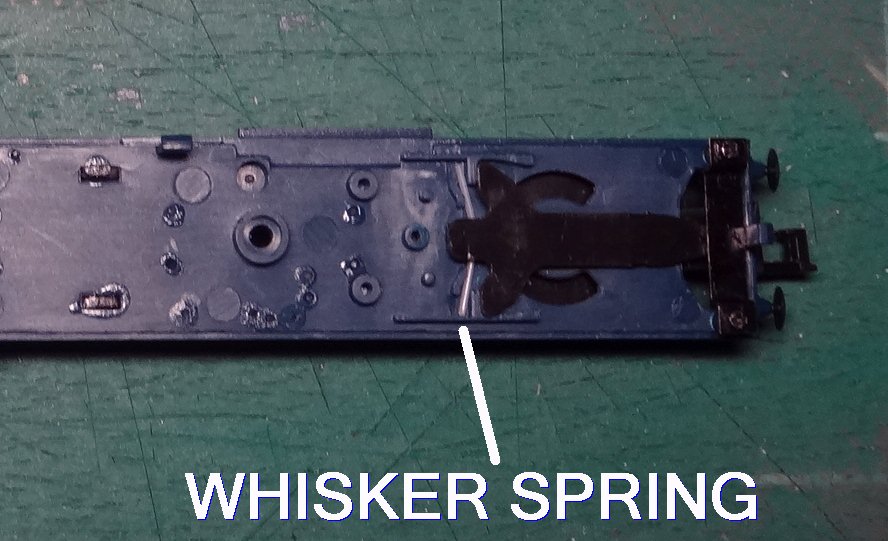

The worst problem I've had wth KKs is the pesky spring wire going AWOL if the coach is dismantled (usually unintentionally via a trip to the floor!) Not so long ago I bought about a metre of spring steel wire to cut and make my own replacements as-and-when needed.

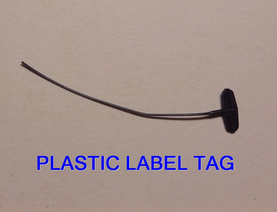

I found that a suitable spring replacement was a section of those plastic tags that hold the price labels on to clothes.
