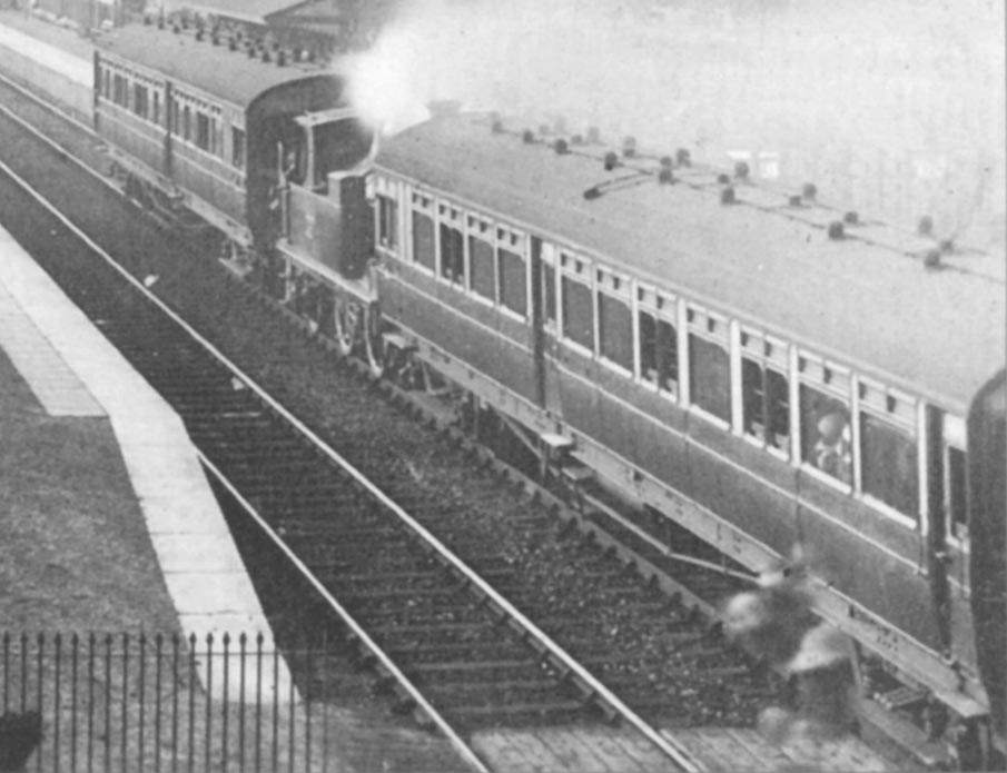

Mostly 14xx 0-4-2, pannier tank 0-6-0 and most small prairie tanks 2-6-2. Don't know enough to tell you which individual loco's are push/pull fitted. I've got a photo somewhere of two auto coaches sandwiching a 14xx. apparently common on busier branches.

cheers guys. so if im correct you can have one infront and one at the rear of a loco. thats cool.
EtchedPixels
Yes.. there were also some coaches fitted for through connecting of the control rods and wires so if you look around some formations went up to four vehicles with a loco in the middle.
The other oddity was mixed trains. Sometimes auto-trains also carried bits of freight (a van or two). If the autocoach was leading the vans went behind the loco, if the loco was leading the vans went behind the autocoach.
The loco/autocoach would also often stay together when doing things like shunting those vans or getting water. Connecting all the controls up took a while so they tended to stay together.
The Dapol one is a GWR build autocoach to a fairly standard Swindon style. Construction continued with some style changes (eg window design) into the 1950s. DMUs then replaced these services.

Quote from: KRIS-537 on December 08, 2011, 01:32:38 PM
Supposedly when they used 2 autocoaches the control wires would tend to get a bit sloppy if they were connected through 2 coaches to the engine, so they found it worked better if you just stuck one coach either side of the engine (thus reducing it to a max of 1 coach length for each set of controls).

The locos that were fitted for auto working are the 48xx/14xx tanks (RTR from Dapol) and certain members of the 4575 class of small prairie tanks. About a dozen of these were converted for the Cardiff valley services in the early 1950s so are not suitable if you are running a pre-nationalisation layout.
I can post a list of the converted small Praires if you would like.
The 5400 and 6400 classes of pannier tank were auto-fitted but these are not available either RTR or in kit and they are quite a different shape to the Farish panniers so scratch-building would be your only option.
