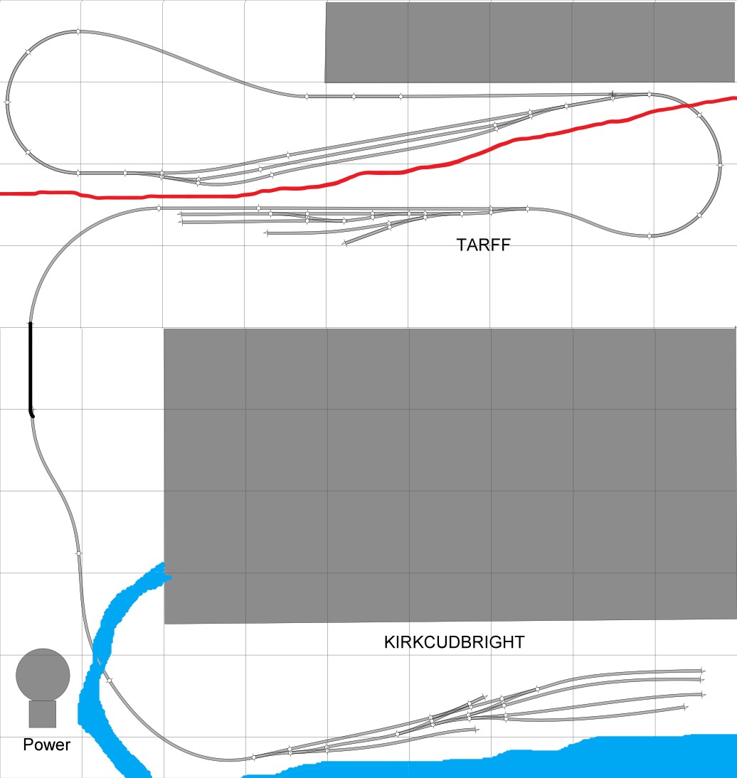

I'm just finalising how & where the bus will be connected but have read that a star config is better than a long straight cable hence I'll be planning to cross connect the two boards at the same end that they are connected to the DCC power supply and run parallel lines.
Temporary track will be laid on the rear board (just a broad, wide U- shape really, top half of the image below) then not move it again whilst I fully lay the front board (lower, goods yard).
I'll then switch the fully formed board at the front around to the rear and complete the second board (currently planned as a station) or maybe switch to extending the layout right across the room, depending on how I'm feeling at the time. I love flexibility and that's why I'm going down the modular route.... also it's ergonomically friendly to be swearing-whilst-sitting-comfortably rather than swearing-crouched-under-a-baseboard!

ps Just in case you've not seen - the current plan is to extend right across the attic with further identically sized boards (blue) and build in a reversing section disguised as a station (red). Maybe not though, based on my experience one always wants to try new things and is never quite satisfied with the current layout. Plan C or D is to extend the red portion over the blue and right out of the back part of the attic into the front on a further 3m run... which is where my wife will one day have an office. Or so she hopes. >:D

Good plans, i like the concept of expanding when money, time and spousal permission is granted.
Star is better than long single run, will make it easier to modify as it grows and easier to split the arms of the star into separate DCC districts so you can spot errors quickly and not lose all DCC running on a short circuit.
