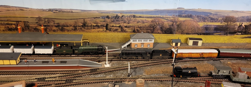

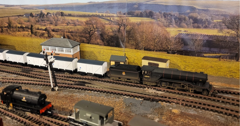

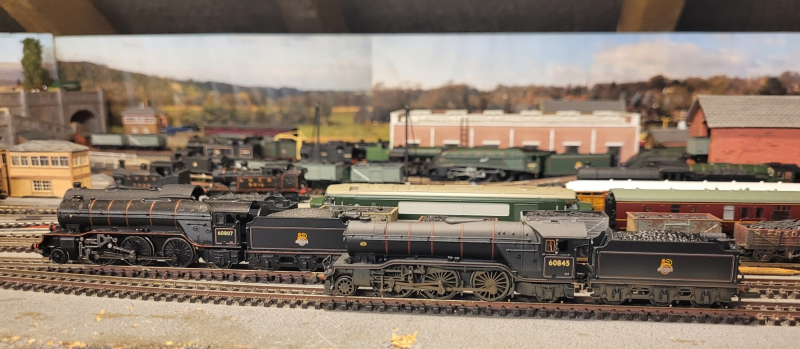

Hailstone
I ordered a black V2 60845 weathered by Rails and it arrived yesterday. my first impression was that it is light years ahead of its rather dissapointing predecessor
after an hours running in, I gave it a 20 wagon fish train to see what it was like on a load and it walked away with it (I will have to try a heavier van train that usually finds out the poorer haulers)
Finally, I put it on a passenger train, the leading coach having been aquired from @Pedanticmongrel which arrived the same day (a beautiful job Dan) with Green arrow on the fish vans heading in the opposite direction.
I look forward to the arrival of 60964 "The Durham Light Infantry" after which, the 2 existing V2's may be sent abroad for further use. 60845 has since been fitted with the cab doors, a crew and real coal in the tender
Regards,
Alex

Ensign Elliott
Quote from: Hailstone on Today at 12:44:46 AMI ordered a black V2 60845 weathered by Rails and it arrived yesterday. my first impression was that it is light years ahead of its rather dissapointing predecessor
Thanks for the pics. Interesting to compare it to its predecessor. I'm looking forward to getting a lined green one.
Out of interest, is that the Rail of Sheffield £29.95 "Advanced Weathering" option you've had on your V2 Alex?
