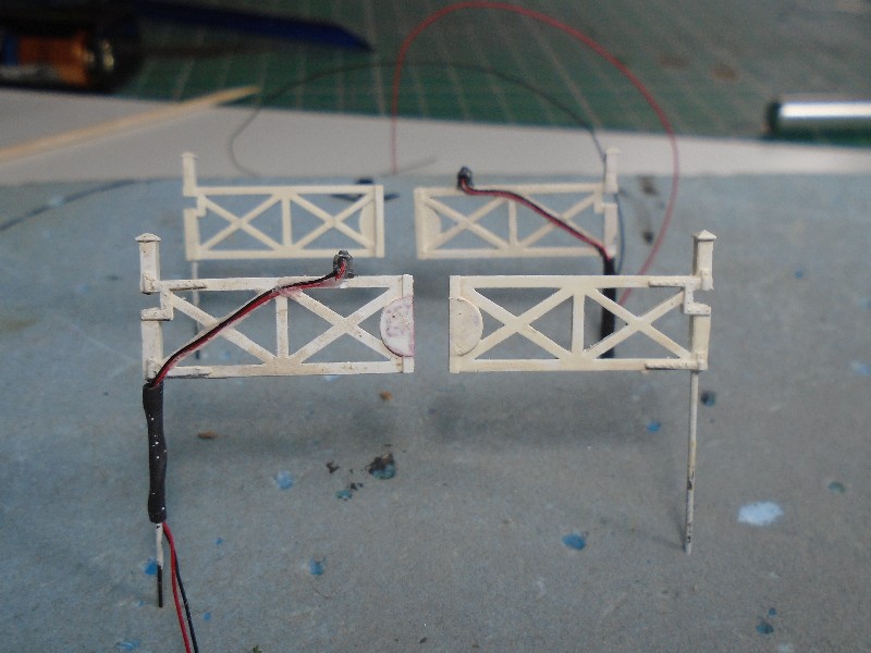

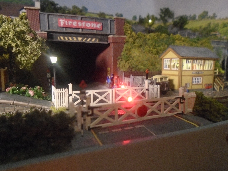

The tutorial by Kirky is excellent. There is also one by Caz, but I had a look and could not find it.
I have used LEDs and fibre optics for projects with tiny lights, and the actual molded lamp was on the peco level crossing gates.
I used a tiny LED from https://www.railroomelectronics.co.uk/
With careful drilling the LED will fit in the lamp
The full tutorial is here
 https://www.ngaugeforum.co.uk/SMFN/index.php?topic=45048.msg564457#msg564457
I don't see why this would not work on a tail light. :hmmm:

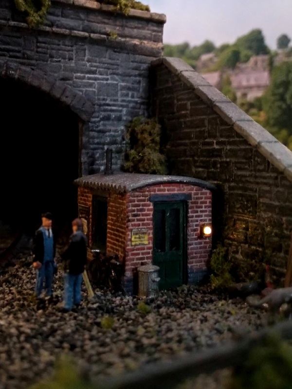

Alternatively you could use the molded lamp with a fibre optic running to it, which I did for this little hut ....
A bigger LED with a resistor added was in the hut, and a short length of fibre optic went to the lamp.
Just for that little length I had to buy 7m of fibre optic :doh: so have loads to spare. I would be very happy to pop some in the post to you if you go down this route  :D
