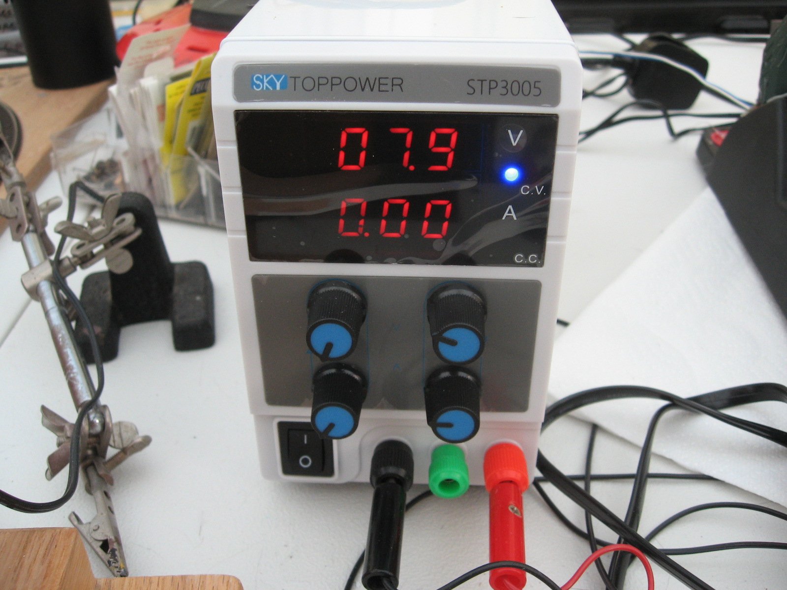

You just need a reasonable DC controller, preferably pure DC.    Loads of them on ebay, for example Bachmann or Hornby items ex train sets which may not be top quality but will do the job. Just keep in mind that depending on how they are powered, some of those cheap units can go quite a bit higher than 12V when fully turned up, so use with a voltmeter I suggest.
Many many years ago I took the original wire-wound rheostat out of an old H&M Clipper and fitted a Gaugemaster 100 Panel mount controller. It works very well for this purpose and as an emergency spare for my layout.
Certainly not a cheap option, but if you're serious about electronics etc. then I would recommend having a bench power supply with meters, which also doubles as an excellent accurate DC controller and you can see the voltage and current usage of the loco - very useful! This is what I now use for bench testing. I have a cross-wired DPDT switch for easy direction swapping.  This one was £55 but I use it for all my electronics development etc. as well.
