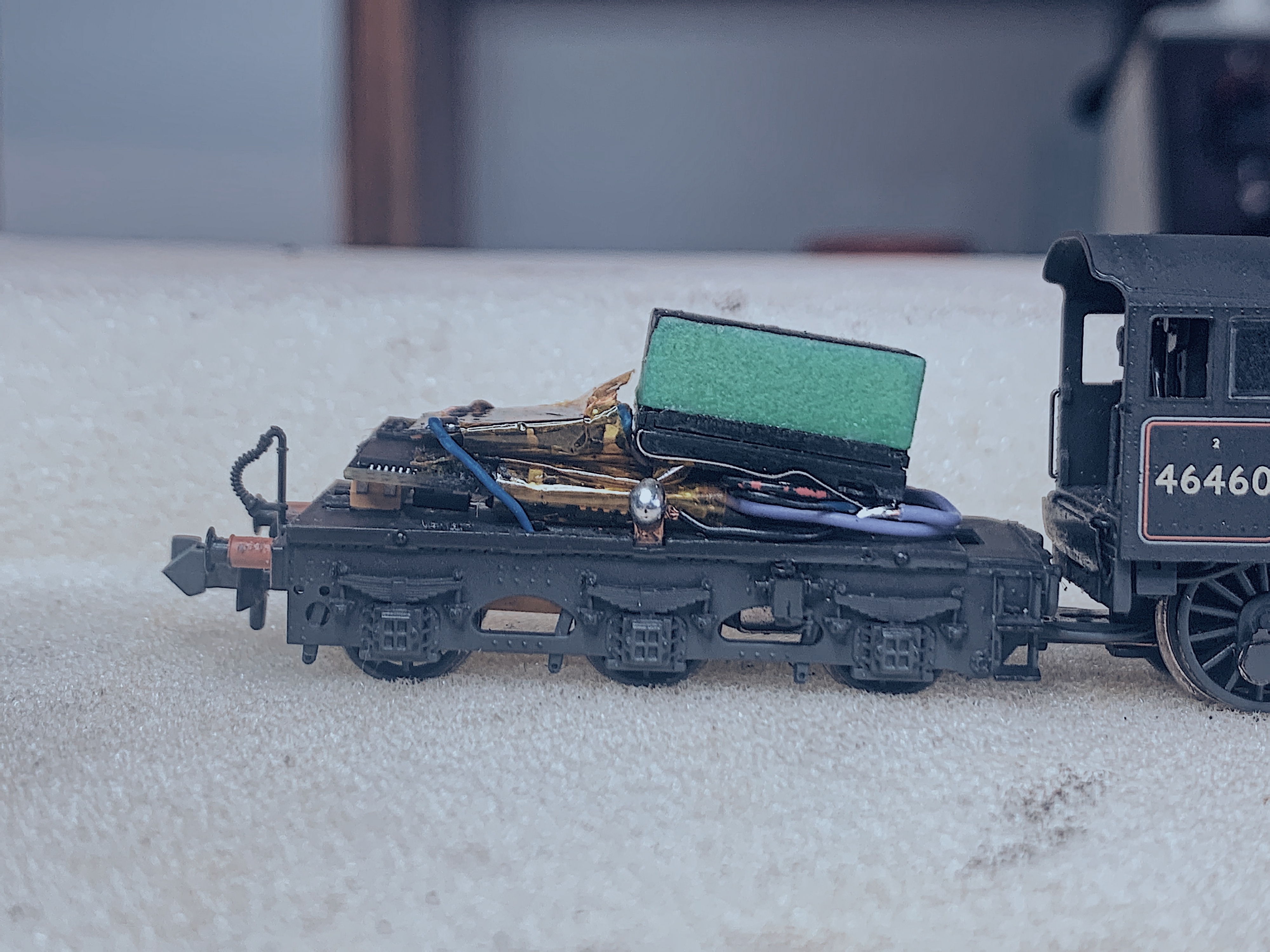

Space is tight on this model but everything fits fine in the end. The decoder sits towards the back of the tender with the SACC16 board on top.

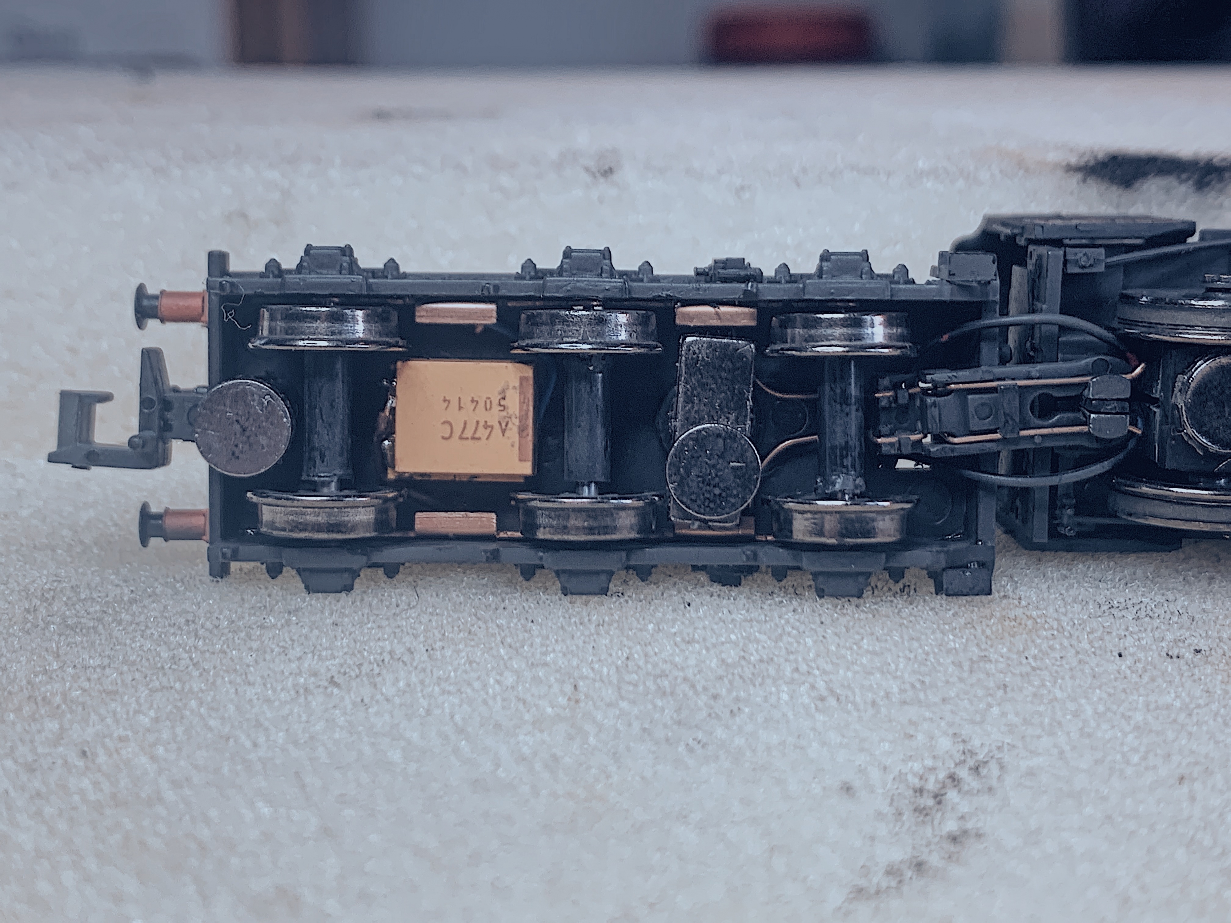

I soldered two capacitors together as tightly as I could. I drilled two small holes either side in the tender chassis to connect to the capacitors. (2x flat 470uf tantalum capacitors) I had to remove the plastic detailing in between the wheels to locate these. The moulded detail here serves no purpose as it’s underneath the tender and not really visible. A blob of black tac allowed me to locate it so none of the wheels or axles touch and create drag. Then I used a tiny bit of superglue once happy.

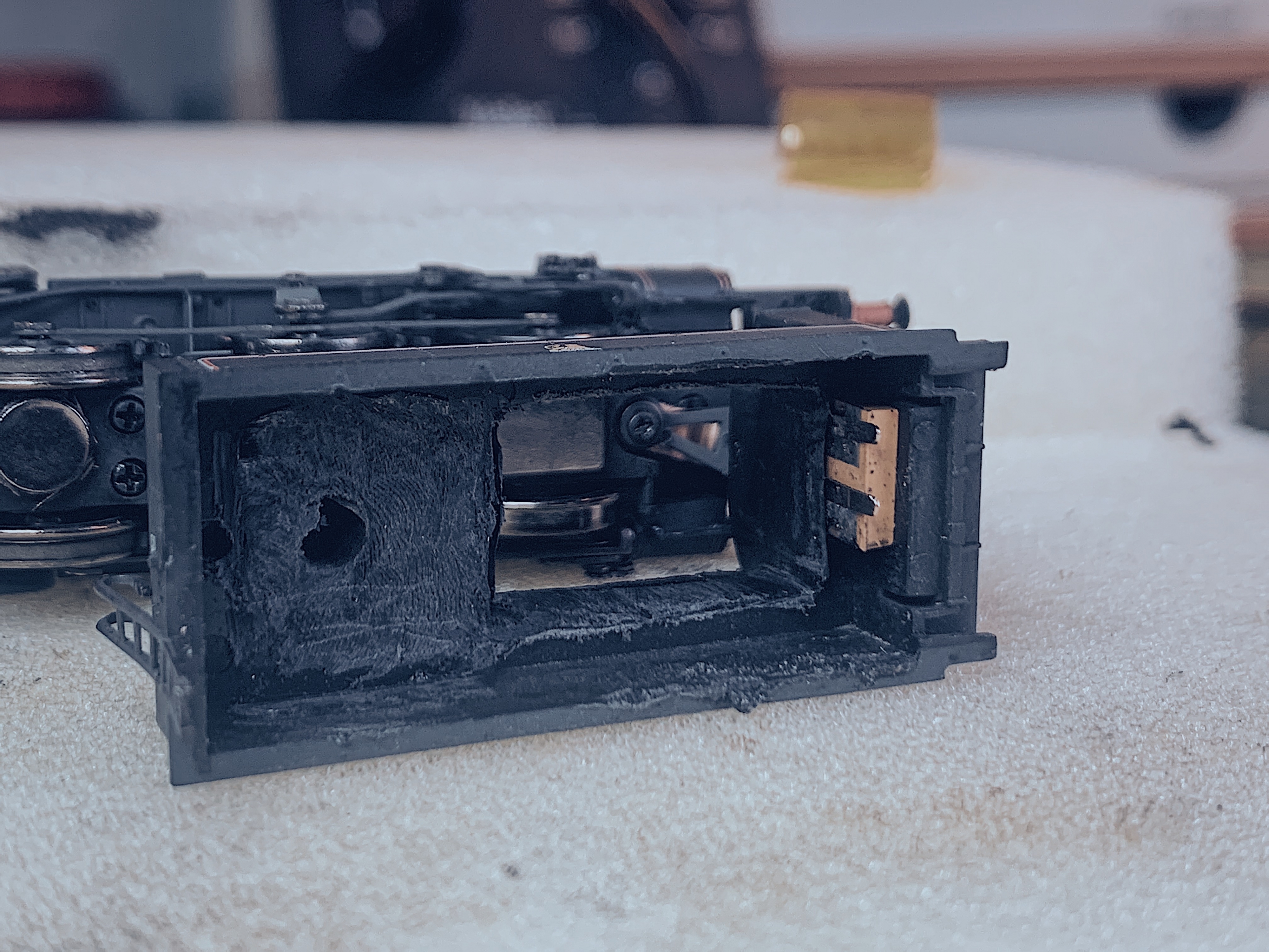

A third 470uf capacitors seemed to fit nicely in this crevice. In order to get the speaker to fit, I had to mill down some of the “thickness” of the coal area sides. It goes through nicely after this and no compromise to the model.
Finally, to shorten the tender gap is super easy and took 5 minutes. Just cut some clearance away from the inside of the drawbar, cut the plastic end shorter and the brass wires - then simply bend the brass wires around the pickup bar. Very effective.

The picture above of the capacitors on the underside of the tender shows the drawbar etc before I had modified the gap to be shorter. I will upload a clear pic of the modification when I get a chance to take it. Just a case of cutting it shorter, can’t really go wrong!

Very nice. Please elaborate on how you shortened the tender gap. I assume you moved the drawbar pivot point on the tender?
Here you go. Pics should show what I mean. I have pinched the wires to kind of pull the tender closer as well, and keep it there but with some ‘give’ that wires naturally have.
