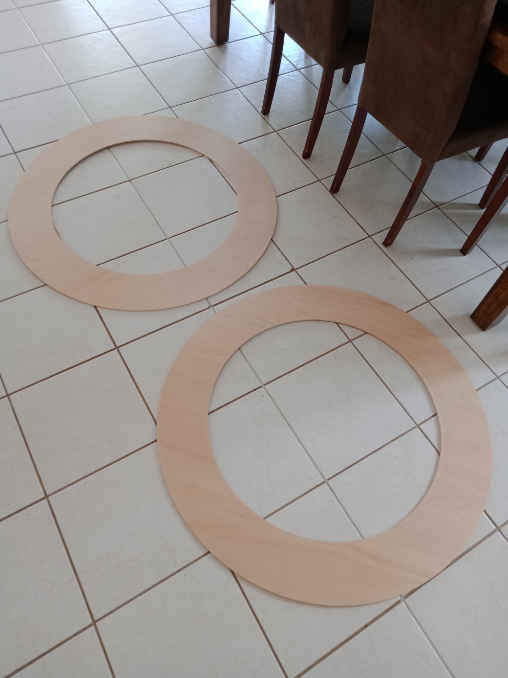

What's unique about this layout? Well, for a start, it is built on a pair of "donut" baseboards:
Alright, so while that might be "different", it doesn't make for an interesting layout, does it?

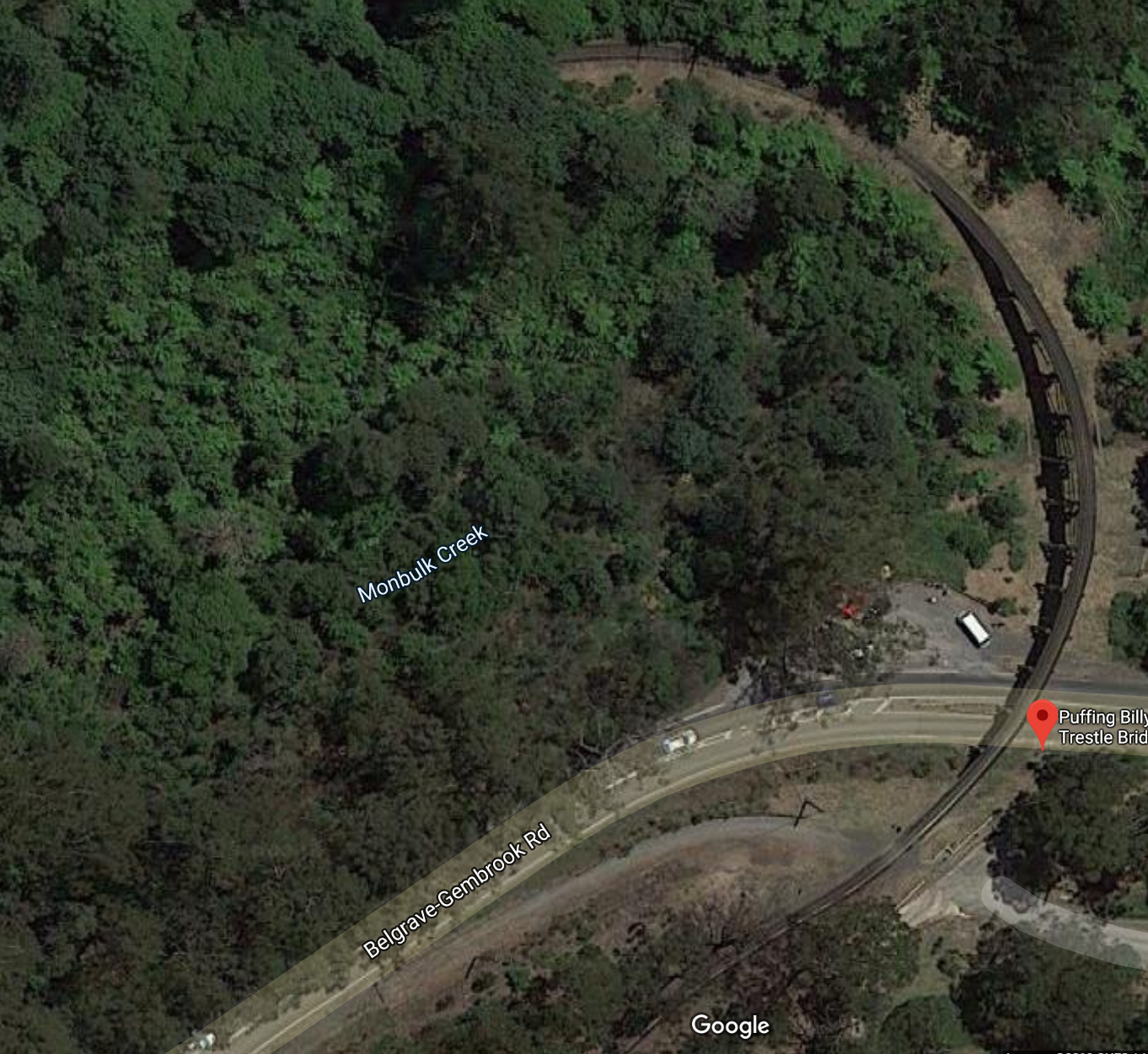

And from Google Earth, it becomes clear why this layout is suited for these "donut" baseboards:

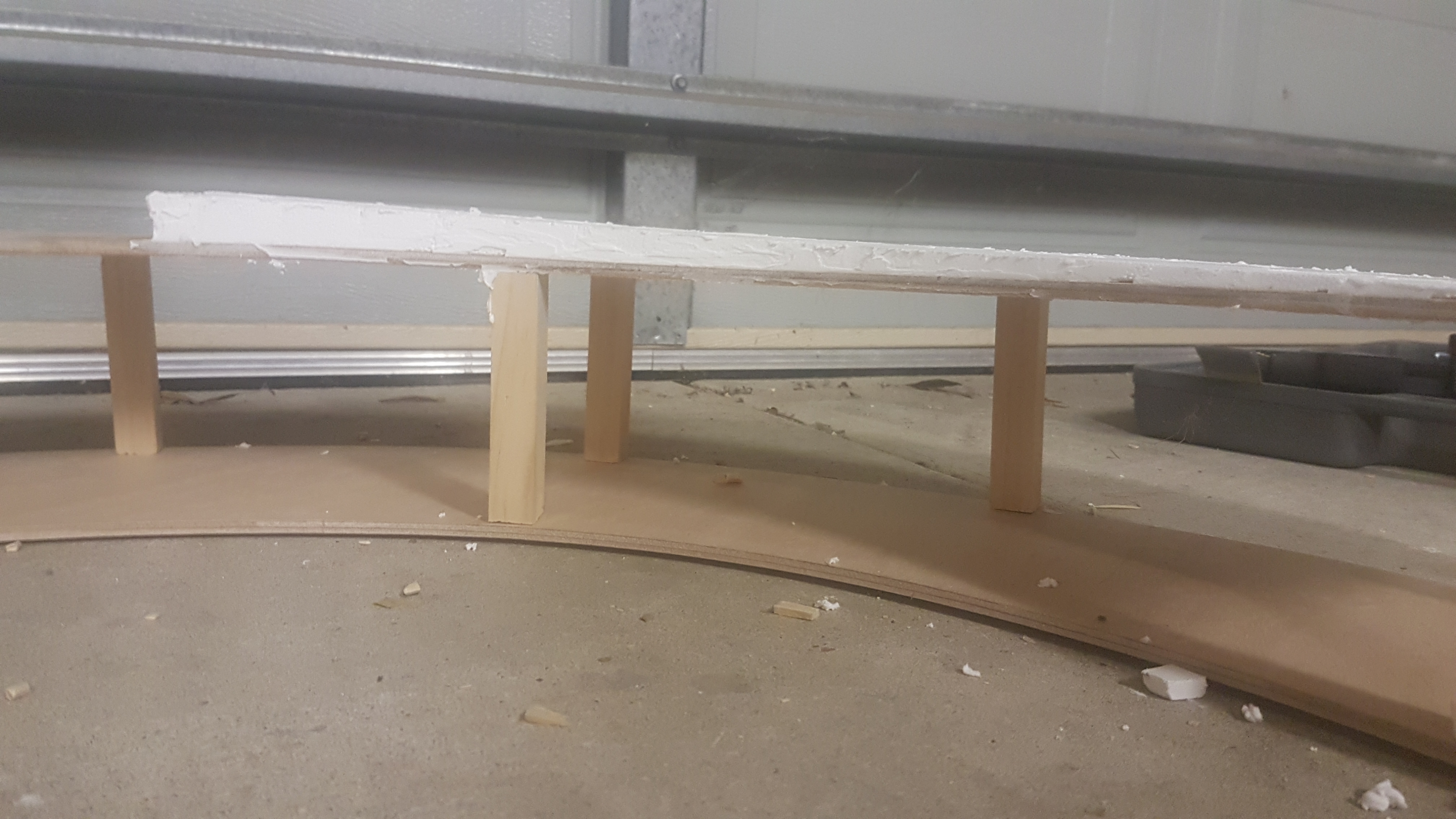

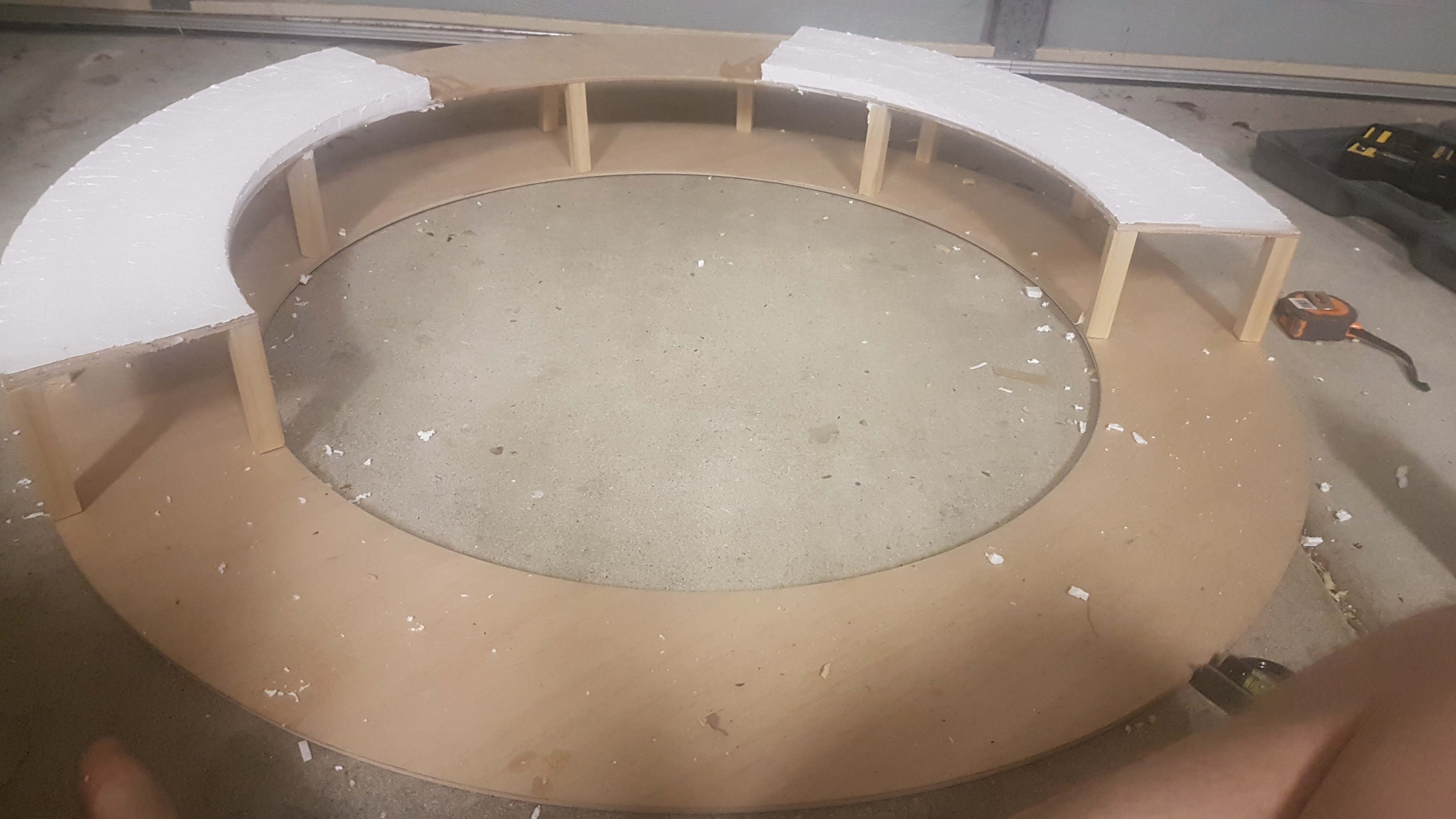

So far, I have built the baseboards into two layers, representing the upper running track of the train and the lower ground level that falls away under the trestle bridge. On the upper level I have additionally installed some inclines to add some interest to this "non-focal" area of the layout.

From the start above, where I had cut the baseboards and laid the gradient ramps, I have added further foam to connect between these two ramps on the upper level and foam blocks to be shaped into the gradient and land form under the bridge on the lower level.
Note that in the above photo, the foam on the upper level has been painted and there are marks from an aborted attempt at laying some underlay foam for the track.
It can also be seen that ply sheet has been curved around the inside aspect of the donut and slopes up to match the gradient of the foam surface on the upper layer. Care has also been taken to sure the alignment of this curved sheet with the inner aspect of the donut is neat and presentable.
The timber on the inner and outer aspects of the donut over the portion of the layout where the curved trestle bridge will reside have additionally been cut to create an inundating land form reflective of the prototype.
