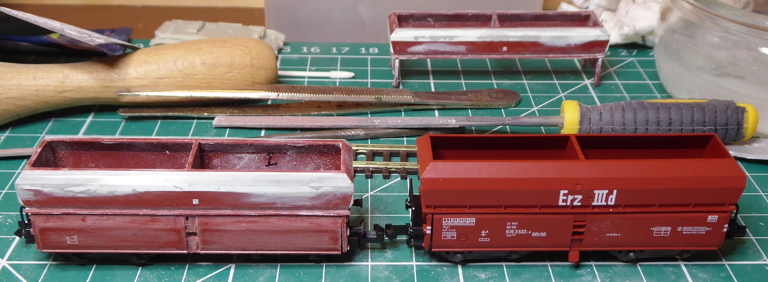

I think I've solved the issue of the side doors being flat, and should be profiled.
I've chamfered the top edge of the doors, thinned the side 'legs' by the doors so they can tuck in a little closer to the chassis. The alloy chassis of these wagons has been narrowed by about 2mm to allow this movement. With the Fleischmann bogies this would restrict the minimum radii too much, but with the diamond pattern bogies the radii is still adequate to cope with at least 10" curves.
So it's a little bit of modification with a little bit of optical illusion. The doors are still predominantly flat, but now look like they have a curved profile.
It's difficult to see in the following picture, but it gives a bit of a idea of the shape change of the top hopper.

Seriously looking good mike. I take it they handle curves and points without the risk of couplings becoming detached and fouling / buffer locking ? Chris
