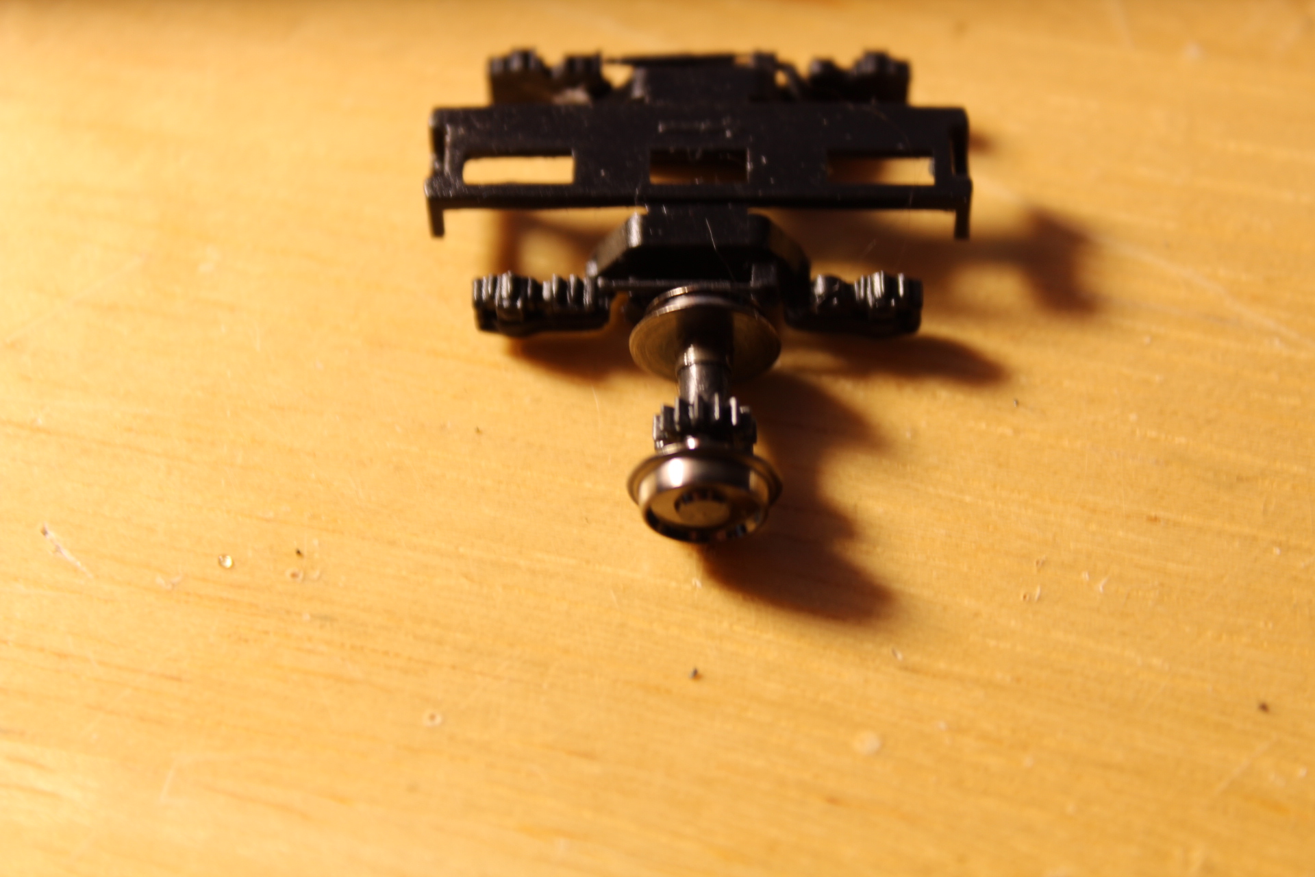

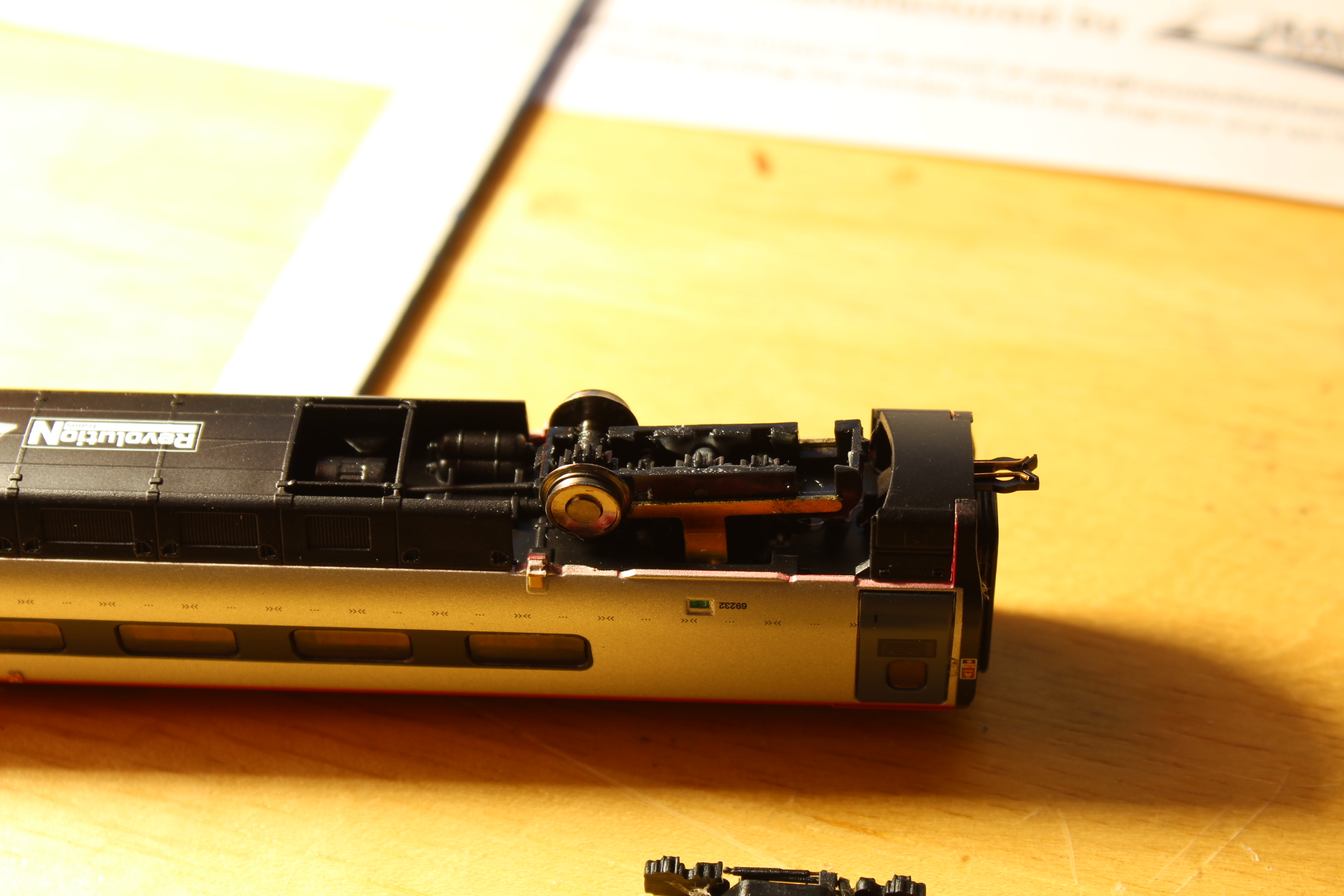

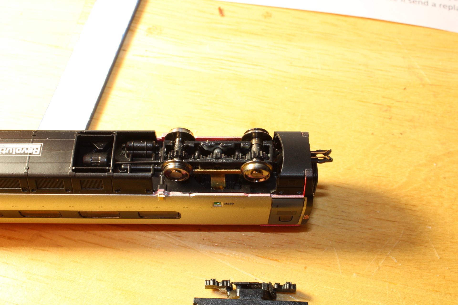

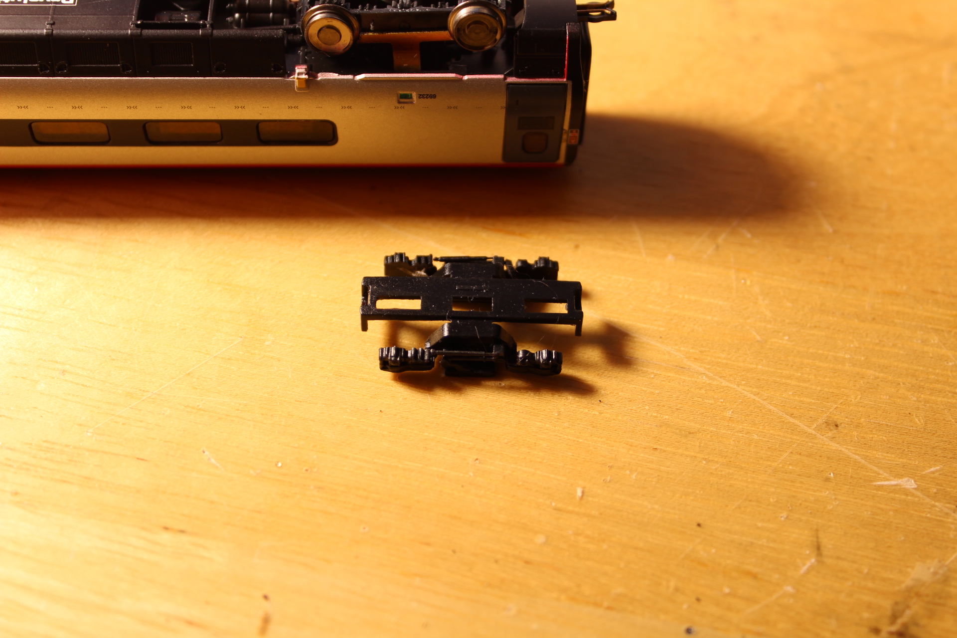

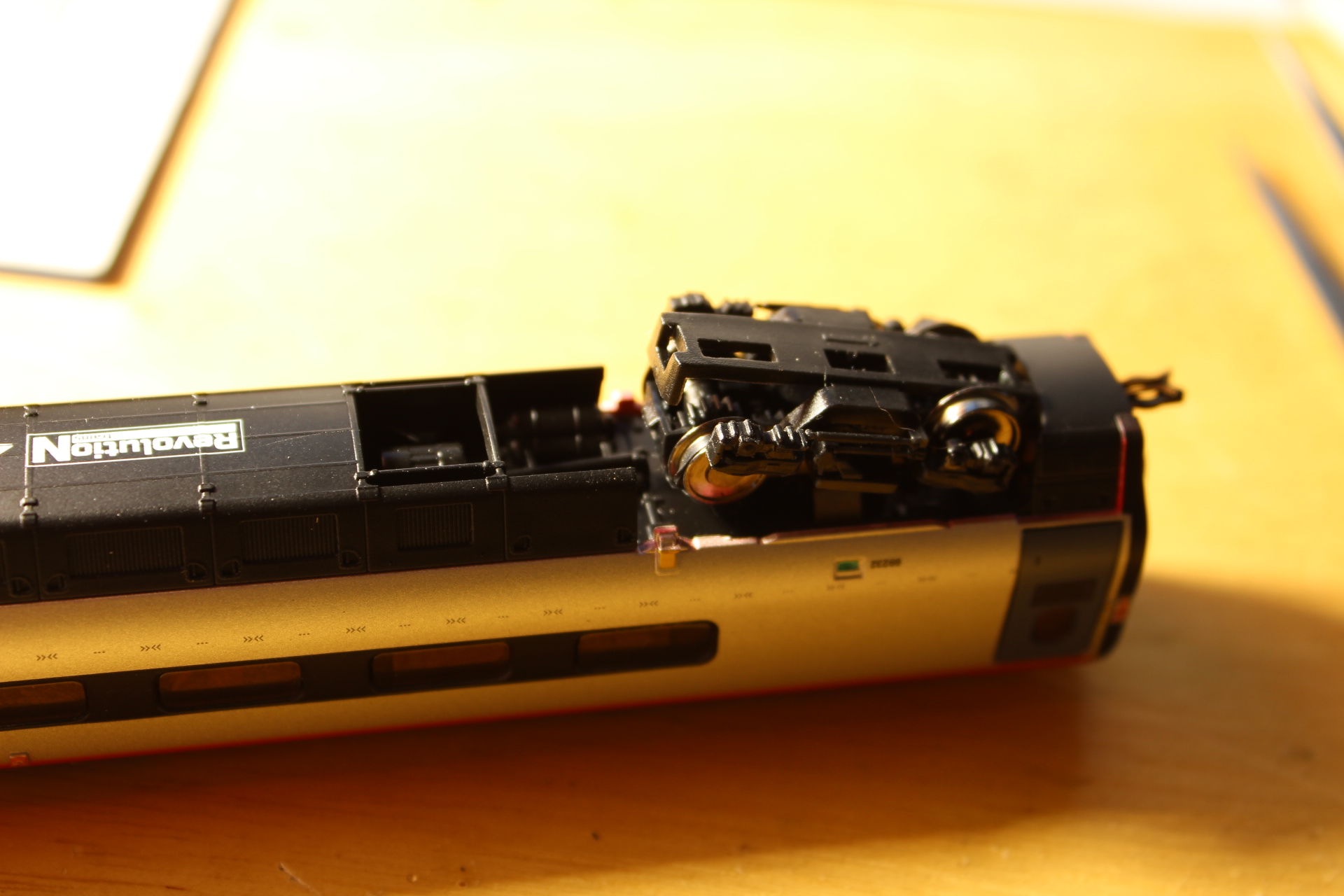

I took a look at the exploded parts diagram and realised that the bottom of the bogie just clips on to the main bogie tower. Using a scalpel blade I carefully levered the bottom of the bogie away
and ended up with this.
Then the wheelsets just drop out.

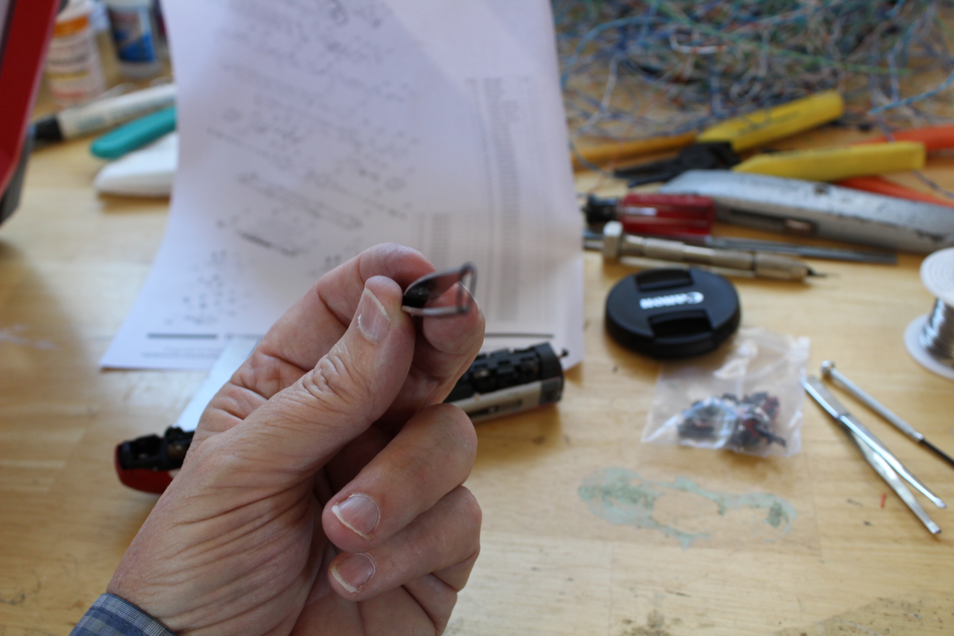

As I am completely inept when it comes to anything mechanical, I had fitted 4 tyres and broken a fifth before I realised that using my tweezers to force the tyre open and around the wheel was the way to do it, rather than try to hold the tire and the wheel between my finger and thumb and then use the tweezers to try to force the tyre around the wheel rim  :doh: :-[
Like this
