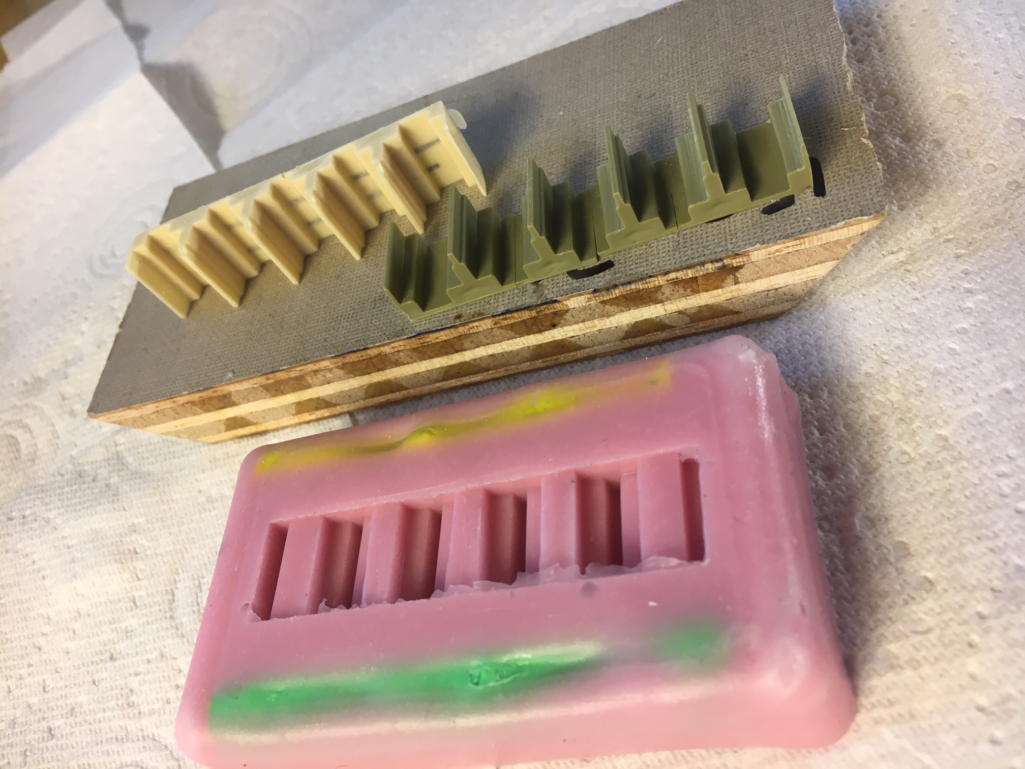

« Reply #20 on: January 30, 2020, 12:46:58 PM »
Some of you may remember me making an artwork to print paper interiors to cut n fold to make seats and bulkheads for Shredded wheat.
Ive just started on another set of Shredded Wheat to morph into something else, ive also got my Farish 'Gaffer' train set and my LMS pair of 4 wheelers all without interiors so I was thinking of a different approach. An old Farish Suburban has seats doesnt it? so off with its roof to extract the interior. Unfortunately the windows pitch is a bit different so I had to do a bit of cut n shut to fit inside a Shredded.
With double sided tape and a spot of superglue I adhered them inside a scrap kids cheese/biscuits pot and filled with silicone mould resin.
A day later and I could cast in polyurethane resin. The floor between seats is so thin that I dropped in offcuts of broken jewellers saw blade to stiffen things a bit.
Result - i have a mould and can make seats quickly, there is a problem in that the seat base tops (the bit your bottom goes on), is almost flush with the Shredded window ledges, im going to have to file the completed insert  on the cast floor thickness to lowere it a tad.
So --- its a 'near enough is good enough' job as nobody is really going to take a close look; these coaches just benefit from having bulkheads and a bit of detail to stop your eyesight seeing diagonal across coach windows. window glazing is coming from salvaged boxes from the grandkids Christmas presents .
And now for the next stage....
« Last Edit: January 30, 2020, 12:51:43 PM by Fredastaire »
