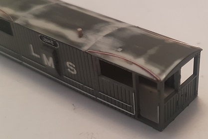

I removed the side steps, chassis, and internal cabin detail. Unfortunately the roof is moulded to the rest of the van, I had hoped it would be removeable.
One van was cut in half, and the veranda side windows cut out from the half shells. As the end result will be made from three bits I decided to 'step' the roof joint to hopefully give it a bit more strength, I also plan to glue some reinforcing across the joints where possible. The side lettering was carefully scraped off at this point.
The ends were removed from one other van to produce the middle section, again with a stepped roofline. The roof detail was removed from all three sections. Unless I can come up with some whizzy solution I'm afraid the guard is just going to have to put up with rain down the back of his neck.
The three bits are now married together after what seemed an age of filing and fitting.
There's been a lot of peering at my Peco N scale rule, and I reckon my version body is about 1" to 2" (scale inches!) longer than the prototype.
Once I've reinforced the roof joints and filled and sanded the roof I plan on replacing the chimney before painting the roof. If anyones got any ideas on forming rain mouldings I'd loved to hear from you.
That's it for a while.  I've got to cut and shut the two chassis from the base vans next. I've got some plateback bogies on order from the NGS, I've no knowledge of bogies in general, but these seem to look the most similar to prototype whilst being the correct wheelbase and wheel size.

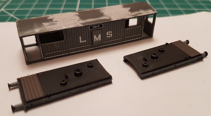

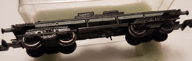

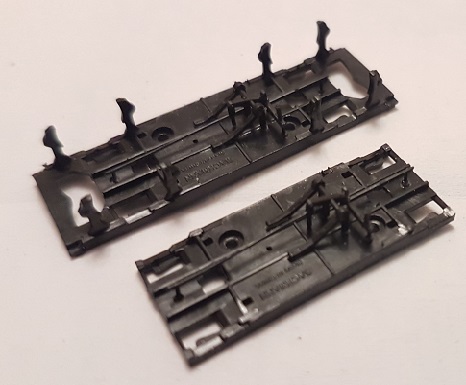

The two donor chassis were trimmed to size and then filed to get as near perfect fit as possible. The three-piece roof was filled ready for sanding back.
The two parts were then clipped onto the body. Because of the way I’ve cut and shut the donor vehicles, the top still clips onto the chassis using the original clips.
The original underchassis plate from the donor vans with the brake gear on has been roughly trimmed to size for use later.

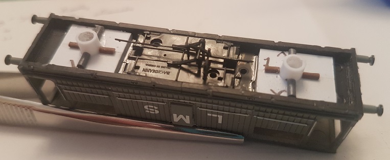

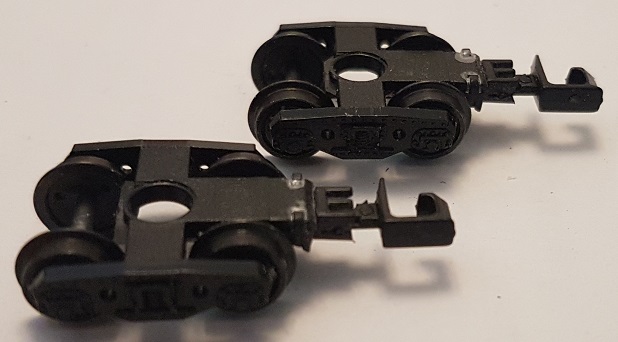

The NGS plate back bogies were assembled. They took a bit of fettling to get the wheelsets, from Dundas, to run freely, and the NGS couplings, despite my efforts do not lift and drop freely, but I’m at a loss as to how to get them any better.

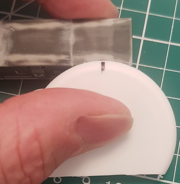

For anyone who followed the other discussion I started about NGS bogies, I elected to have a crack at making my own bogie mounts. I used the bogie mount from the NGS Warwell kit as a ‘template’. The base is plasticard, the spigot is 4mm styrene tube. The small ‘spokes’ are thin rod glued to the base. These are necessary to stop the top of the bogie rubbing on the base, in effect they are a bearing surface. The brown ones were the first attempt, but didn’t lift the solebar clear of the bogie sides, so the grey rods were fitted which give just enough clearance between the solebar and the top of the bogie. The styrene rod was from a Slaters assortment pack.

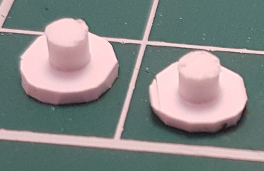

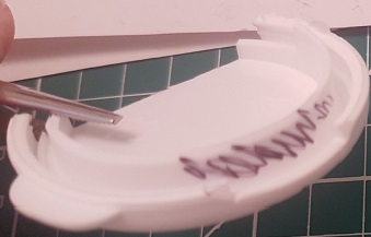

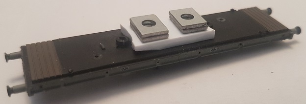

Bogie retainers were made from plasticard and 2.5mm styrene rod.
The bogie mounts were glued to the chassis along with a further trimmed brake detail. I suspect the detail isn’t correct, but it’ll do for me, just gives a bit of something under the chassis. The under floor was then given a coat of black acrylic. As a point of interest, the Farish underfloor brake gear actually pivots freely in the ‘V’ hangars once the ends are disconnected.
Once the paint was dry, the chassis was carefully removed from the body, a reinforcing piece of plasticard was glued across the top of the joint and the small metal weights from the two donor vehicles were superglued to the top to add some weight. This little pile was also painted black so it shouldn’t be visible once assembled.

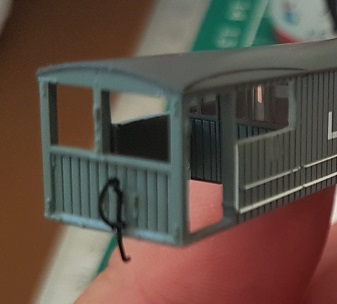

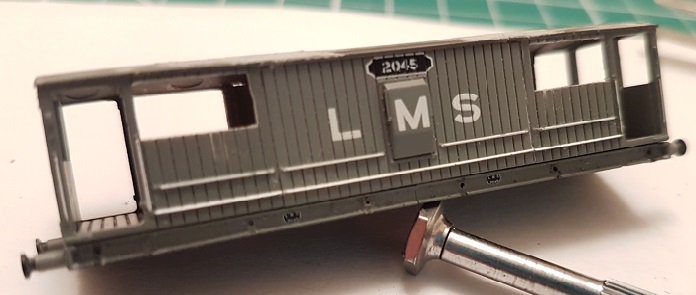

After sanding back the filler, the only work left on the body was the roof detail which I’d been dreading. Following @PLD ‘s suggestion I decided on the wire method. I found a polythene supplement lid with a suitable radius and then trimmed it to produce a locatable and repeatable template. The opposite edge of the lid was trimmed so that it could be held/wedged against the body to stop it shifting. I used a ‘panel scribing’ tool, which I bought 30+ years ago (first time I’ve used it – I knew it would come in handy eventually!). The tool actually removes a thin strip of plastic. Strands of copper wire were trimmed, formed and glued into place with thin liquid poly.
Lastly, the chimney was made from some more plastic rodding and glued into place.

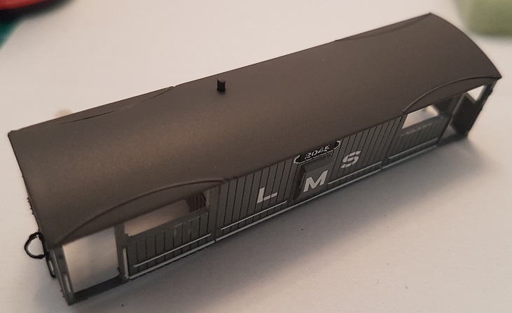

The body went off to the paint shop, where I masked off everything below the roof. Two light coats of primer, two light coats of Tempest Grey, followed by a coat of satin lacquer.

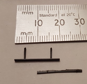

The running boards were always going to be tricky, so I started by cutting and fixing the ones attached to the solebar so I’d got a level for the bogie mounted ones. Running boards for the bogies were cut from the surplus donor running boards and glued at the appropriate level to the side of the bogies. They’re not stunningly good, but without zooming in on a digital photo you’d be hard pressed to tell. I did find I had to nick the back corner off the ends of the fixed running boards to enable the chassis to navigate tight radii.

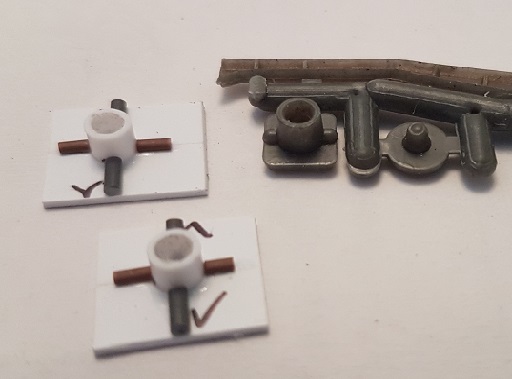

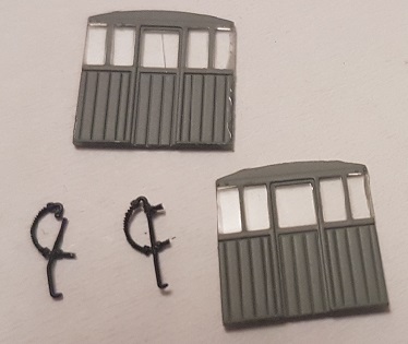

Only some small details left to do, cabin ends and pipework.
The end panels for the cabin were glued back into their rightful place, and the pipework into the original location on the ends.

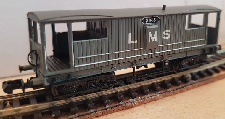

Finally, with a bit of a fiddle the chassis and body were reunited (and a small step glued back on – again!).

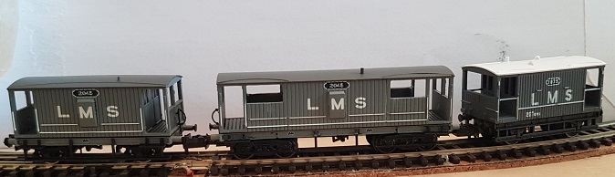

For comparison purposes, here's the 40T bogie brake with a donor van and a Peco van.
I apologise to the rivet-counters and perfectionists, it has the wrong vehicle number, I may rectify this in the future by overlaying white and black blanking decals followed by the correct number. It also has two 'plates' each side, but it'll have to live with that for the time being.
The original plan was to try to make a passable representation of a 40T LMS bogie brake without doing a major repaint. I'm pretty chuffed with the end result, it's not perfect but I don't think it's too bad. I am really pleased with the roof, that came out far better than I anticipated.
I hope I haven't bored the heck out of everyone, thanks for reading.
