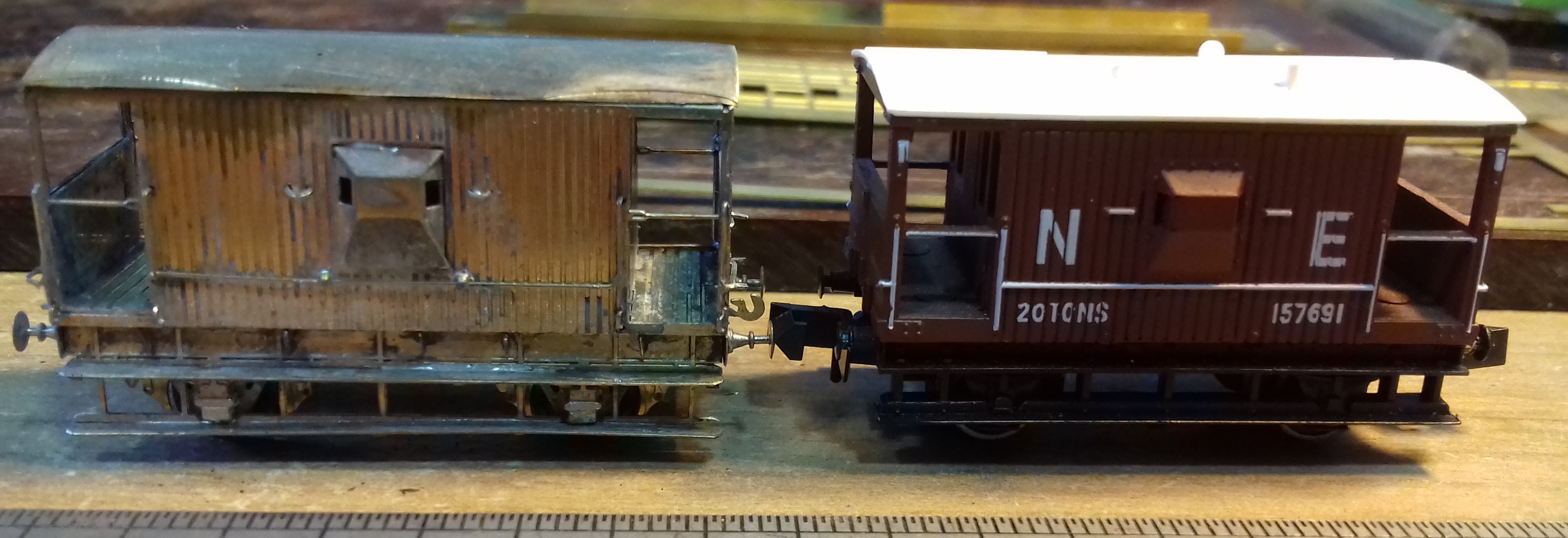

I dont suppose you can do a side by side comparison of these 2mm models next to similar design 1:148 wagons? I'd like to know if the size difference between 1:152 and 1:148 was very noticable?
Certainly, here are a couple.
At the front is a Peco 9' seven plank wheelbase wagon with the 2mm Association one at the back. Both are running on Peco's 9' wheelbase chassis and you can just see that the 2mm body is ever so slightly short on this.
Below the front six wheels are again the Peco 9' seven planks while at the back are 2mm LNER six plank wagon bodies.
To be honest, I don't usually worry about running short wheelbase wagons that are 2mm scale as some of the earlier N gauge items can be all over the place dimensionally. As a case in point, my 2mm Association Toad E is slightly longer than my N gauge Peco model of the same van. I wouldn't be as comfortable running 2mm and N gauge coaches together though - at least not in the same rake.

I thought the width would have been an issue more than length tbh, how do the 2mm chassis look/sit with 1:148?
Are your Toads roughly the same height if one is a full 2mm chassis and body?

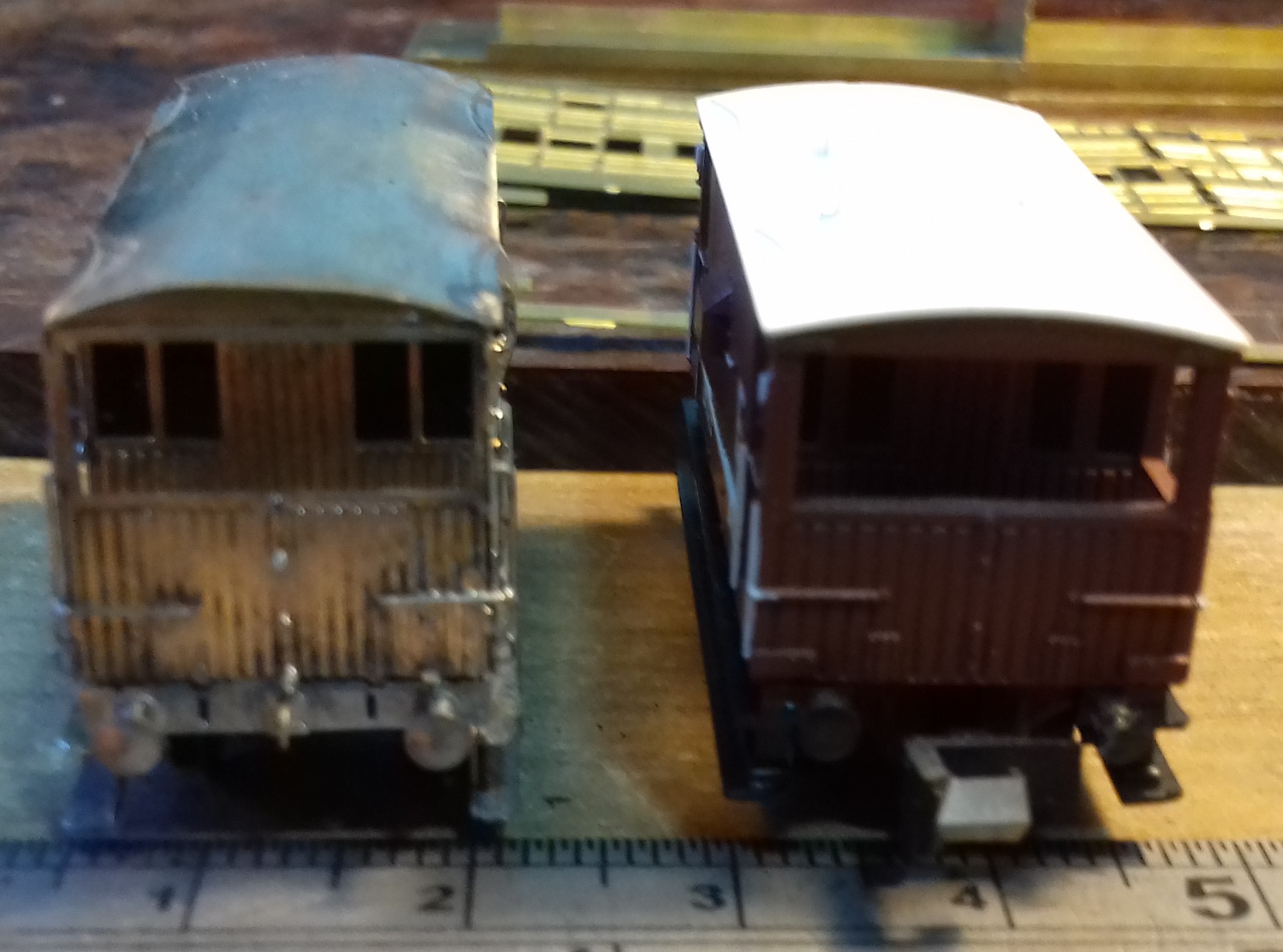

Hi Ashio,
The only wagon that I can do a direct comparison with is the Toad E.
You can see here that the 2mm Association's version is much narrower than the Peco one. I measured up the Peco's width and found it scaled out at rougly 8'4" while the prototype should be 7'6" wide. That puts the Peco Toad E at almost 2mm over width while the 2mm Association's one is around 0.5mm narrow for 148 N gauge. If you don't mix 2mm and N gauge models of the same prototype wagon in the same rake (or at least next to each other), I doubt you'll notice the difference in scale. Copenhagen Fields uses a bit of converted N Gauge stock and (to my eye at least) blends in well with the true 2mm scale stuff.
Regarding the Peco chassis, the 2mm scale seven plank wagon in my previous post is mounted on a Peco 9' wheelbase chassis. It seems to hang together well enough in my opinion.
If you're concerned about paying to join the Association, perhaps you'd consider buying their "taster" pack for 8.50 (including postage). This will provide you with a 2mm scale steel mineral wagon kit (with 2mm scale wheels) and a length of track. While the wagon is of no use to me, this is how I got started with the Association.
