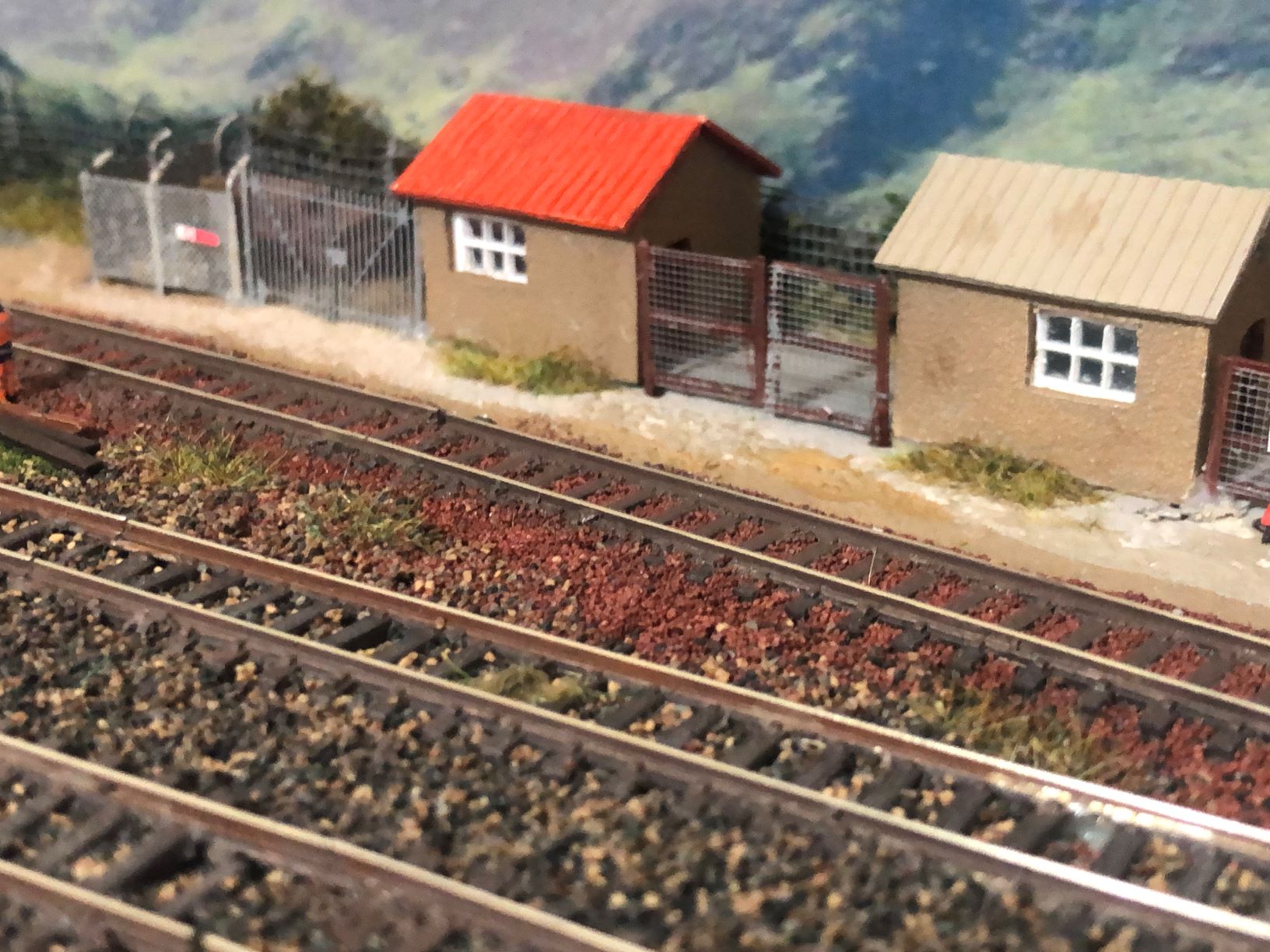

I've been so busy modelling that I've forgot to post progress.

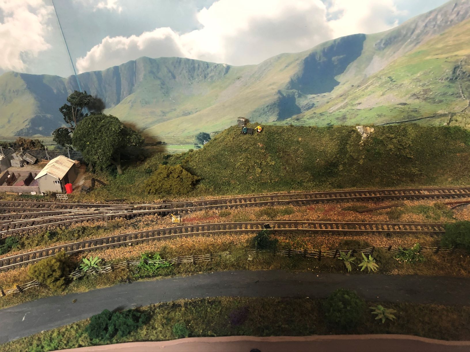

So, Tom Na Faire almost done.  Just been painting the last scratch built buildings, adding TPWS grids, people, coal, muck, skip junk etc.  Most of my time has been making fencing.  Post & wire fence, security fence, wooden security fence, Palisades fence etc.
So the Post & wire fence uses posts by N-Scenic.  These tiny little things have holes in them so you can feed wire.
I used bus wire which in hindsight is a little thick, but I figured it needed some strength so it would not break when manipulated.   Spend a good few hours trying to strip & unfanckle wire.
I could have bought fencing, but I needed 4m of post & wire and 1m of all the other bits, so was working out expensive.
The post & wire fence has 198 posts with 4 holes each, so I had the thread 768 holes.  Oh my eyesight!  Took me a whole week of evening seclusion.
I painted the posts with a bit of a wash of burnt umber, black and a little yellow to make an aged wood.  I then swiped over with a grey wash.
Putting the posts in the scenery, i tried not to make them nice and neat, but tried to reflect undulating, soft ground, movement of years of being in place.
I wanted the fence to reflect the run down nature of the yard.
So overall, rather nice posts if you have the patience to thread wire through holes.

Some photos of the post & wire fence:
And finally all in place.

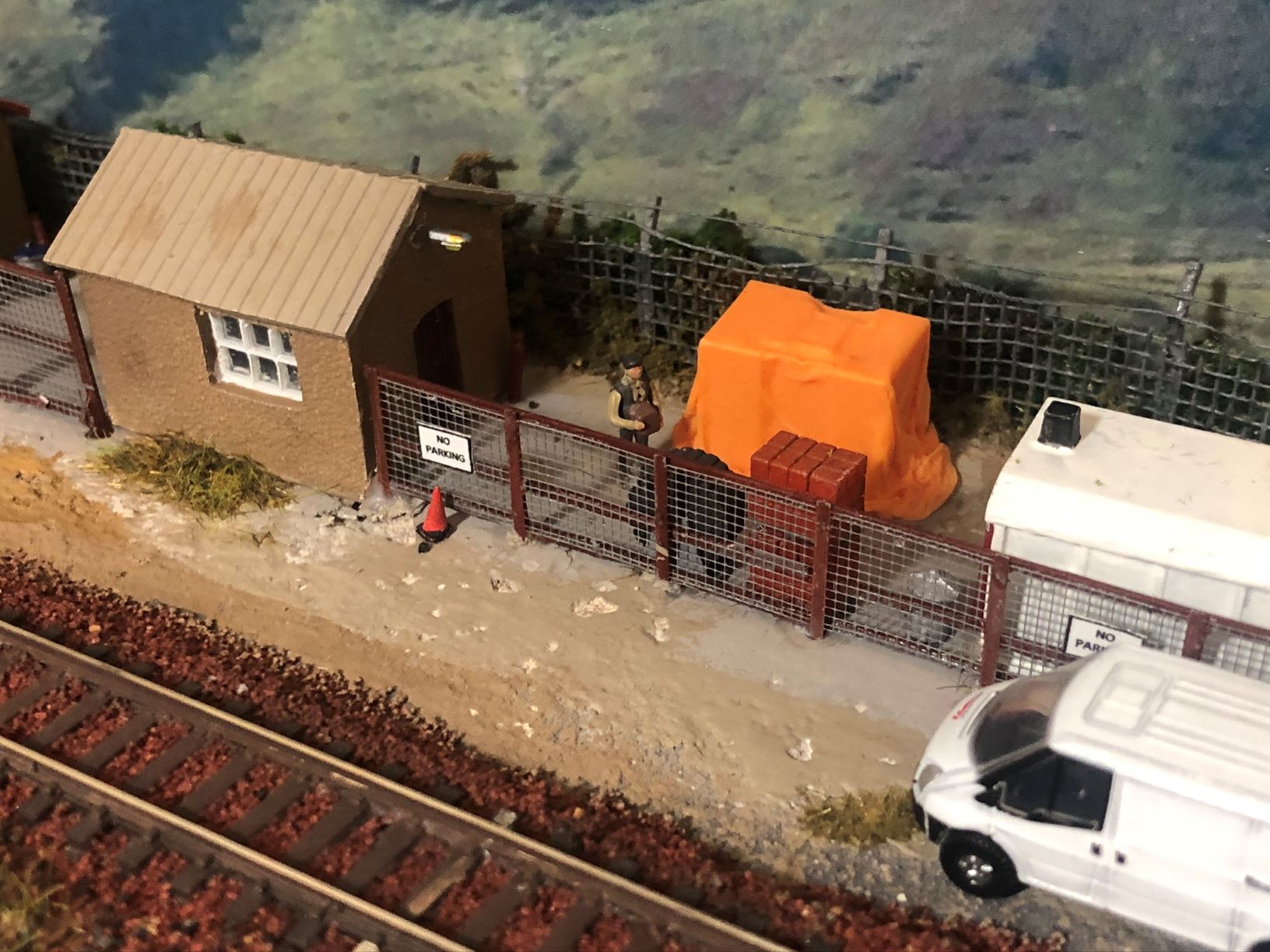

Good idea that, but I just liked the wire in the fence.  I used square wire for the security fence posts.  Made a little jig to bend them mostly to the same angle.
Know what you mean about cost.  I felt the same about buying security fence to get the uniformity, but it's a lot of money when you take into account you only get 300mm and still have to make it all yourself anyway.

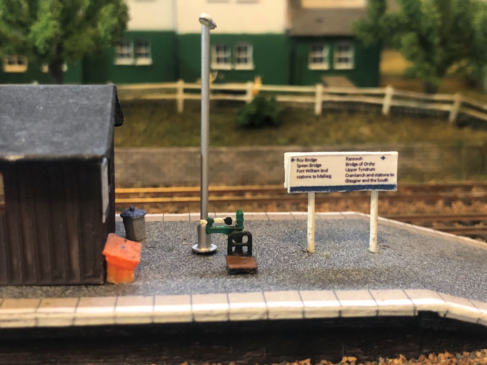

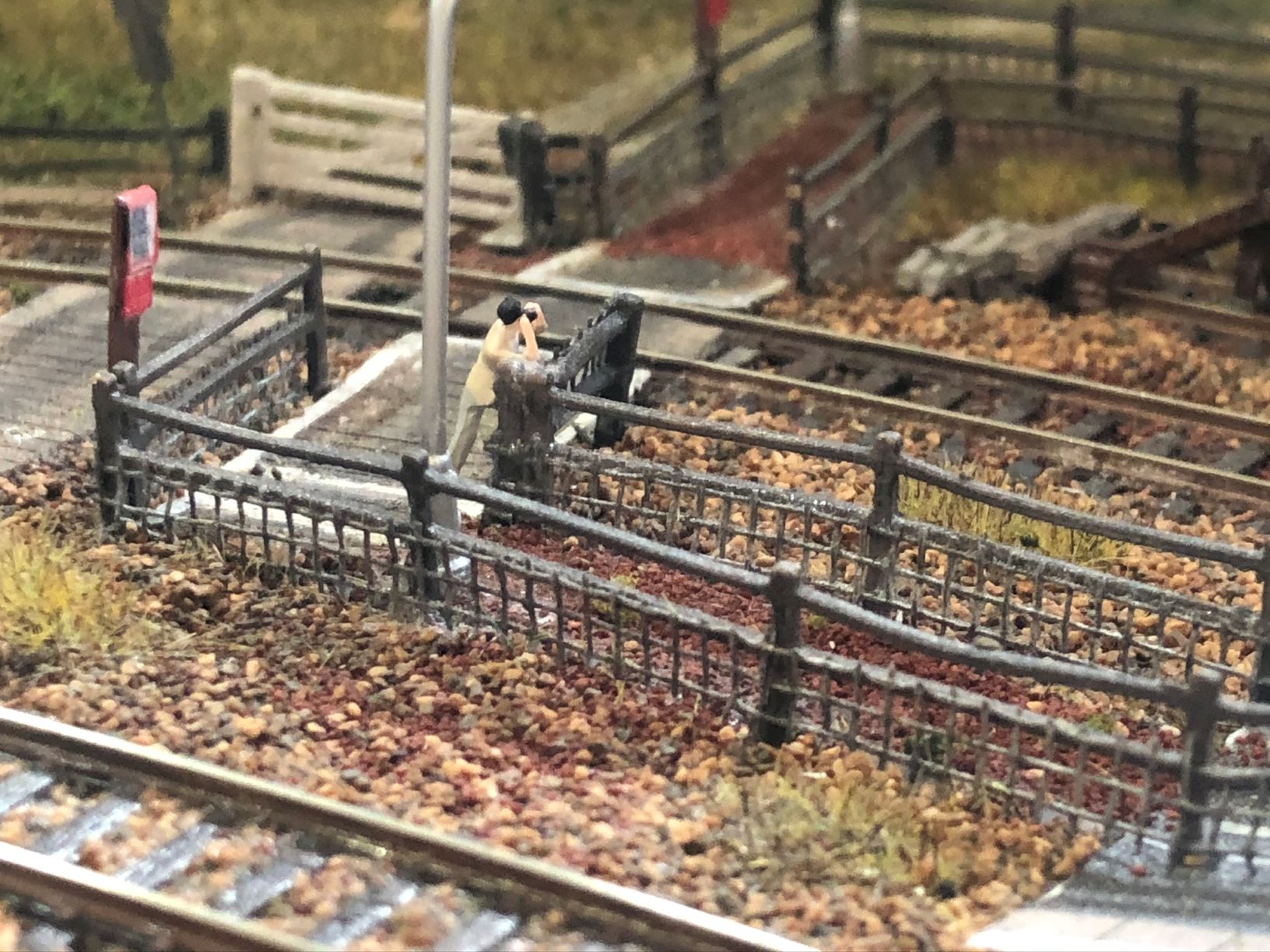

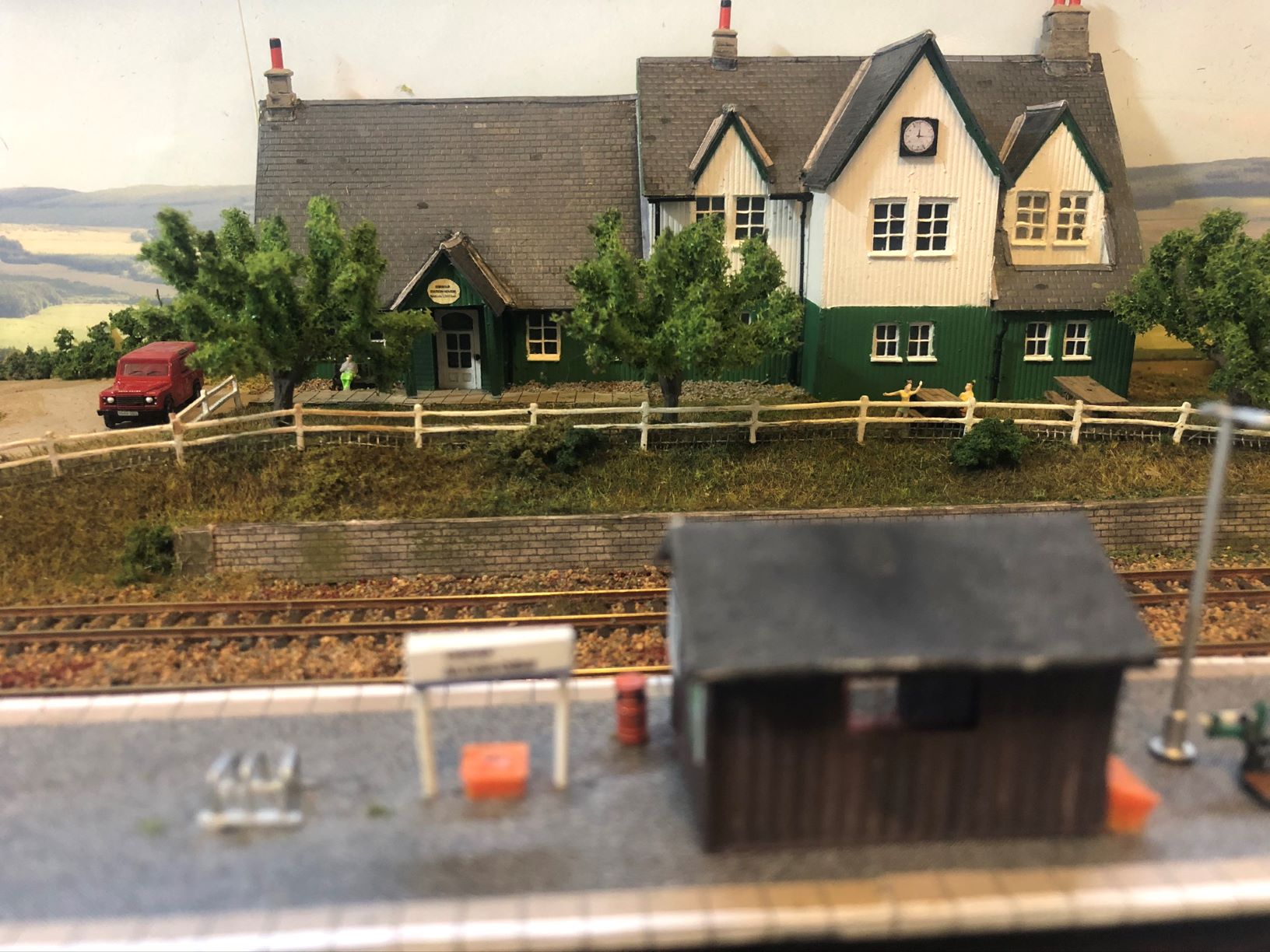

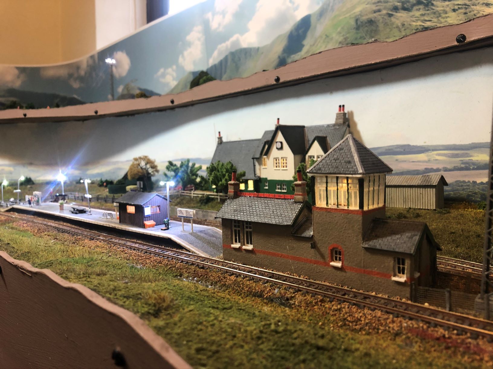

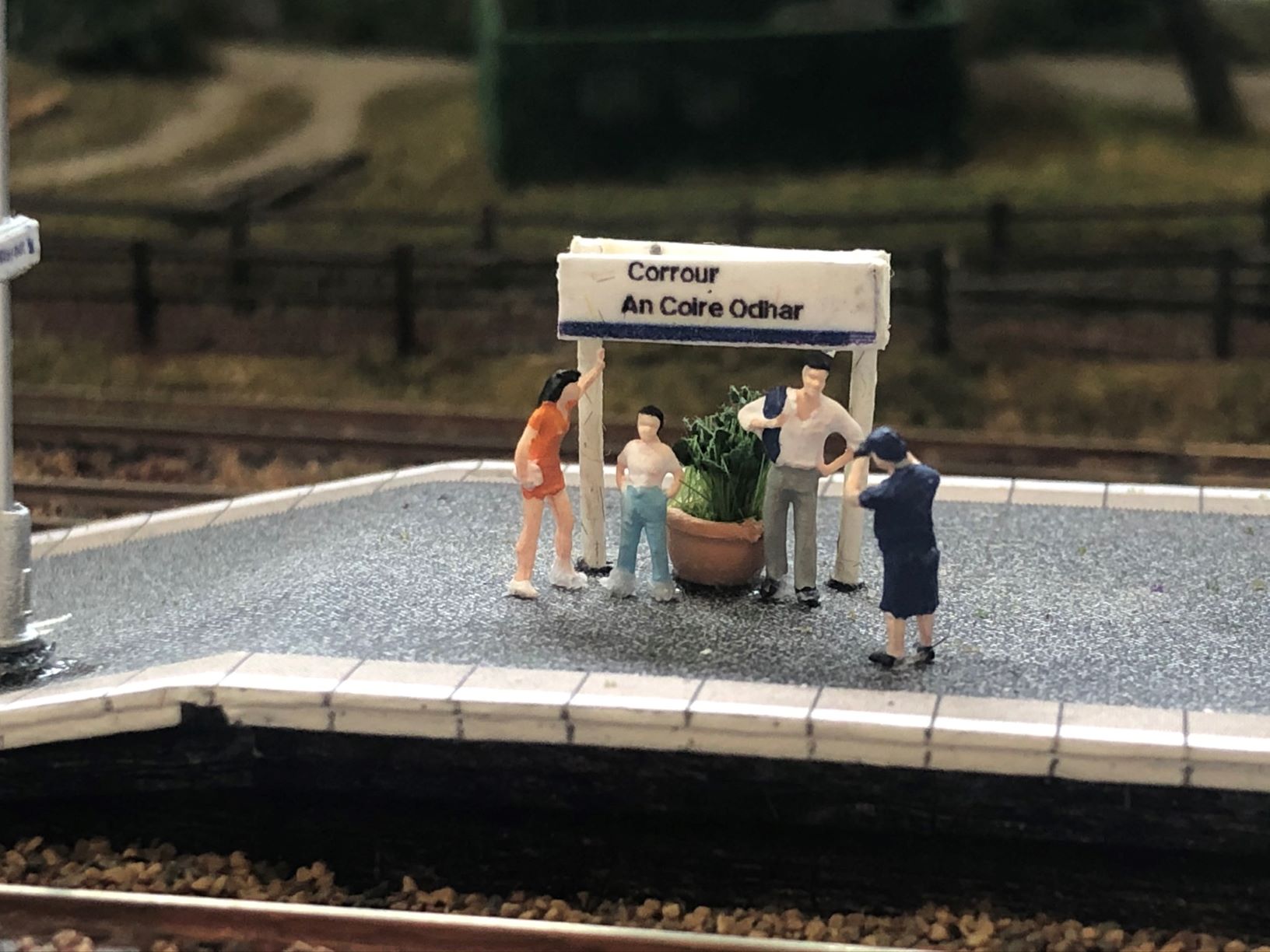

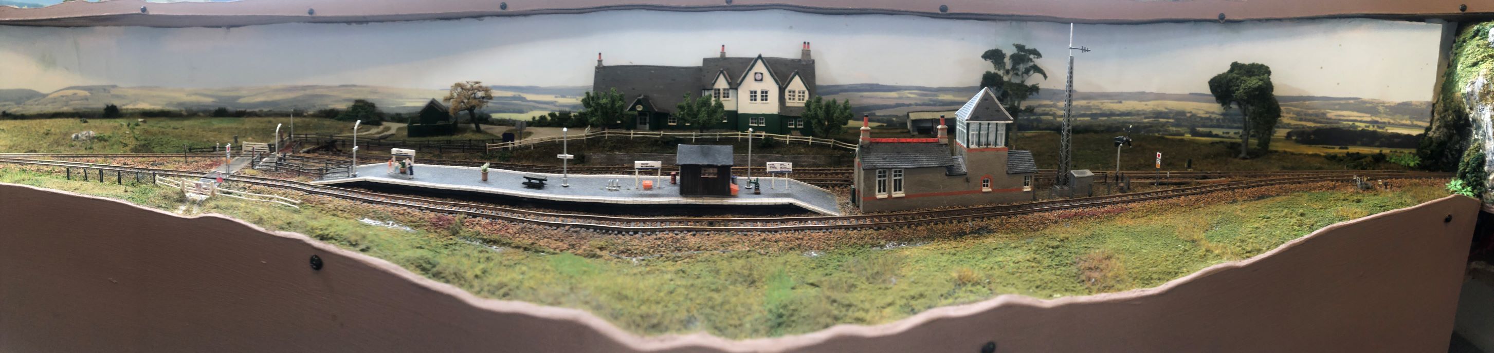

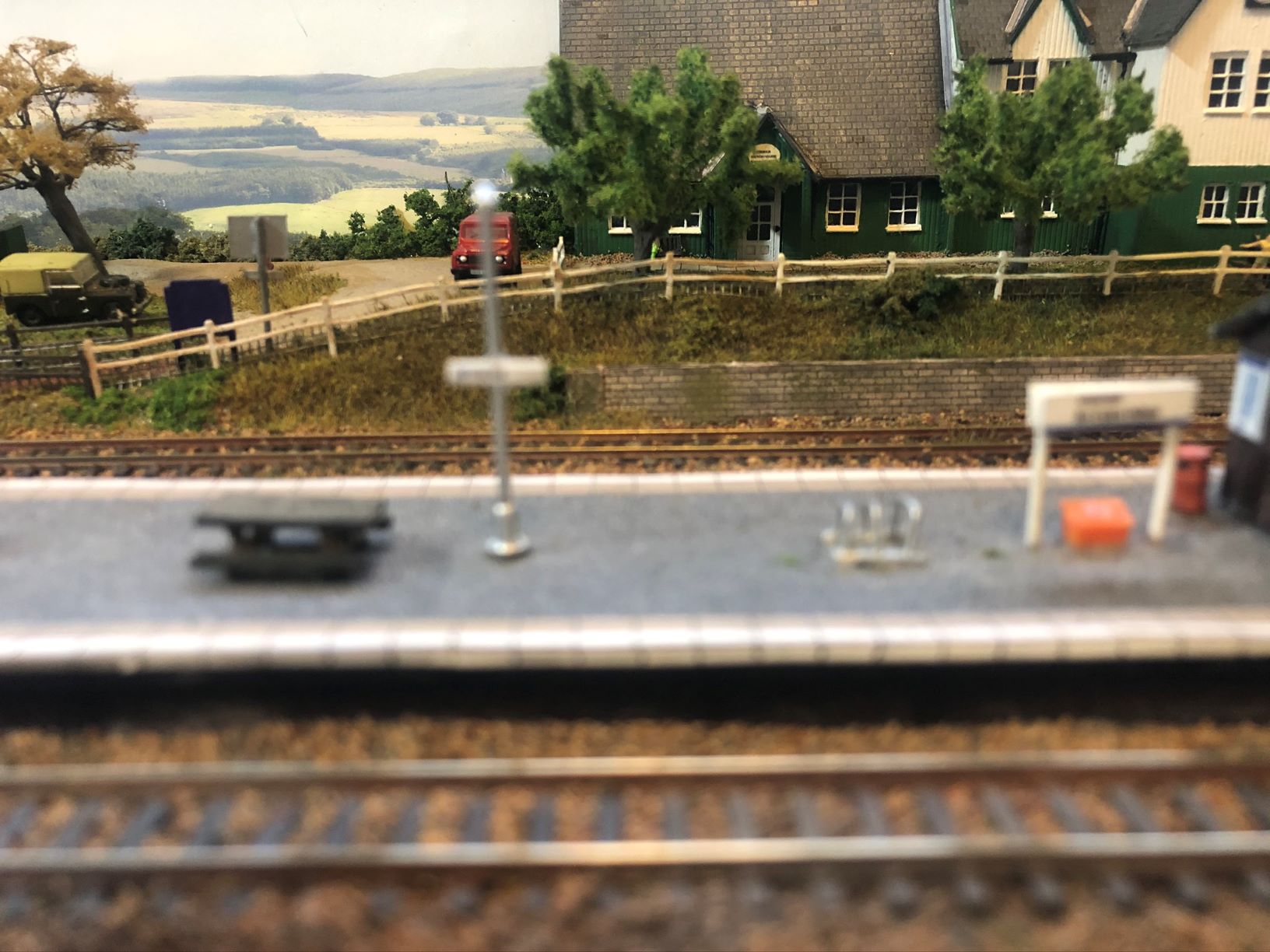

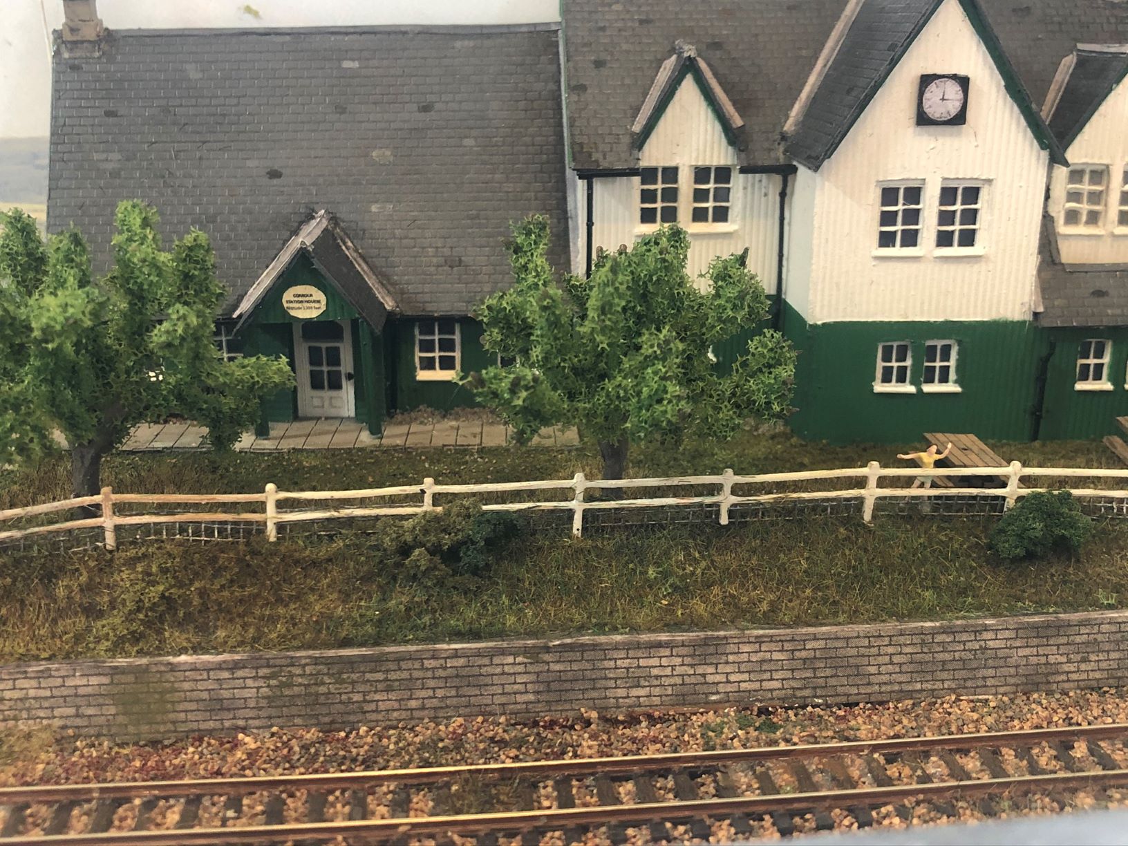

So let's start with Corrour station. Pretty much all scratch built.  The Station House took me ages, but really please how it turned out.
Long shot, then some detail. This was my second modelling project after Rannoch Viaduct and I had learned a lot by then.  Not enough to stop me making the baseboard too small though :-)
It's Spring, so the tourists are out taking photos.

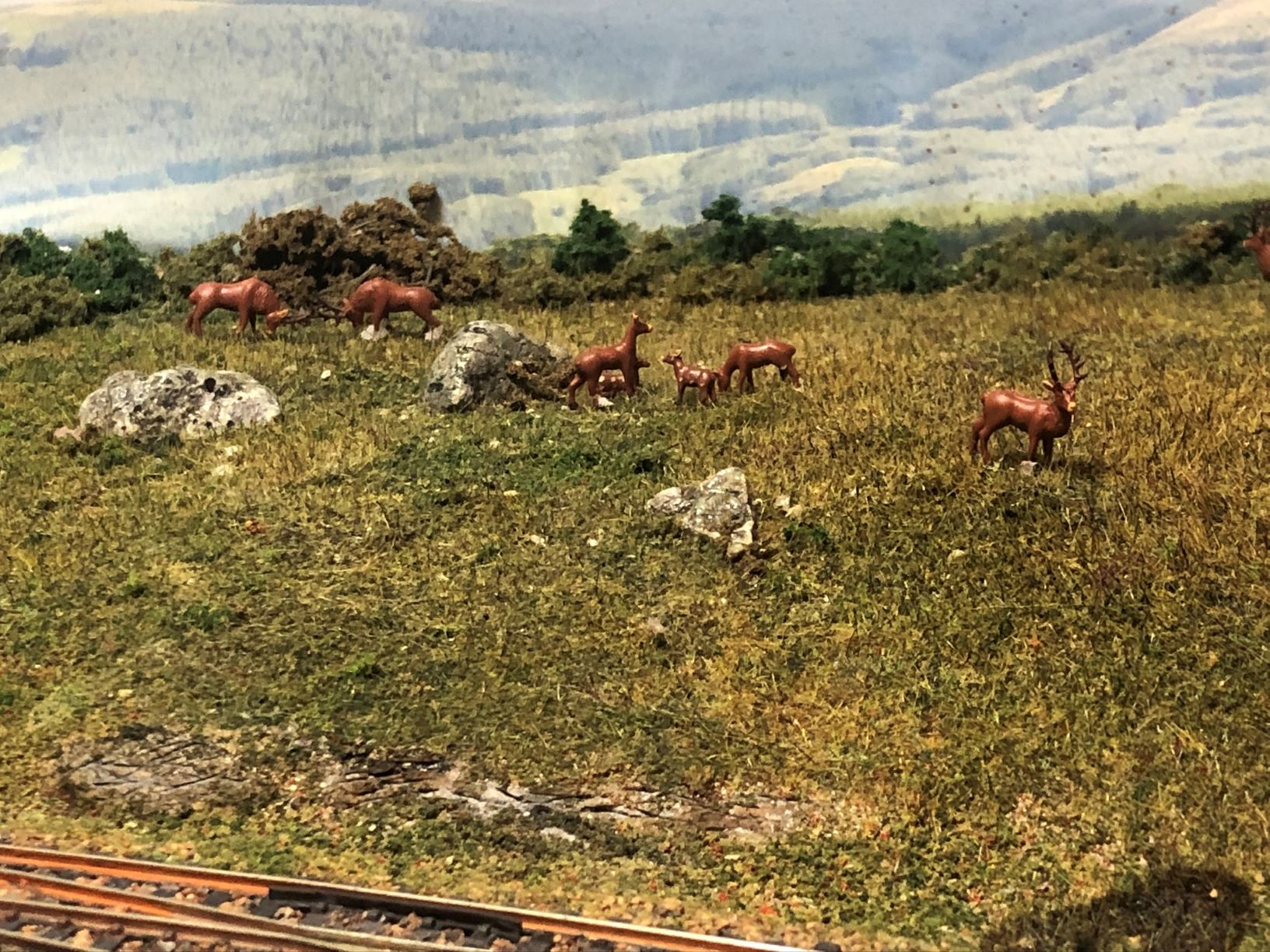

And of course, the deer.
and it all lit up.  I've used Train-Techs random light timer to have the room lights randomly turn off and on.

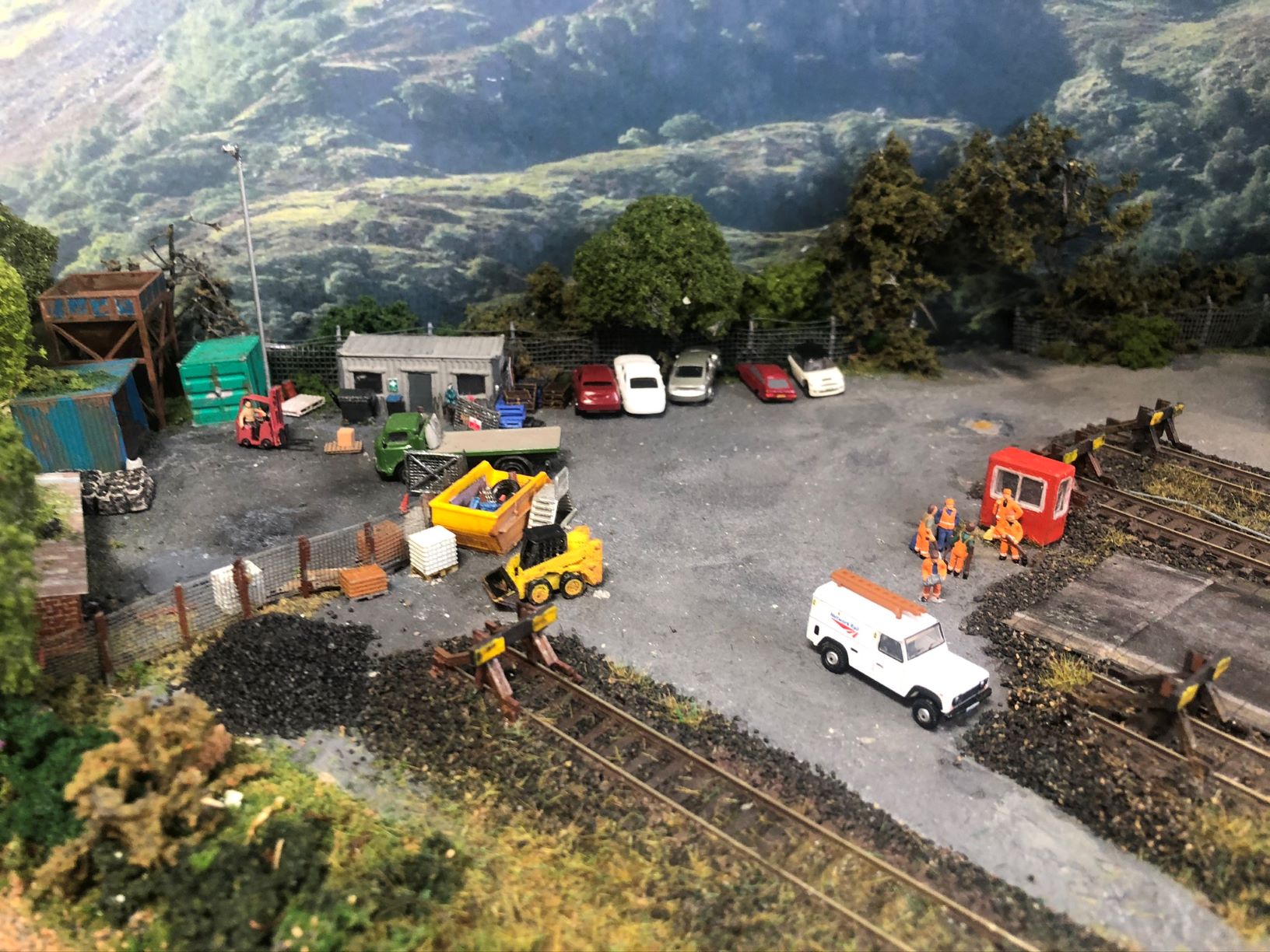

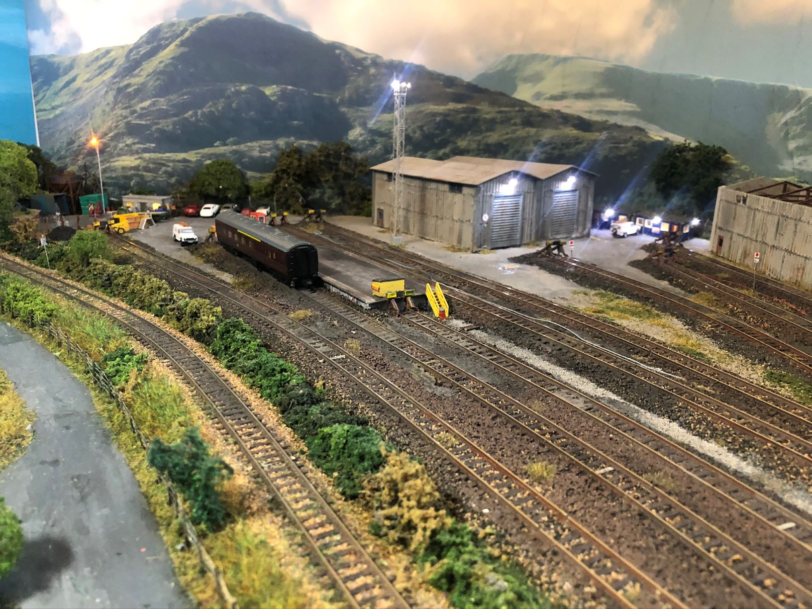

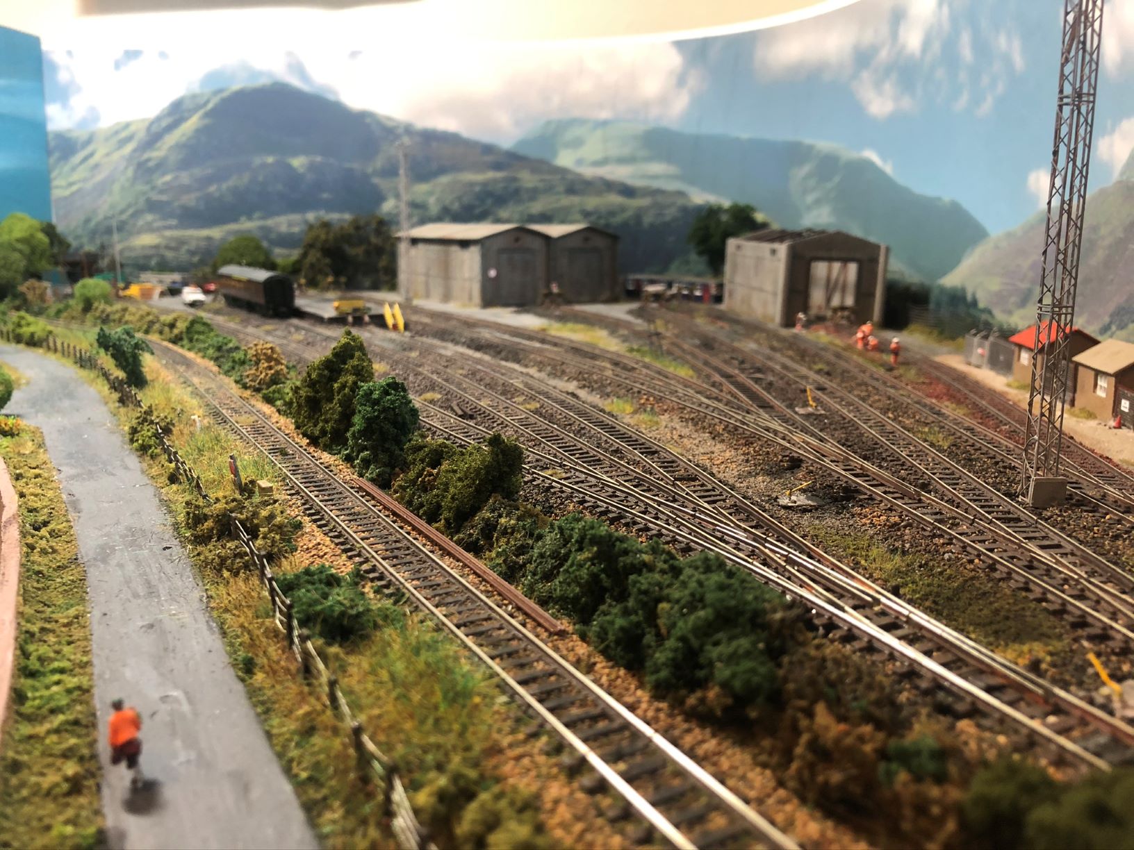

So then Tom Na Faire depot.  Long shot, all lit up,  then some detail.
Again mostly scratch build with the sheds from outlands models.  Fence ! don't talk to me about fence!  Labour of love or madness!
Cyclists on the road waiting for the next train to photograph.

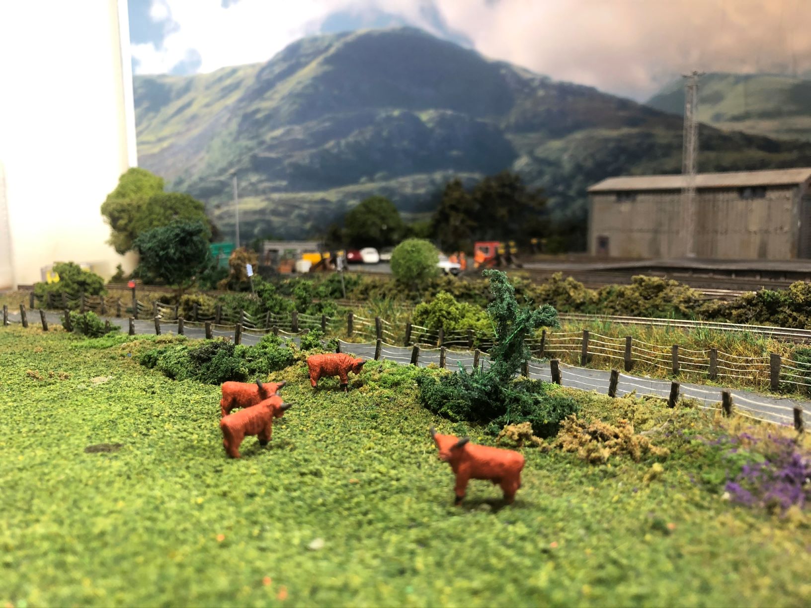

Highland Cows (of course!) watching nonchalantly as they do.

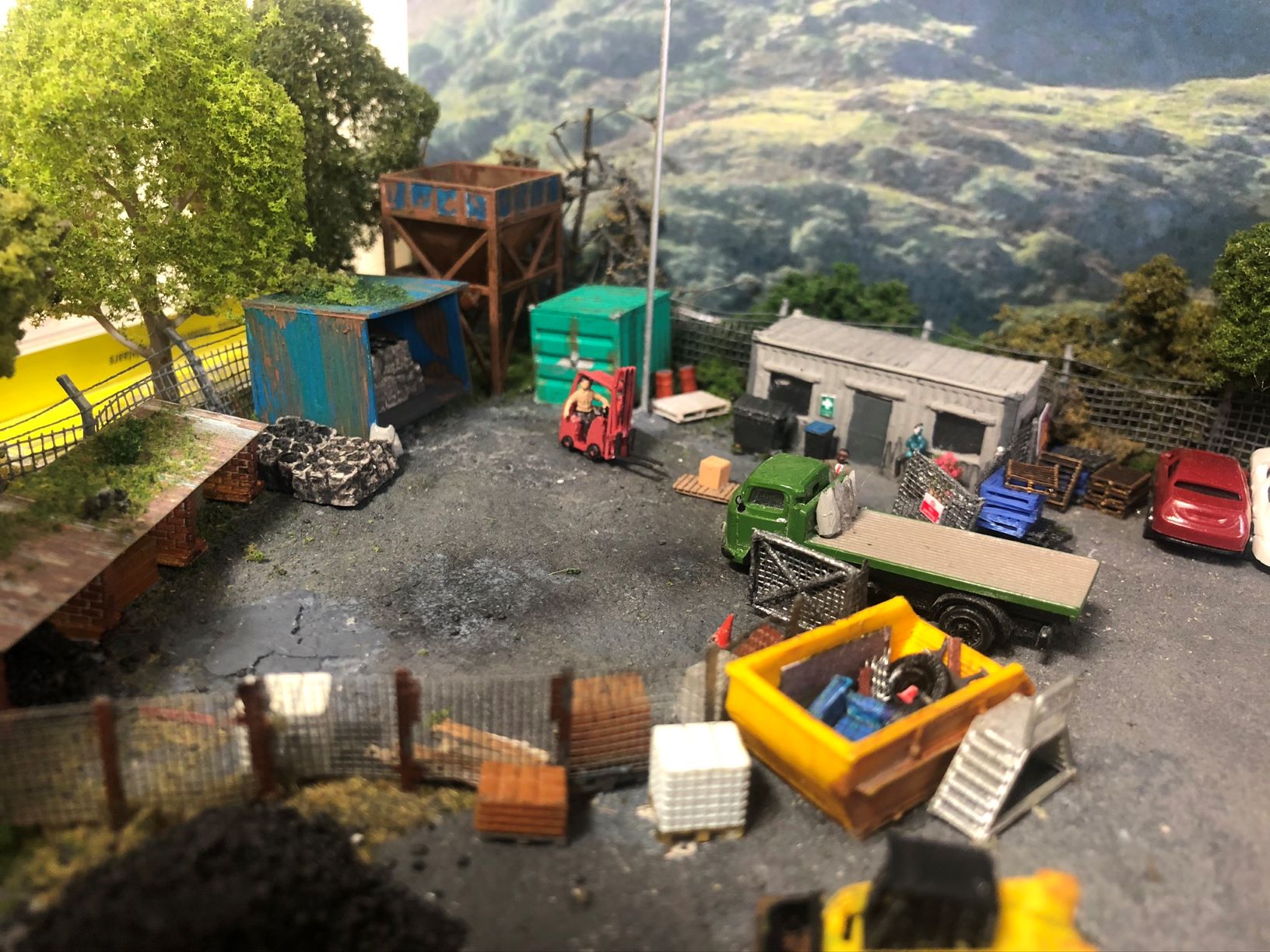

Here's the coal yard up in the corner.  Coal lorry arrived for stock.  Being directed to where to park, coal ready to go, young lad take the chance of a rest, takes a pew on the barrel the office uses for an outside table.  All the area is dark, dusty, run down, rusty. Buildings are a bit lean-to, trees deposited stuff on the roofs.
Really like this scene.  Took me ages to build.  Even made the arm chair that's dumped in the skip.
There's a fair amount of 3D printed stuff here.  Gas tanks from Peedie models, Hopper, bins and pallet goods, including water tanks from Shapeways.  The rest is all me (and evergreen sheets!).  I like the ash dumpster bin on the platform.
On the other part of the yard, the cleaners are waiting for the Jacobite coaches to arrive to give them a thorough clean.  The Dispatch Box is used for storing kit & work schedules.

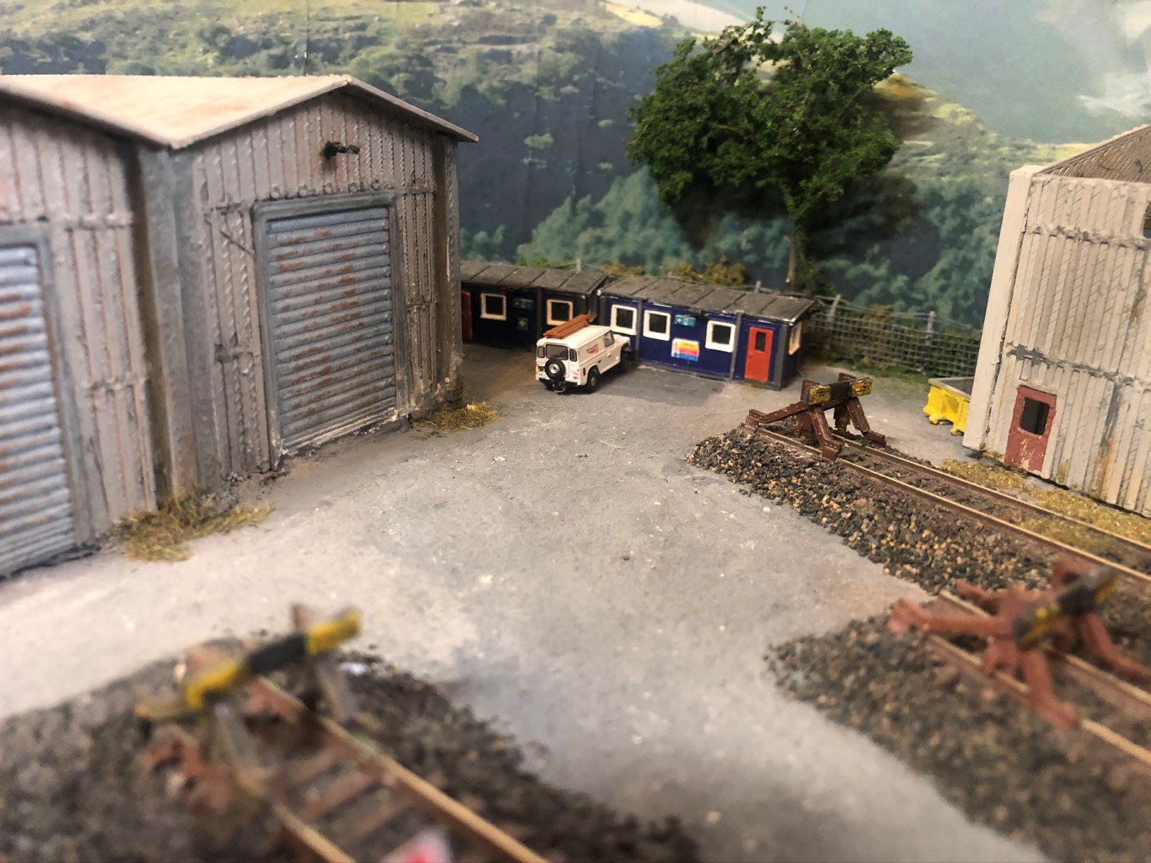

Now. moving around the depot....
Office block

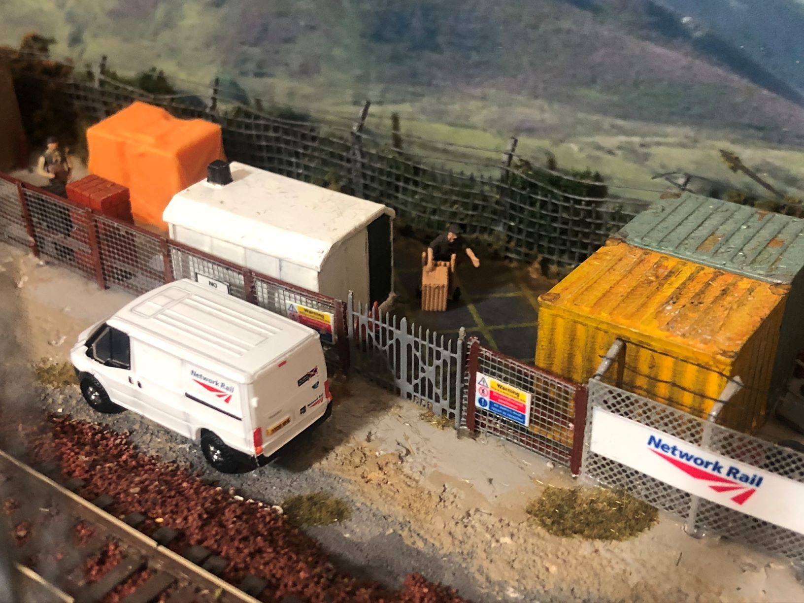

The Network Rail yard with a variety of goodies.  Van there to pick up packages and materials.  "No Parking! How many times have we told you drivers---- no parking!".
Wish I had more space on the model to do more - caravan for security guard etc.

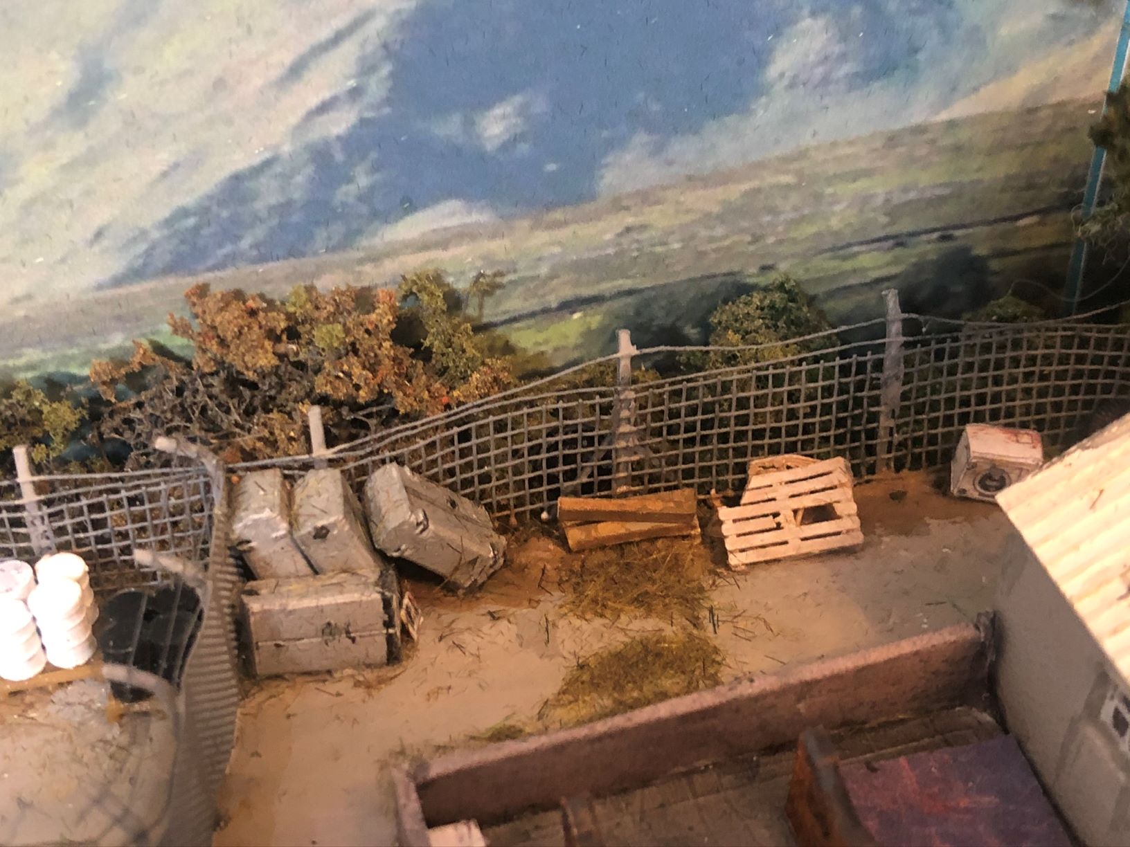

And behind the old diesel fuelling point, there's always junk.  Old Lineside relay boxes and an old rusty washing machine!  Who does that?

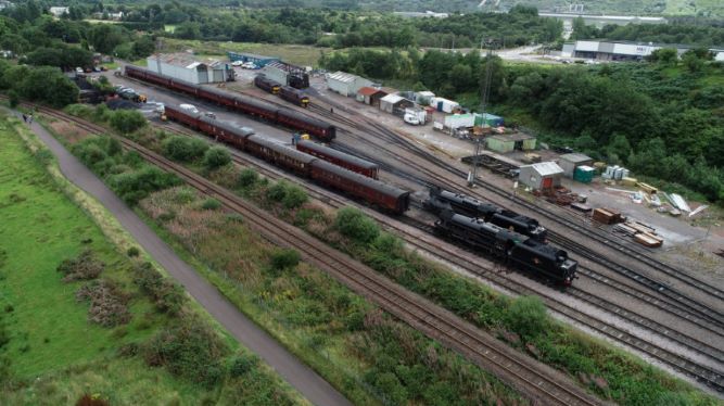

So, overall, I think I've replicated the photo I was working to quite well.
Got a little more detailing to do here, but just being fussy.  Have to say I'm rather chuffed.

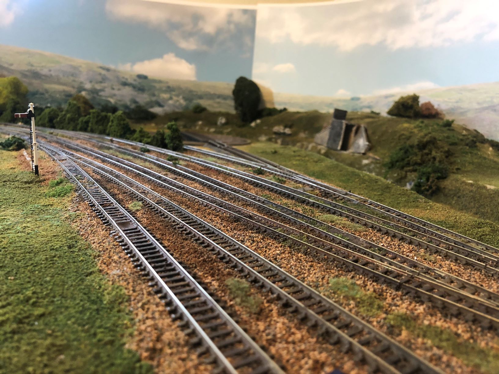

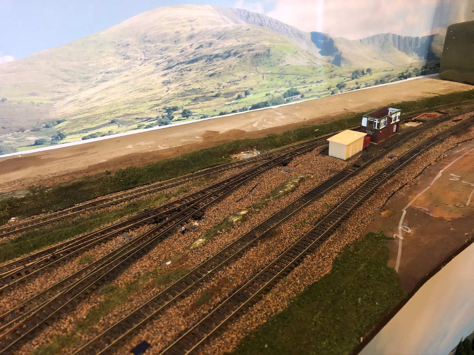

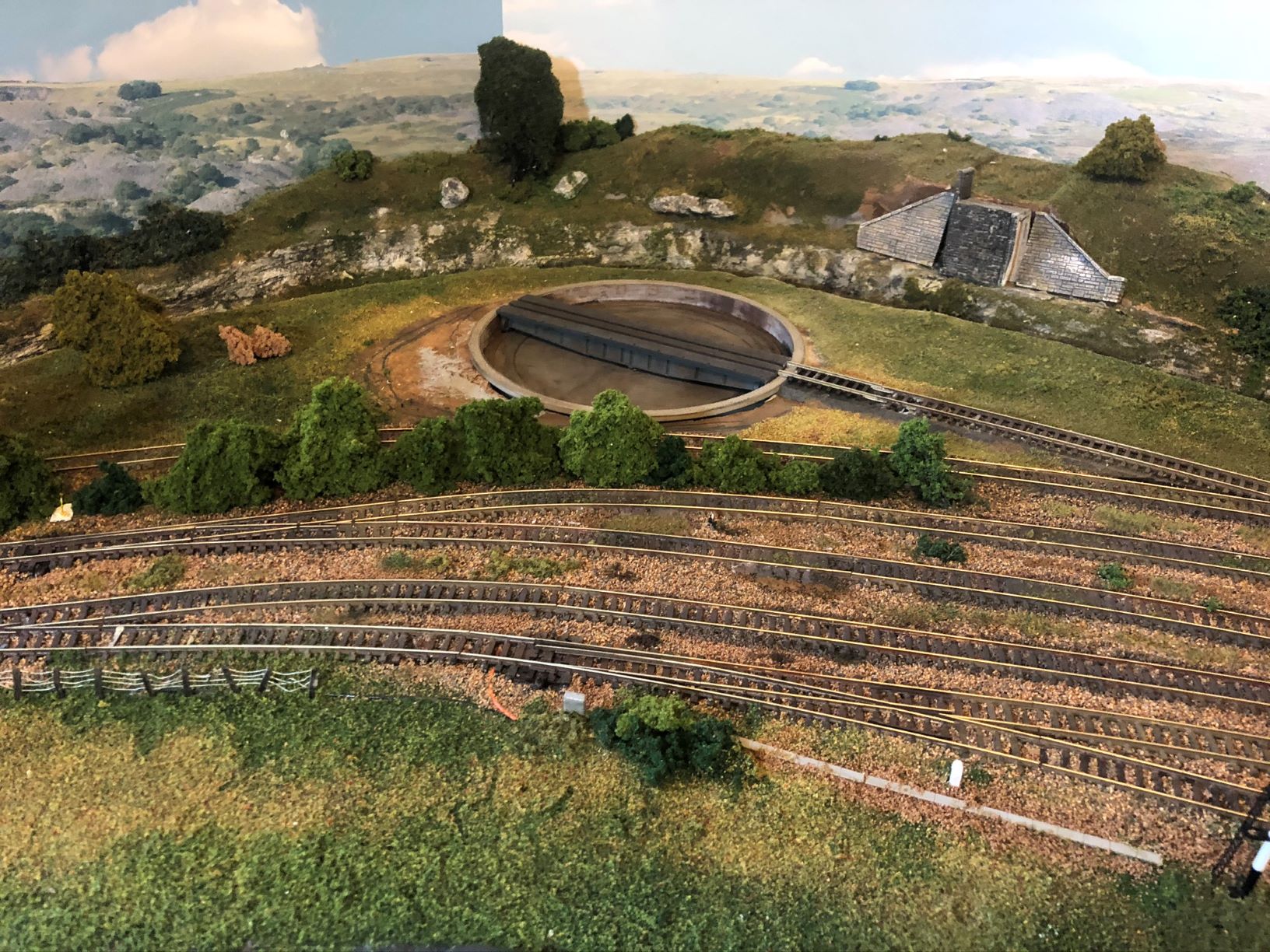

Next bit I'm working on is Fort William Junction.  This is the run past houses, passed some out of town shops, the old turntable, used only a few times per season, so looking a bit sad - like all the area really.  Passed FW Signal box, the oil refinery & terminal,  over the River Ness to the station.
So FW Junction is quite big, but I've stripped a few of the sidings out to fit.

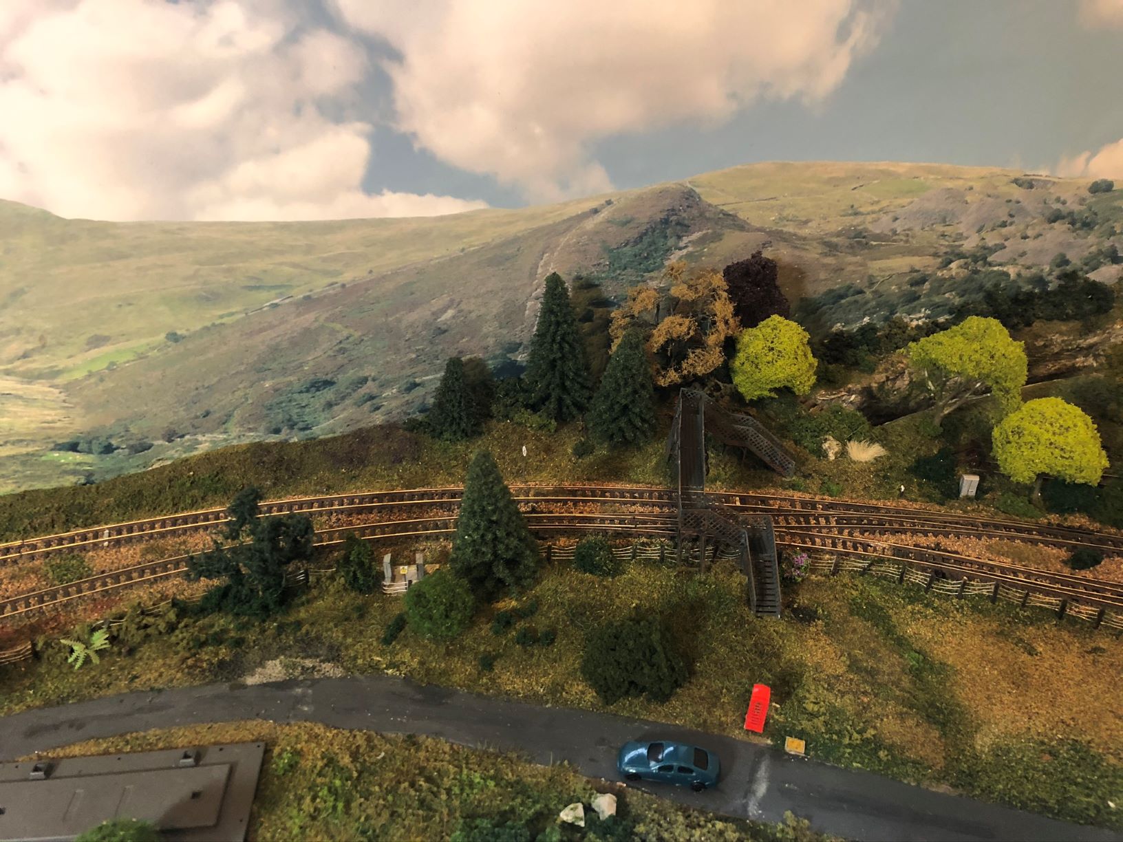

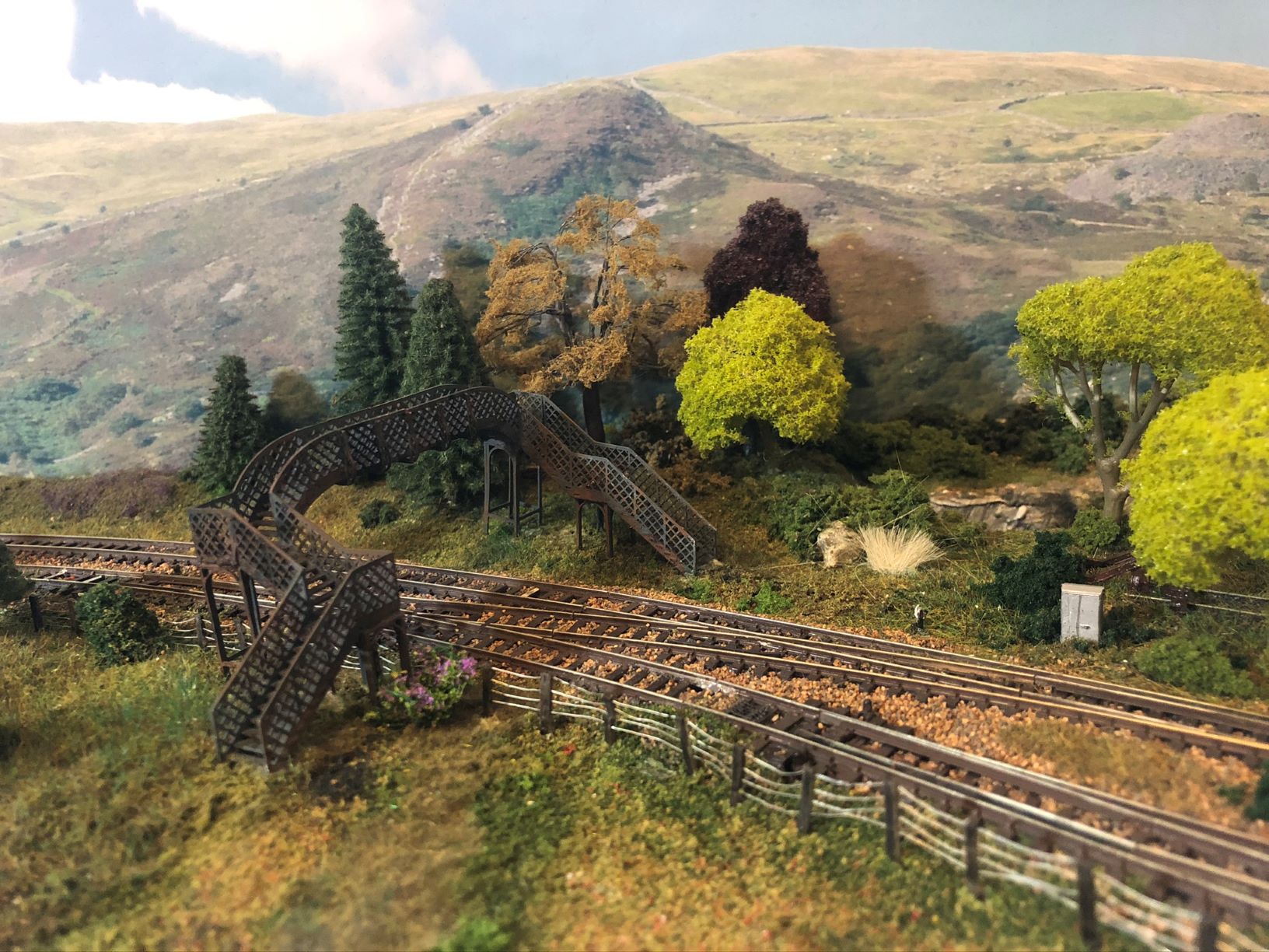

..and the route up the mainline and Tom Na Faire.  Love that bridge from YorkModelRail.  Not quite same as prototype but the right height.  The others I looked at were not a good height & I was not confident making my own (yet!).  Nevertheless, the kit from YorkModelRail takes some patience, feeding each individual step into the frame.
Like the rest of the area, the bridge has seen better days but is still standing.

Turntable will be DCC controlled with a Locomotech motor and when the points switch to the sidings, there will be yard lights that activate - probably infra red, but train-tech has a DCC enabled controller that I may use.
Work in progress, Fort William Signal box area.  Am toying with putting working semaphore rods, but experiments so far have been frustrating. Maybe a step too far.

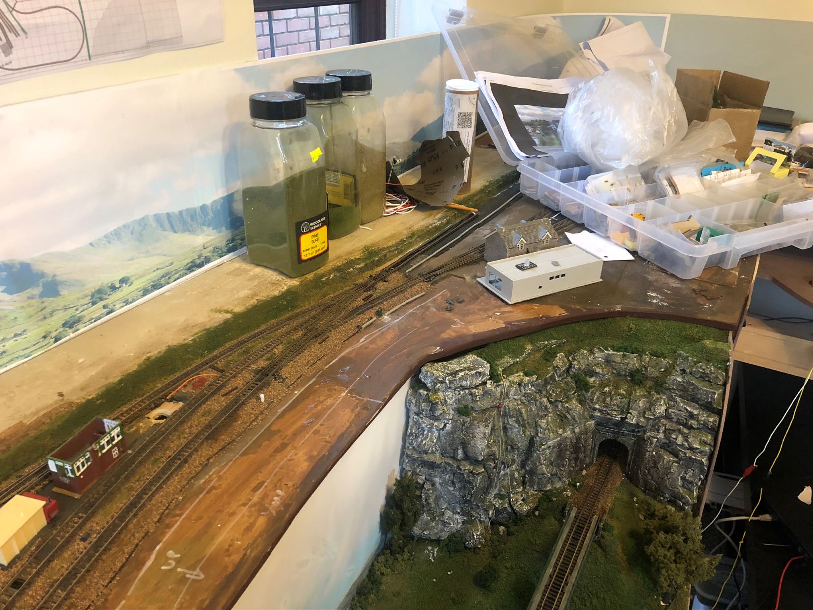

And just to show there is a bit to go for the next years modelling project!
