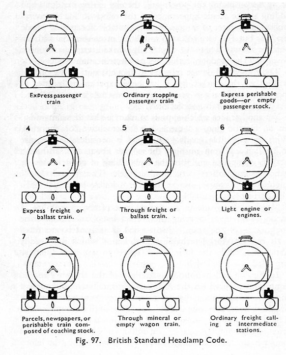

You may or may not be aware I can run stock from 4 divisions on my main layout - WR, SR, LMR and ER. I'd like to put the correct headlamps on my steam and diesel locos for the train they pull but see the headlamps are available in white or red. Could some kind person educate me as to which region used what, and whether they have a temporary (but safe) fix so that, for example, a Black 5 used for mineral traffic one day could be used on a stopping passenger the next day i.e. I don't want to 'force' a loco to do something.
Also, I don't think this list is comprehensive as, not that I'll be running one, but the Royal train for one is missing, and I seem to recall diesels ran the same codes with discs. Is that correct please?

@crewearpley40 Ta muchly for those excellent links.
@Bealman Ta, George. I knew I'd seen 'em somewhere :doh: Only 10 codes though so the Royal Train is not on the list.
Some of my questions answered. Thank, Chaps

Try tack wax for temporary placement; it does work, but won't take direct knocks, obviously.
See also;
https://www.2d53.co.uk/Headcode/headcodeC.htm
but be aware these are the 1962 onward revisions.
Older headcodes;
http://www.igg.org.uk/gansg/3-sigs/bellhead.htm
and scroll down; its after the bell codes.
martyn

@martyn Another great link. :thankyousign:
I use Tacky Wax for the odd pesky coupling.

NPN;
Forgot to add; yes, diesels used the same headcodes for the class of train hauled if they were equipped with discs. I think you probably deduced that from the first link I posted.
A tiny blob of blue tack may work as well as tacky wax, but I haven't tried that. I used to use tacky wax when my locos only ran at home, but now they are used on exhibition layouts, I glue them as I've lost too many lamps or discs...
Martyn

« Reply #8 on: March 18, 2019, 06:01:49 PM »
Whilst looking for something completely different, I also found this, which has a lot of other general information;
http://www.britishrailways.info/TRAIN%20AND%20LOCO%20WORKING.htm
martyn

« Reply #9 on: March 18, 2019, 08:17:05 PM »
Another great resource. Thanks, Martyn
