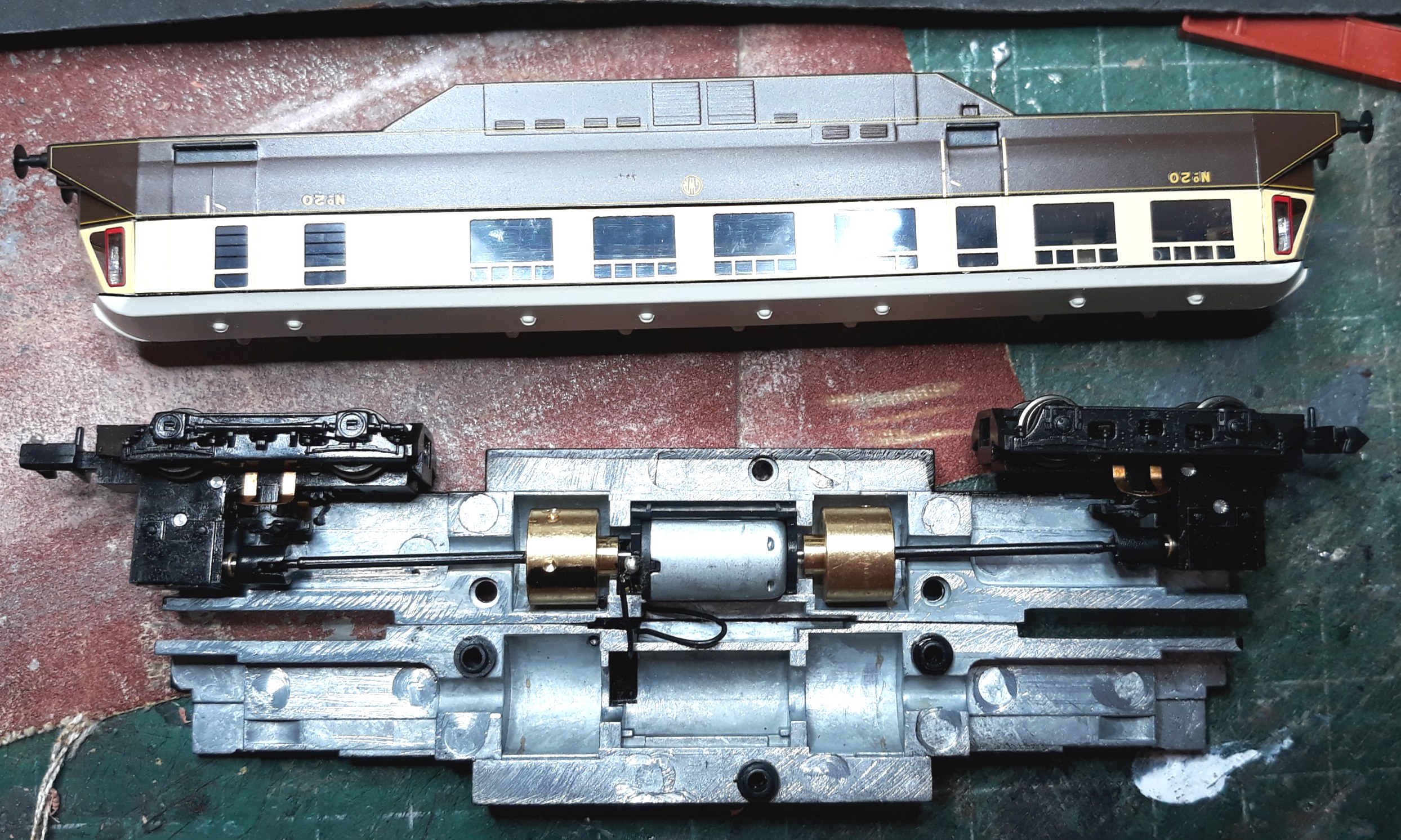

First job is to separate the chassis from the body, this is quite easy, just flare the underside centre of the plastic body and the chassis will drop out.
Take photos as you take it apart so you can easily see how it goes back together again afterwards.

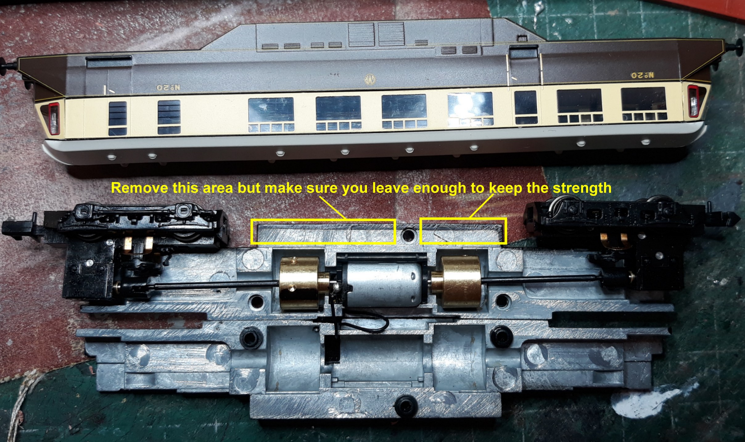

You need to completely strip the chassis into its component parts as you have to cut the chassis with a saw and the swarf will damaged the motor etc.  You will need to unscrew the 2 small screws that wire the motor to the chassis, the screws are very small so take care, you need both of them and the eyelets later.  Hereís the chassis separated by removing the 3 body screws, be careful you donít lose them.
Remove the areas shown in this photo, be very careful you donít overdo it and weaken the chassis too much. Both halves of the casting need removal.

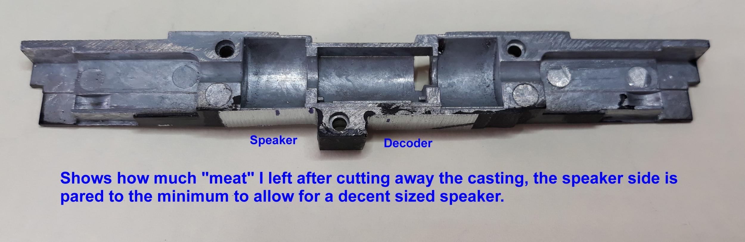

Below is a half chassis to show detail.  A small saw was used to remove the material, it is very hard to cut (son in law to the rescue).

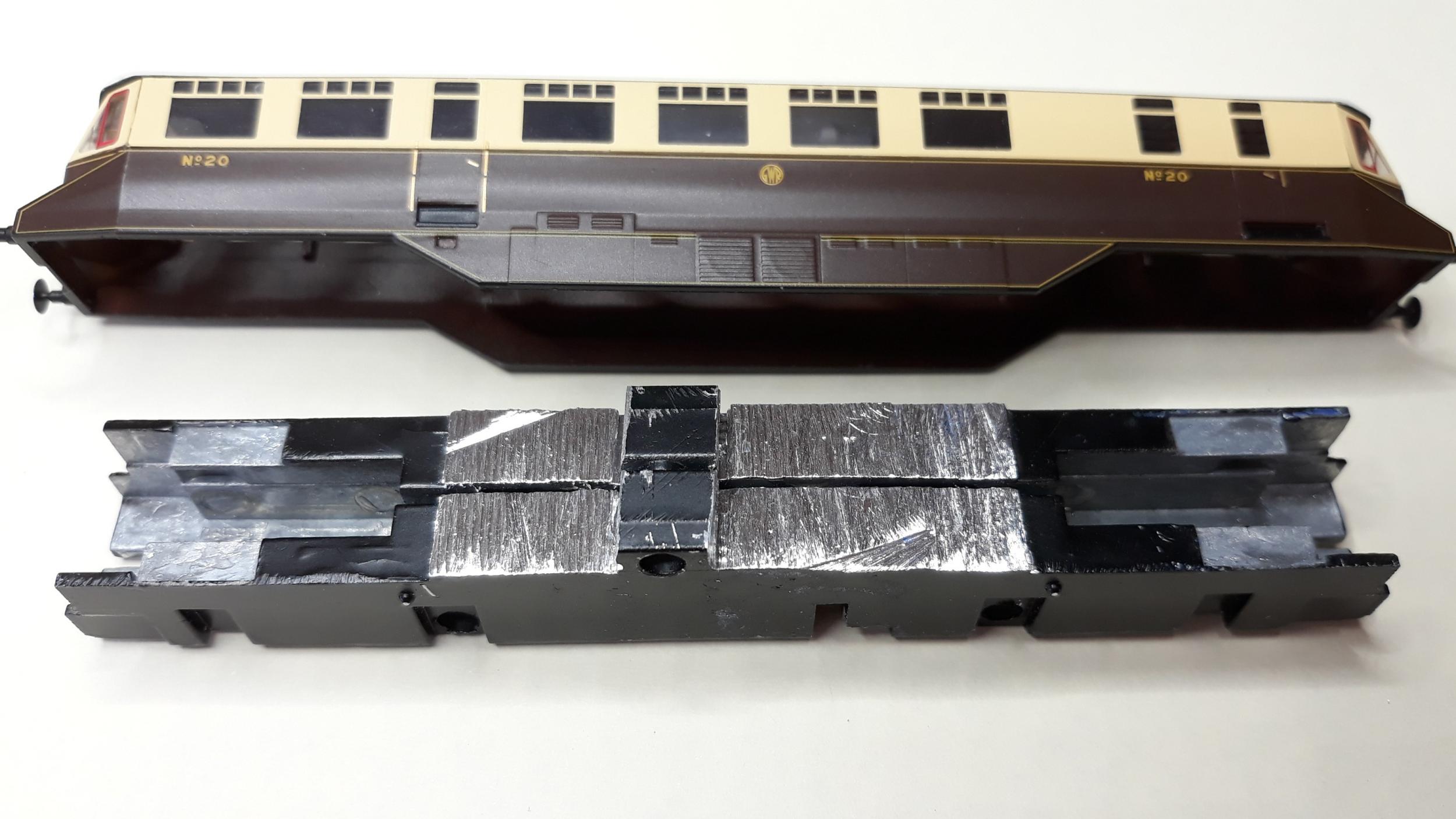

The completed removal

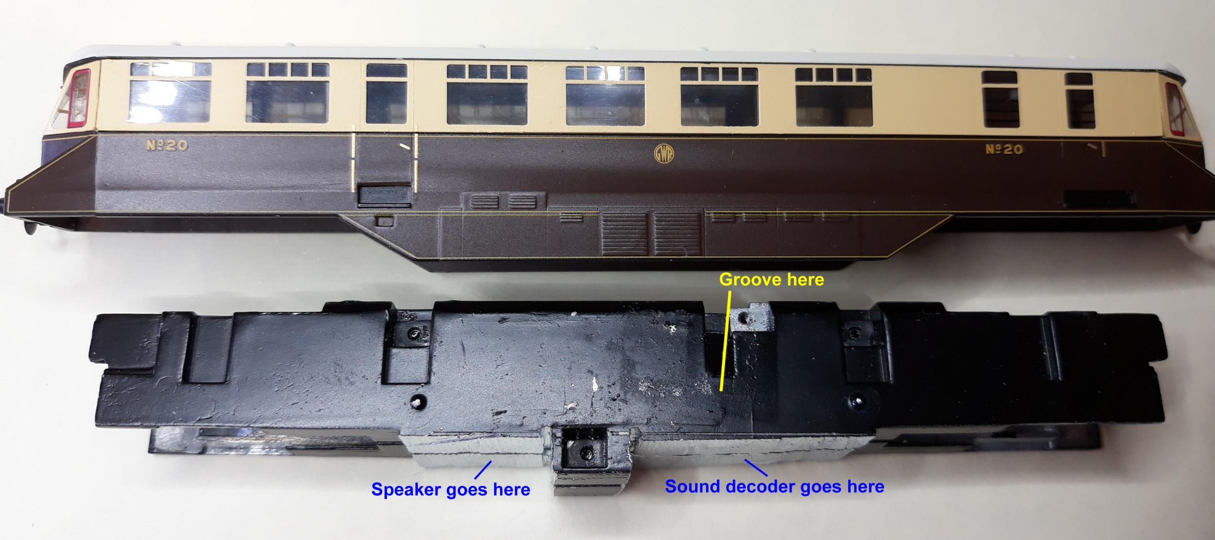

To feed the decoder wires through to the top of the chassis it is necessary to cut a groove either side of the chassis.  This groove is in exactly the same place where the black wires connected the motor to the chassis, see picture below for detail.
I then painted the cut area with black acrylic paint to insulate it a bit.

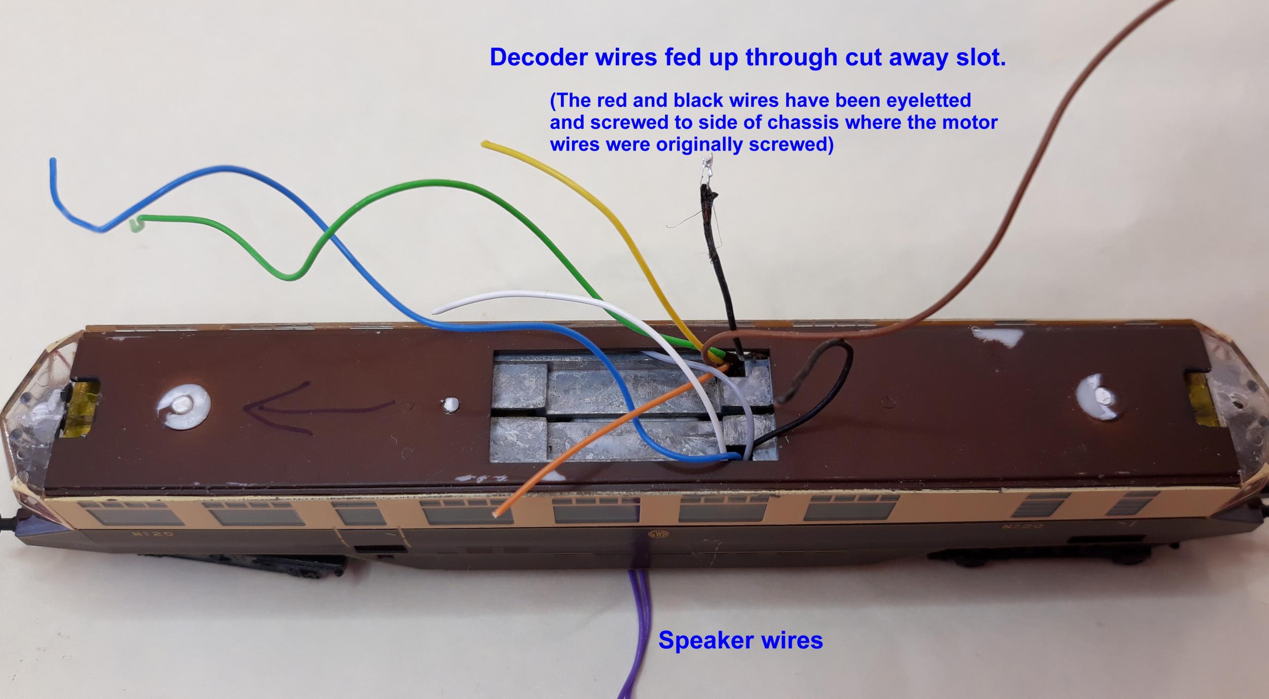

I removed the eyelets from the original motor wires and soldered them onto the much shortened red and black decoder wires and using the original screws screwed them to the chassis as that is the power feed from the track.
The rest of the wires I split into 3 bunches, the purple speaker wires donít need feeding through to the top, thatís one bunch, the other 2 bunches I just halved and put half up one side and the other half up the other side and used Kapton tape to insulate and hold them in place in the groove.
Hereís the wires fed through to the top.

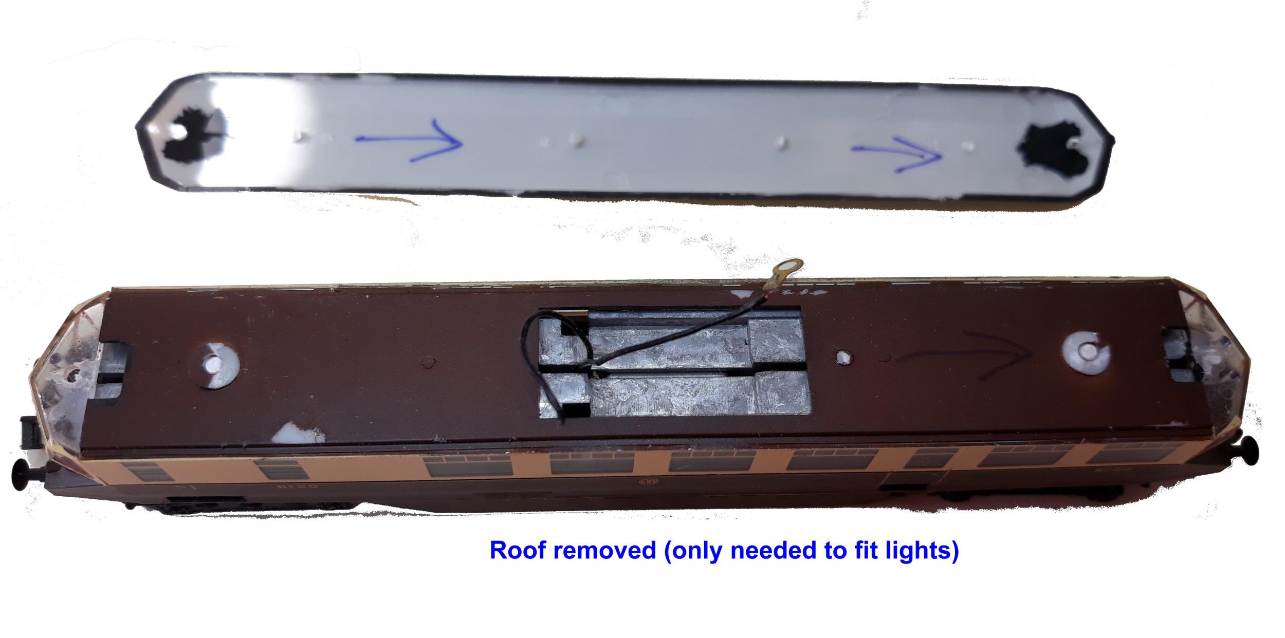

I removed the roof to facilitate running light installation but if you are not fitting lights then you can leave it in place.  To remove the roof (it is glued on) you need a sharp scalpel and slide it between the roof and body to cut the 4 pins that hold the roof to the body.  I painted the underside of the roof near the lights black to stop light bleed
Hereís a picture after removal.

Hereís the underside completed.  Iíve used Kapton tape loosely applied to the metal side of the speaker to insulate from any accidental rail touches whilst re-railing etc.

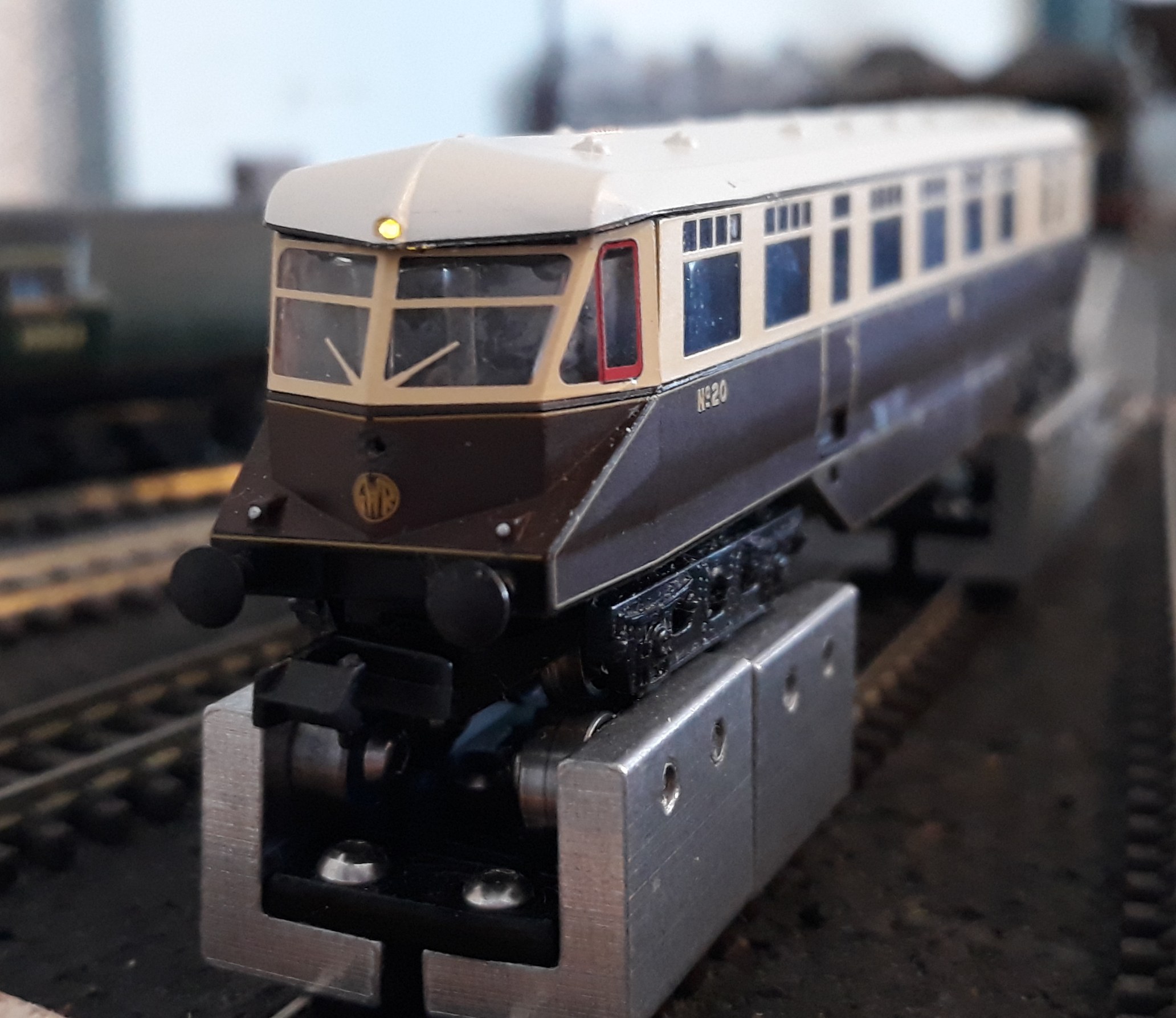

One tested and working, glue the white roof back on making sure youíve painted the underside black to stop light bleed.
The lights should show through as is but I added a small piece of fibre optic glued into each hole to help project the light forward.
Forward running light illuminated
Rear running light illuminated.
