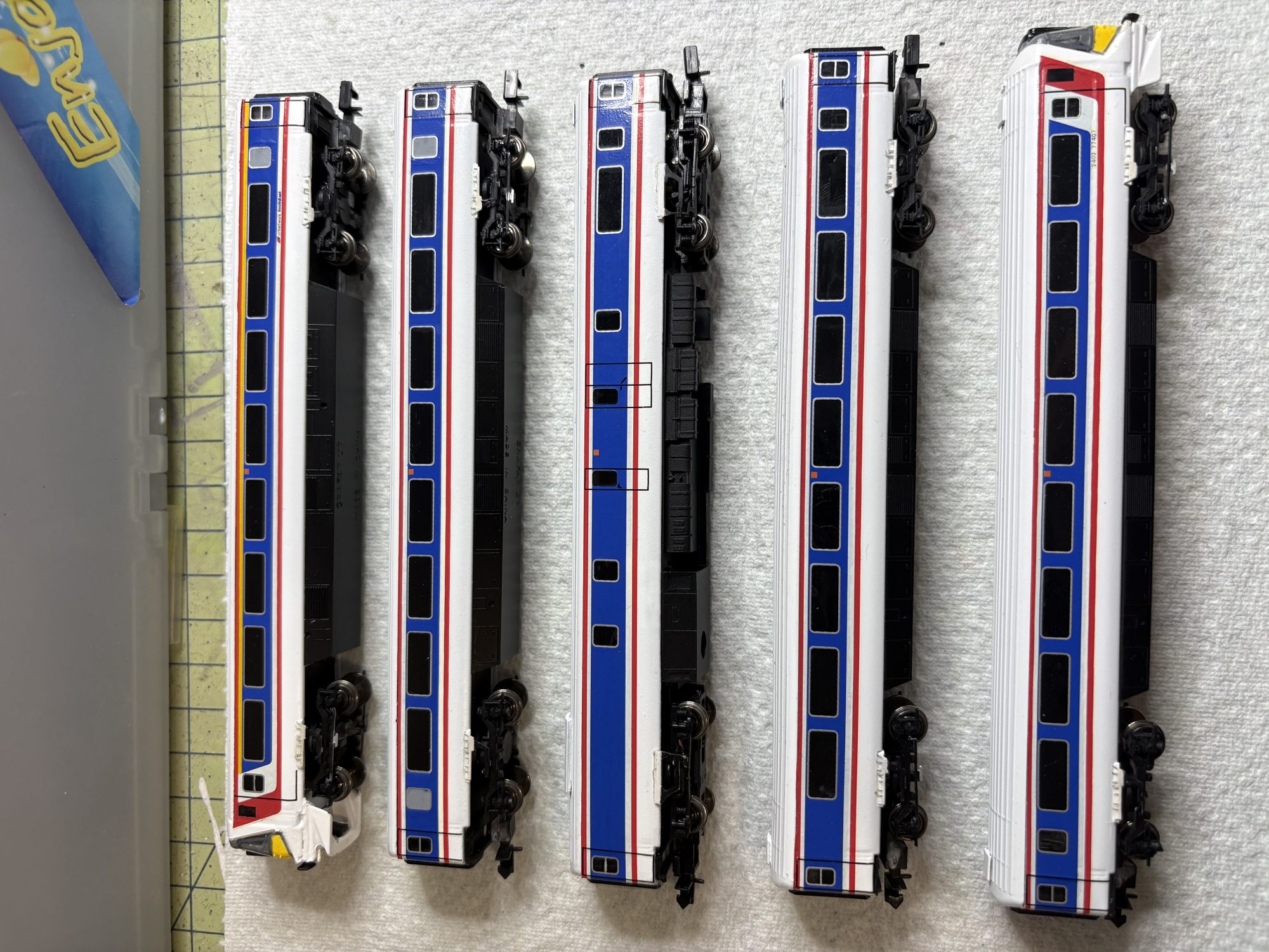

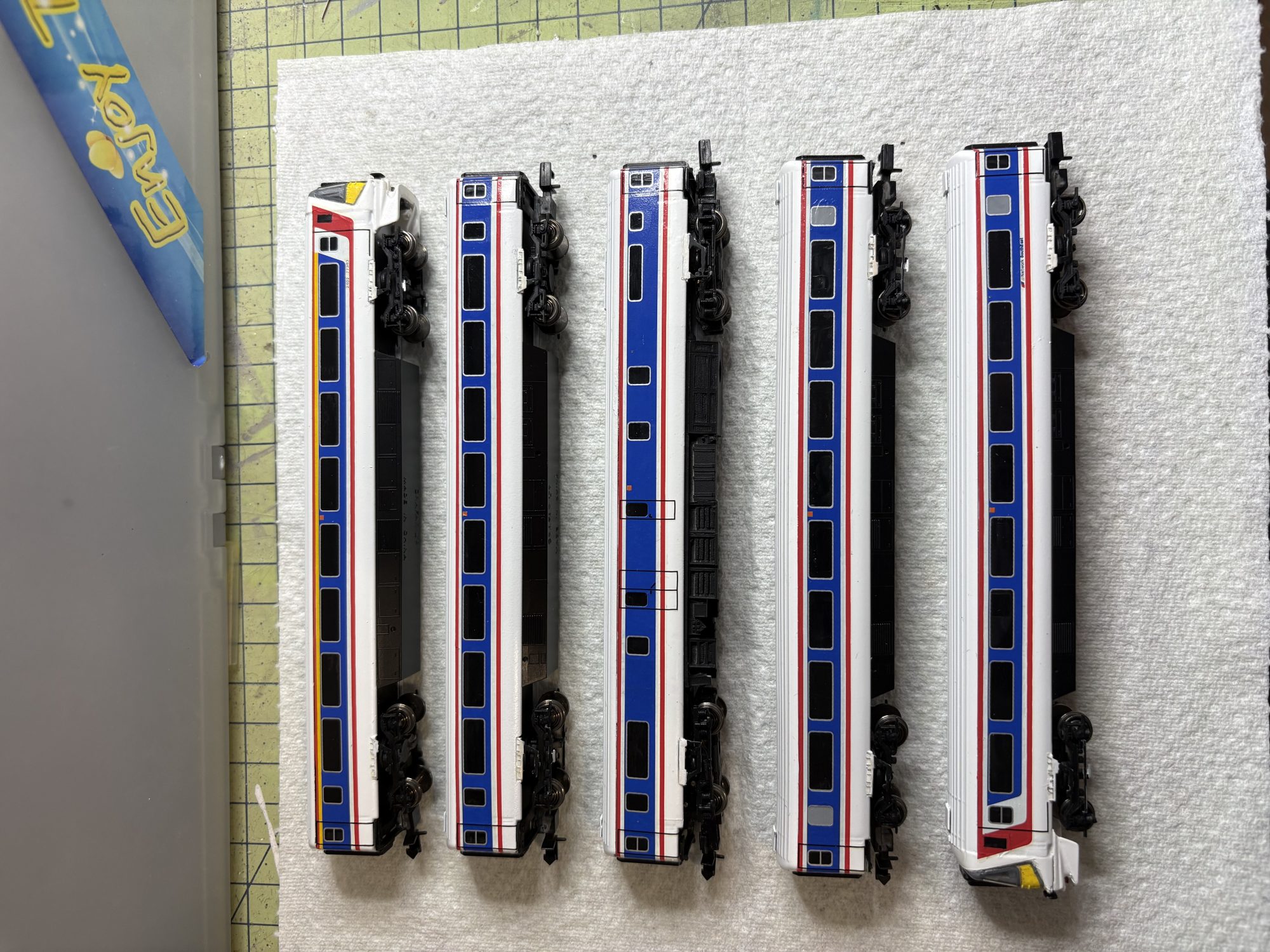

Well it seems that today is the day!
So here is the result of a project that has been ongoing for some time.
A few years ago I found a complete unopened set of TPM parts on eBay and jumped on them.
After a good few months of (not continuous obviously) work, last night I sealed the last decal.
So here is my set "Inspired" by 442402.
As far as I know it includes all the parts TPM ever made available for the set, including roof vents, dummy couplings, etched yaw dampers (marked as CJM incidentally) and pickup shoes.
I have watched a (very good) video on YouTube covering the 442s more time that I care to remember. What on the surface is a relatively simple conversation of old Farish MK3 stock contains all sorts of pitfalls with toilet locations, pickup shoe bogies and yaw damper orientation.
The set is powered using the previous tooling (China built) 158 chassis which is almost ideal, except the bogie moulding dampers are the wrong way round for the 442 ???????????
Skyline2uk
PaulCheffus
Hi
You've made a good job of that.

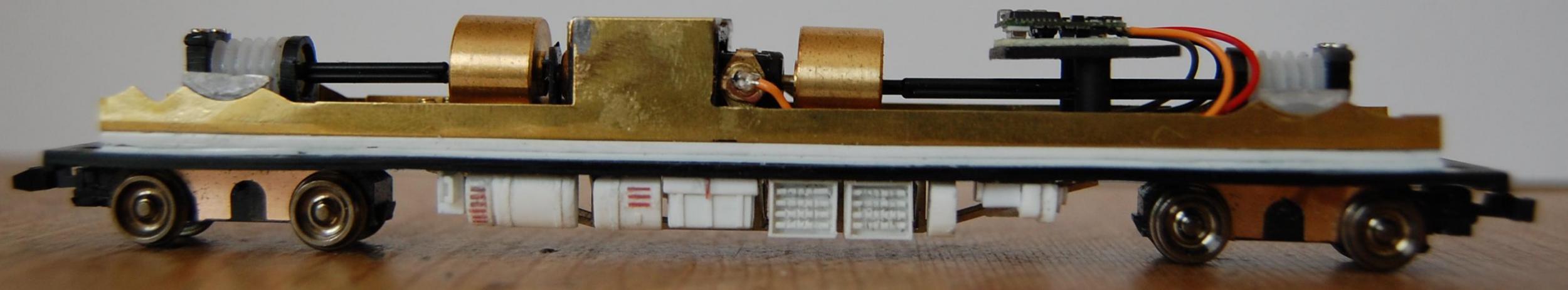

I might finish mine one day which is powered by the TPM MUMU (Multiple Unit Motorising Unit). What puts me off are the transfers and how to keep the windows clear after varnishing.
Paul
Workbench thread
Skyline2uk
Quote from: PaulCheffus on Today at 04:26:45 PMHi
Paul
Thank you Paul.
Now the TPM chassis is one thing I have NEVER seen, so would be interested in that.
Ref the varnishing: I used Microscale "MicroSatin", slightly diluted and simply brushed on the entire model.
It is remarkably forgiving and dries totally clear.
Skyline2uk

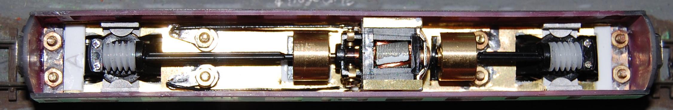

PaulCheffus
Hi
This one is from my 4CIG and is missing the bogie side frames
Paul
