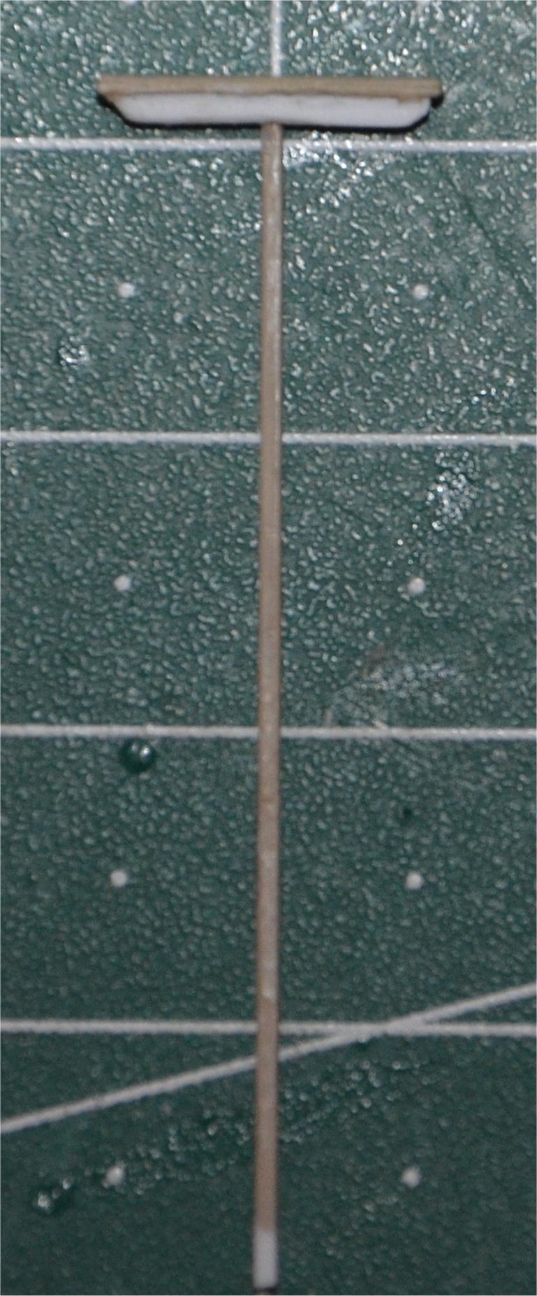

Construction of station platform T lamps

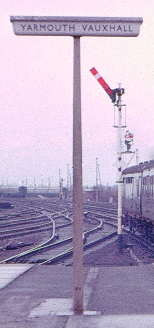

A prototype T lamp at Yarmouth Station
These lamps only cost a few pence each and are very easy to make

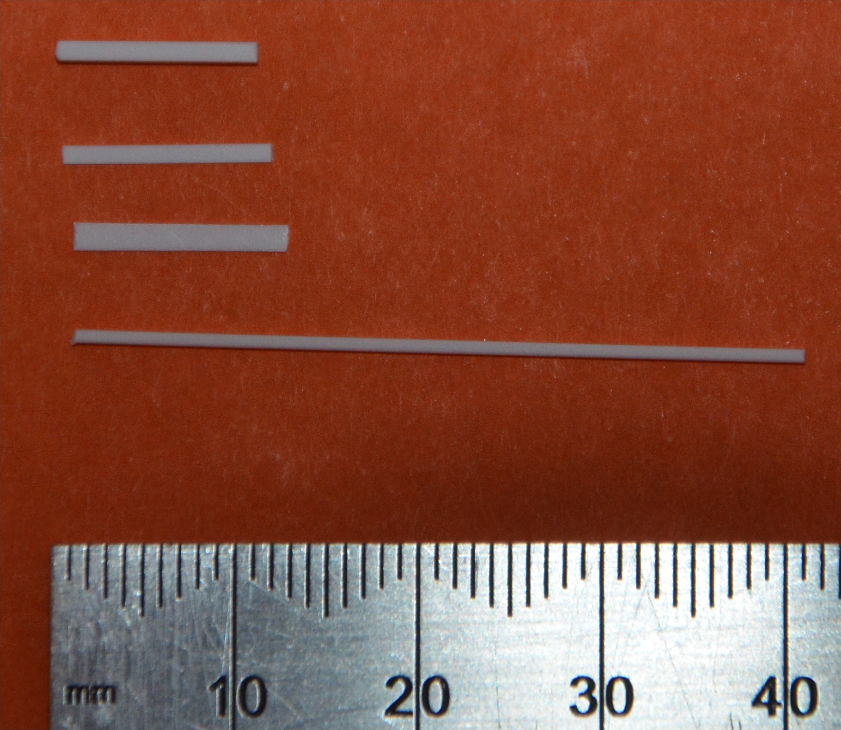

The 4 pieces of plasticard cut to length

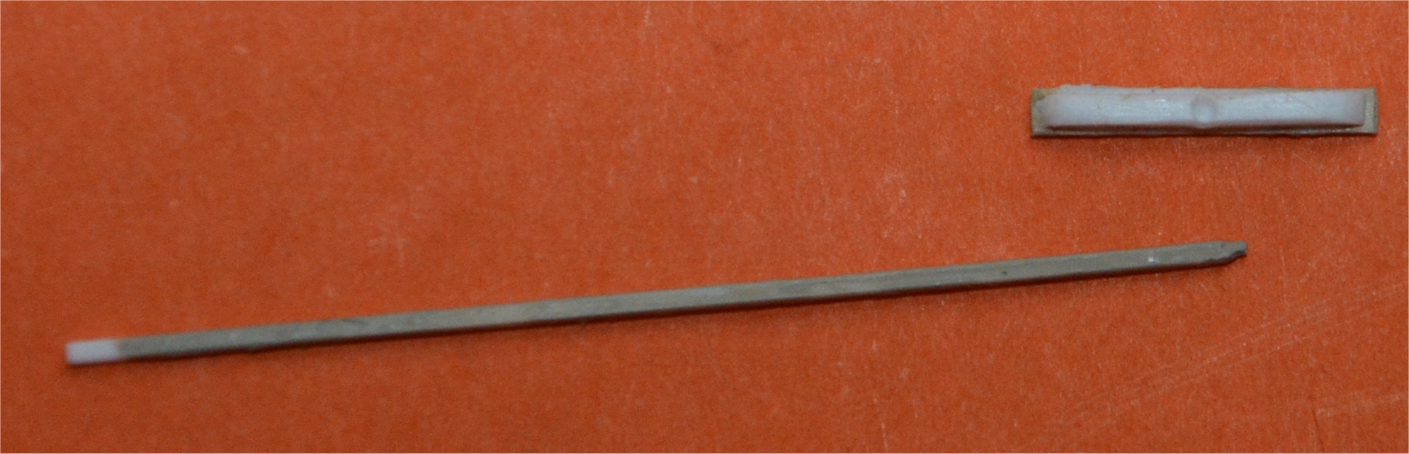

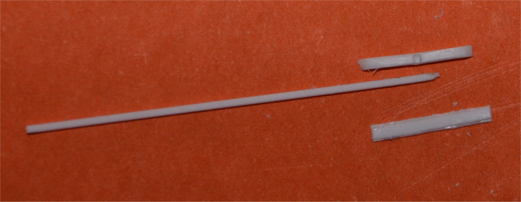

Hole drilled in lamp, the two strips have been glued together and the end of the post has been reduced in size to fit in the hole
Lamp glued to the top
Gluing the lamp to the post ensuring it is square

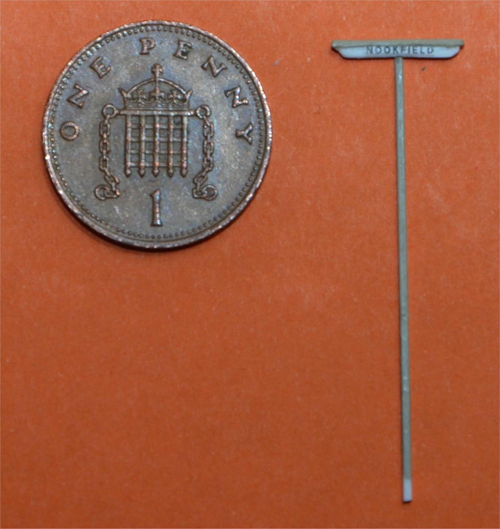

Station name NOOKFIELD applied. This was only the second T lamp that I made.
Obligatory picture next to a coin to show the size
