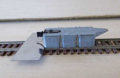

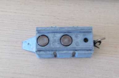

Here is a picture of the coupler gauge I mentioned. It sits between the rails and the left hand side has a reference coupler and a piece of metal sheet to sit across the track to set the trip pin height. The right hand side sets the height for the underbody mounting and the underside has some magnets that assist you in fitting the decoupling magnets between the rails.

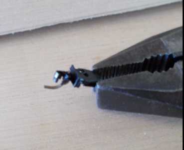

Here is a 1023 Coupler (purchased as an assembled coupler)

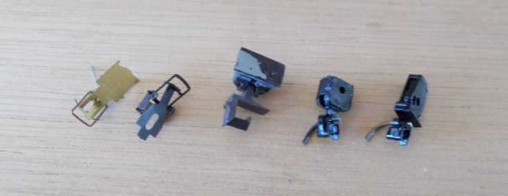

...and finally here is a selection of couplers. From left to right they a DG, BB, Rapido, MT1027, MT1023
