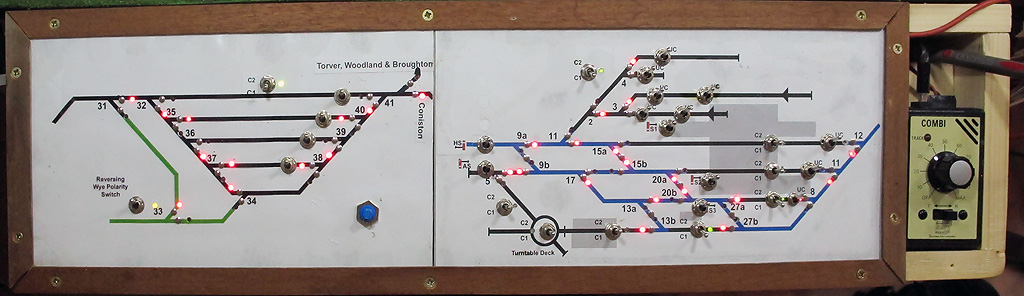

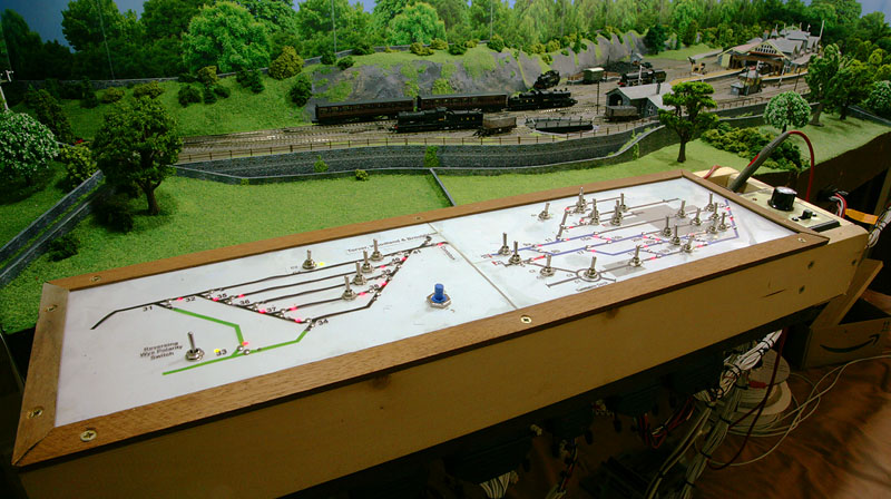

Still, the build is now finished. Having received the switches that I was awaiting, I've now completed and installed the Mk2 Control Panel;
Here's a view of just the control panel;
The switches with LEDs beside them are for isolated sections, which may be controlled by Controller 1 (the default and which controls the rest of the layout), Controller 2 (for if I wish to conduct movements independently of a train being worked by Controller 1, for example shifting stock around in the fiddle yard) or, simply, off. All are DPDT centre off switches, one set of poles being for the track power, the other for the LEDs which light green for Controller, red for Controller 2 or off for no track power.
The switches with signal symbols beside them are for, well, signals. These are DPDT centre off sprung one way switches. One set of poles is for switching on the signal solenoids, on the sprung throw only so I can't leave a solenoid on by mistake. The other poles short out a diode connecting the track section immediately in advance of the signal post, on both throws. This means that a train may pass the signal from the rear at any time but may only pass it from the front if a) the signal is clear or b) the switch is set to the testing (playing) mode.
The switches labelled UC are for the uncoupling solenoids, these are SPST sprung switches. I opted for these because I wasn't keen on the pushbuttons that came with the solenoids.
The points setting LEDs are controlled by relays, triggered by the pulses from the studs and probe for changing the points.  Being latching relays, when I power up the layout all the indicators show the points settings immediately - provided I haven't been fiddling with the points while it was powered down of course.

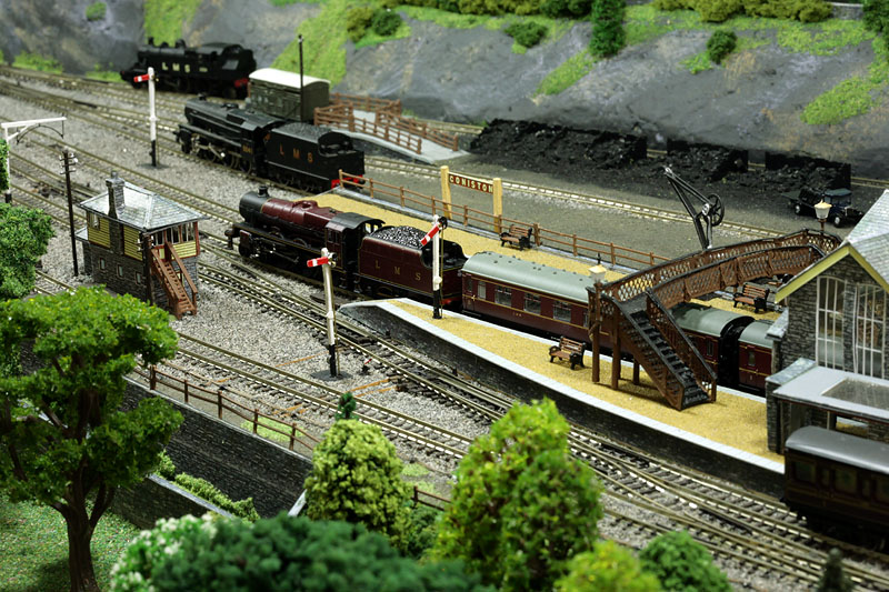

Jubilee 5664 Nelson is at the end of platform 2, waiting to depart with the return excursion from Blackpool;

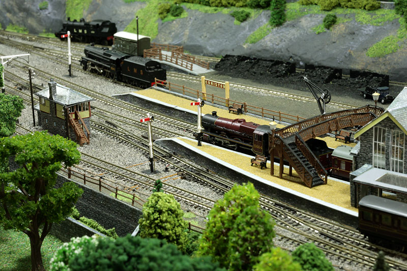

Meanwhile, at the southern end of the station, nothing is happening;
Ah, the starter has come off and Neslon can depart;

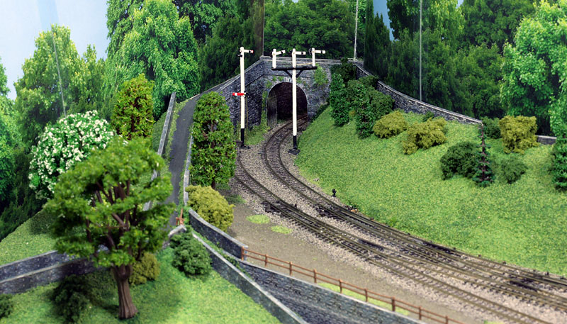

Since the advanced starter is also off, Nelson may proceed into the single line section;

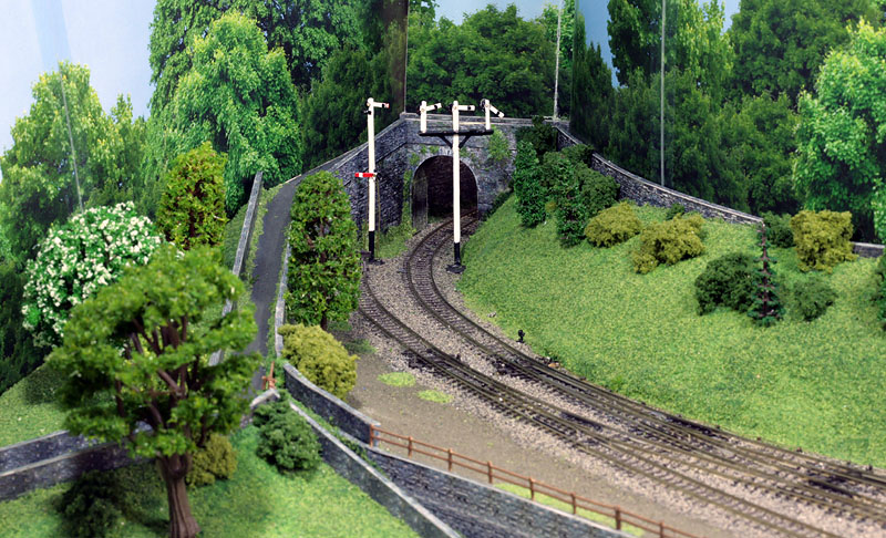

Still at the south end of the station, the excursion must have passed Woodland now because the home signal for an arrival into platform 1 has been pulled off;

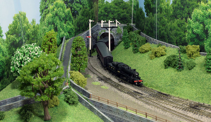

and Ivatt 2MT (Mickey Mouse) 6404 arrives with the local passenger service;
The four home signals are, respectively from right to left, for arrivals into platforms 1, 2 & 3, on the 3-doll bracket post, and into the goods loop, on the reverse of the post with the advanced starter. However, due to lack of space under the board I've only been able to make the advanced starter and the platform 1 arrivals signals work. The rest are fixed, although it rather looks as if the platform 3 one needs fixing better ;-) I'll do that when I add the ladders to all the signal posts.

I'm pleased with the control panel, but I learned one important thing when assembling it - don't make the darned thing so narrow and deep. It's only about 6" wide but 3" deep at the front, tapering out to 7" deep at the back with the circuit board for all the relays and the connectors for the cables out to the various baseboards on the bottom. Fishing for and fitting all the wires gave me a good impression of what it must be like for a surgeon who has to perform surgery on the front of a patient's spine but has to go in through the belly  :D
The ones for Torver, etc. will be of similar style on top but far, far, shallower ;)
Something I forgot to mention before - the blue "thing" near the middle of the panel is a brightness control. I found that as evening draws in, the LEDS on full brightness were way too bright so I added a potentiometer into their power feed so I can turn them down and see the point operating studs again.

Chrism - May I ask what you made the control panels from? It looks like a white panel board or hardboard? How did you print the labels on there?
Hogwarts to King's Cross - My layout under construction: http://www.ngaugeforum.co.uk/SMFN/index.php?topic=43358.msg536504#msg536504
Offline chrism
  • Trade Count: (+1)
  • Posts: 1643
  • The Coniston Railway
Re: Coniston
« Reply #415 on: September 17, 2019, 10:40:34 AM »
The base of the panels was thick plastic (although for Torver, etc. it'll be 3mm plywood coz I've run out of that plastic).
On top of that is the mimic panel layer, designed in Photoshop and printed onto decent white card.
Finally, I topped them off with clear plastic - actually old OHP slides that I happened to have.
I firstly used a sacrificial print of the mimic panel to mark where the holes needed to be drilled for the point changing studs, LEDs and switches, then drilled all the holes in the backing sheet. Then I offered up the real print, checking alignment with a bright light behind so I could see where the holes were, and glued it down. Then I glued the clear plastic on top before punching the holes down through the clear plastic and card into the drilled holes - again, with a bright light behind so the holes showed up - then opening the ones out for switches with a scalpel.
After fitting all the studs and switches then came the "fun" bit - adding umpteen yards of multicoloured spaghetti to, hopefully, the right bits. I don't think I did too badly to be honest - out of all the wiring to be done, I only got two points' indicator LEDs the wrong way around first go, indicating left when the point went right  :-[
