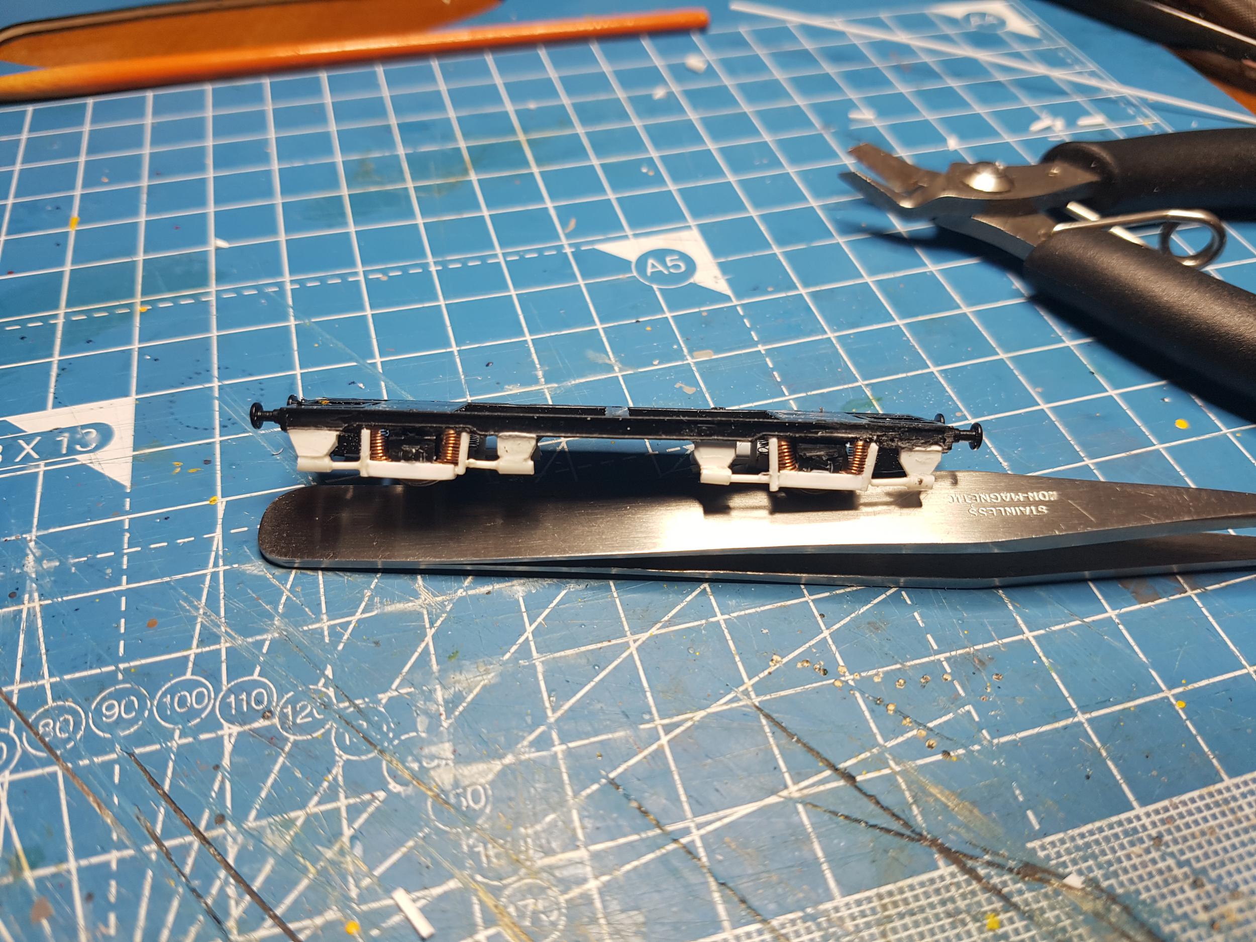

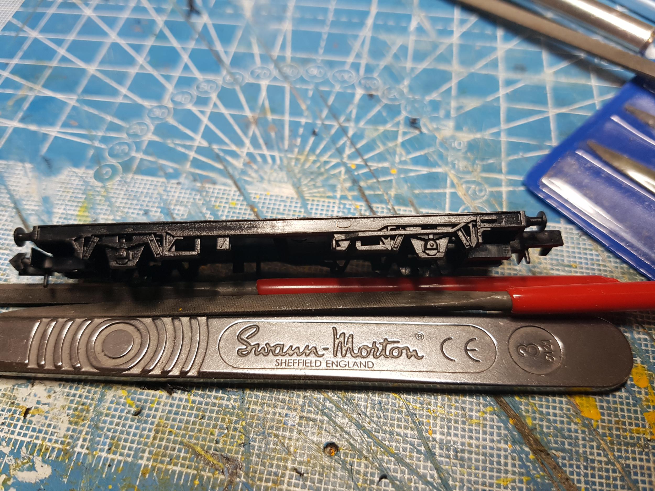

So here's some pictures showing my attempt, so far, to model this wagon. Starting with the donor chassis:

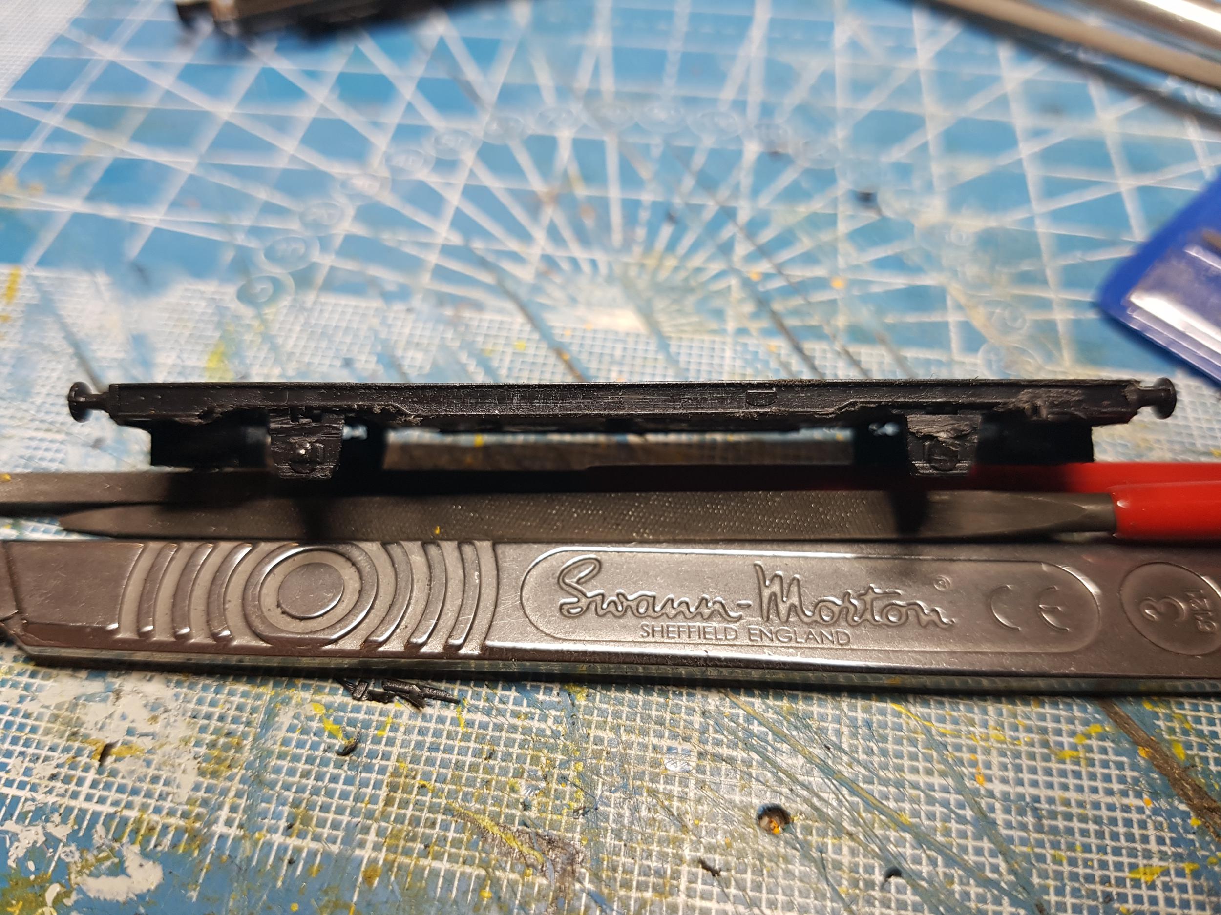

Suspension trimmed ready for my attempt at HSFV1's ''unique' suspension:

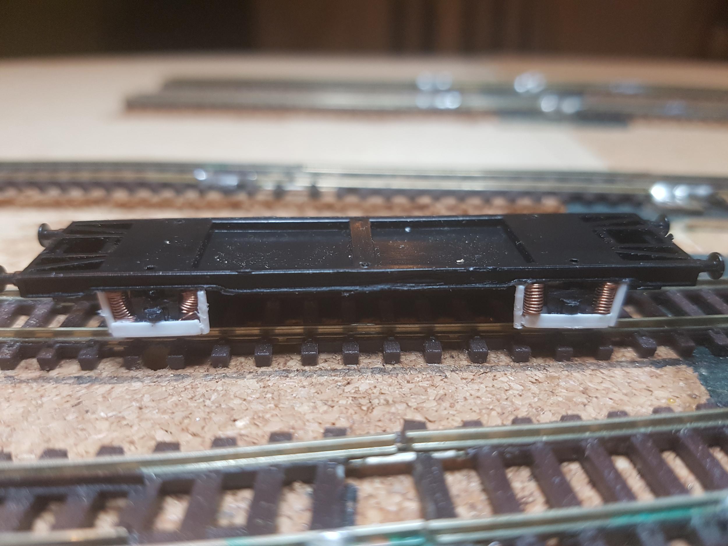

Now with Springs and Dampers added:
And finally the current state of the wagon with Tie-Rods added:
So next is to add the weights, which look scrap rail and it's this point where I need to decide do I use rail from N Gauge Track or Evergreen or Plastruct 'H' beam?? If I use rail it might be too heavy but looks better or Plastic 'H' beam which cuts down the weight but doesn't look quite right  :hmmm: :hmmm:

Hi
code 40 rail would be the way to go ! solder together for strength - drilling the ends for the through bolts would not be fun.  Would a 3D print offer a way out, and count me in for some for an ideal rainy day/ week project
