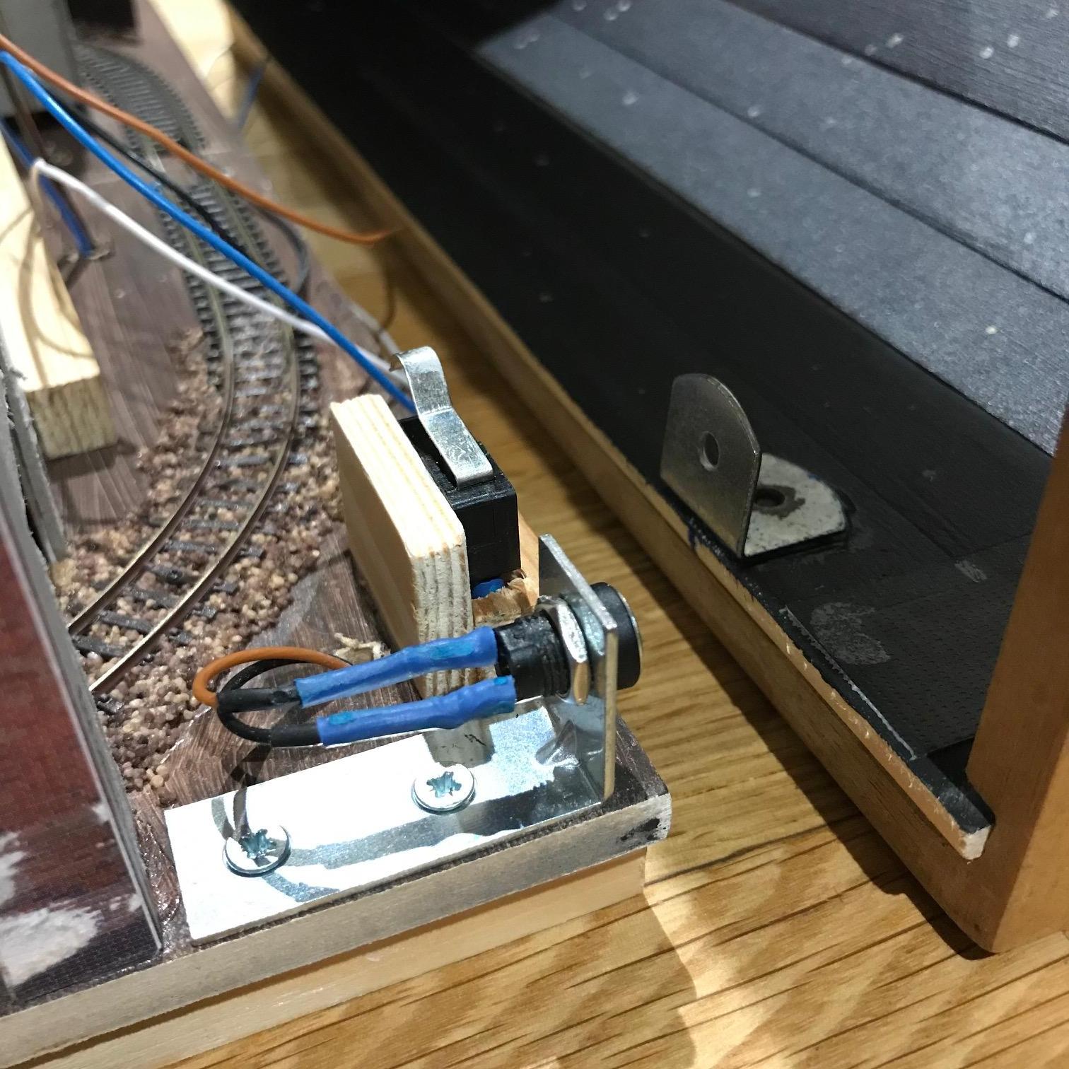

Wiring has started. I’m waiting on a Plug and socket for the controller but the power feed is in. In the end I decided it was much easier (and cheaper/more practical) to go with mains power. Everything will be fixed to the baseboard so that the body of the bread bin can always be removed. The picture here shows the power socket and the micro switch that will turn the lights on and also allow power to the track. A “master switch” if you like. The L bracket on the sliding lid in the background is what will activate the switch so it will only work when the lid is fully open.

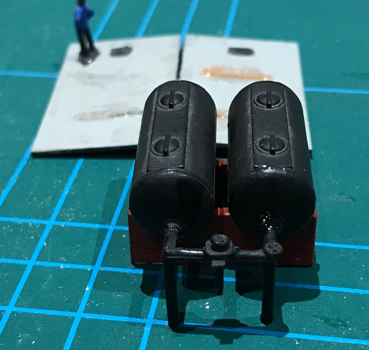

I’ve also been working on a few small bits and pieces to populate the yard to add interest. I found a ratio tank kit ready built in the local model shop for a couple of quid so I picked it up and have bashed it a bit to make it smaller. The grey base in the background here is the original size which was much too big for the small yard;

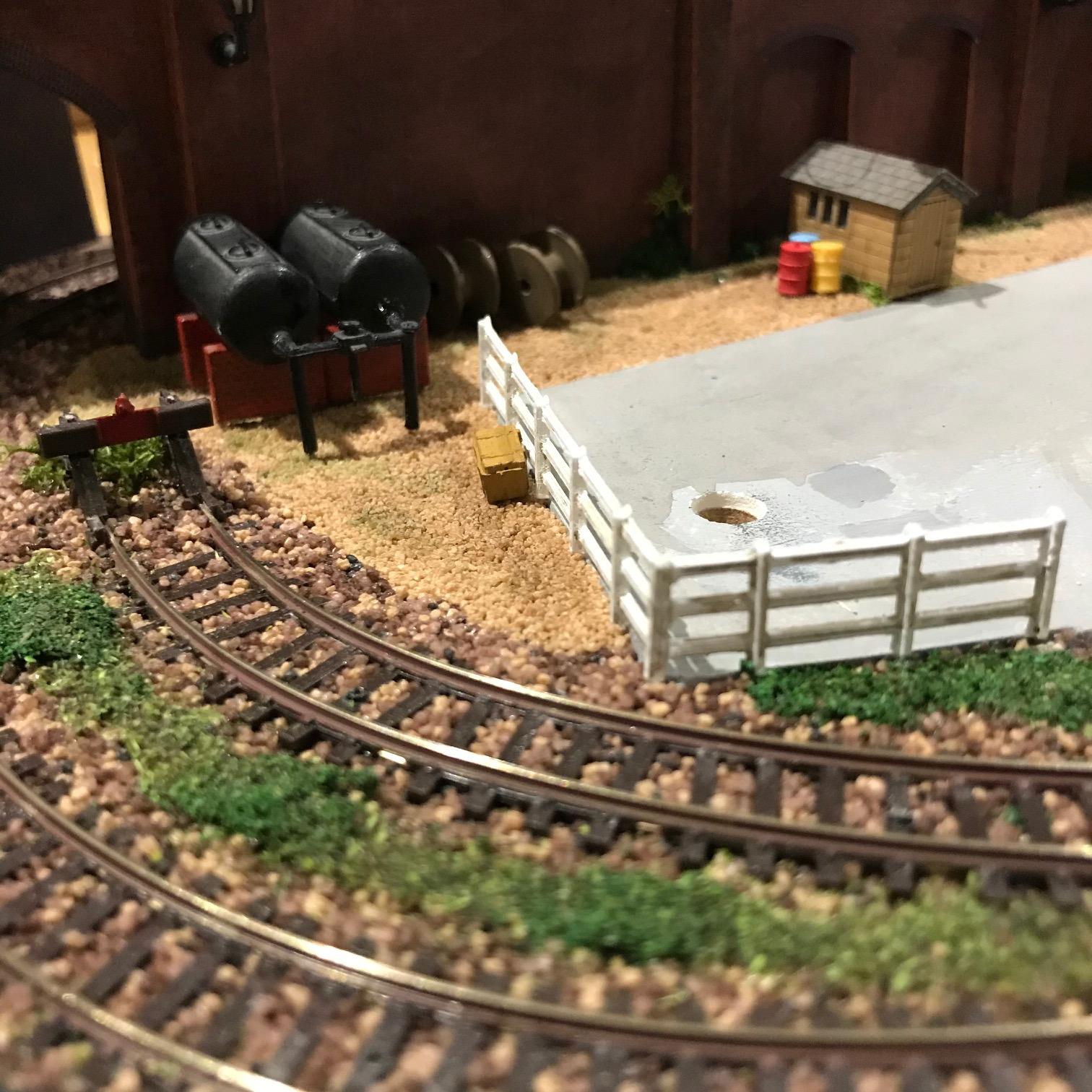

They fit much better now in the little space that will be visible through the side of the main factory. Here you can see them along with some cable drums and barrels beside the shed. I don’t like the colour of the barrels but I like the idea.
