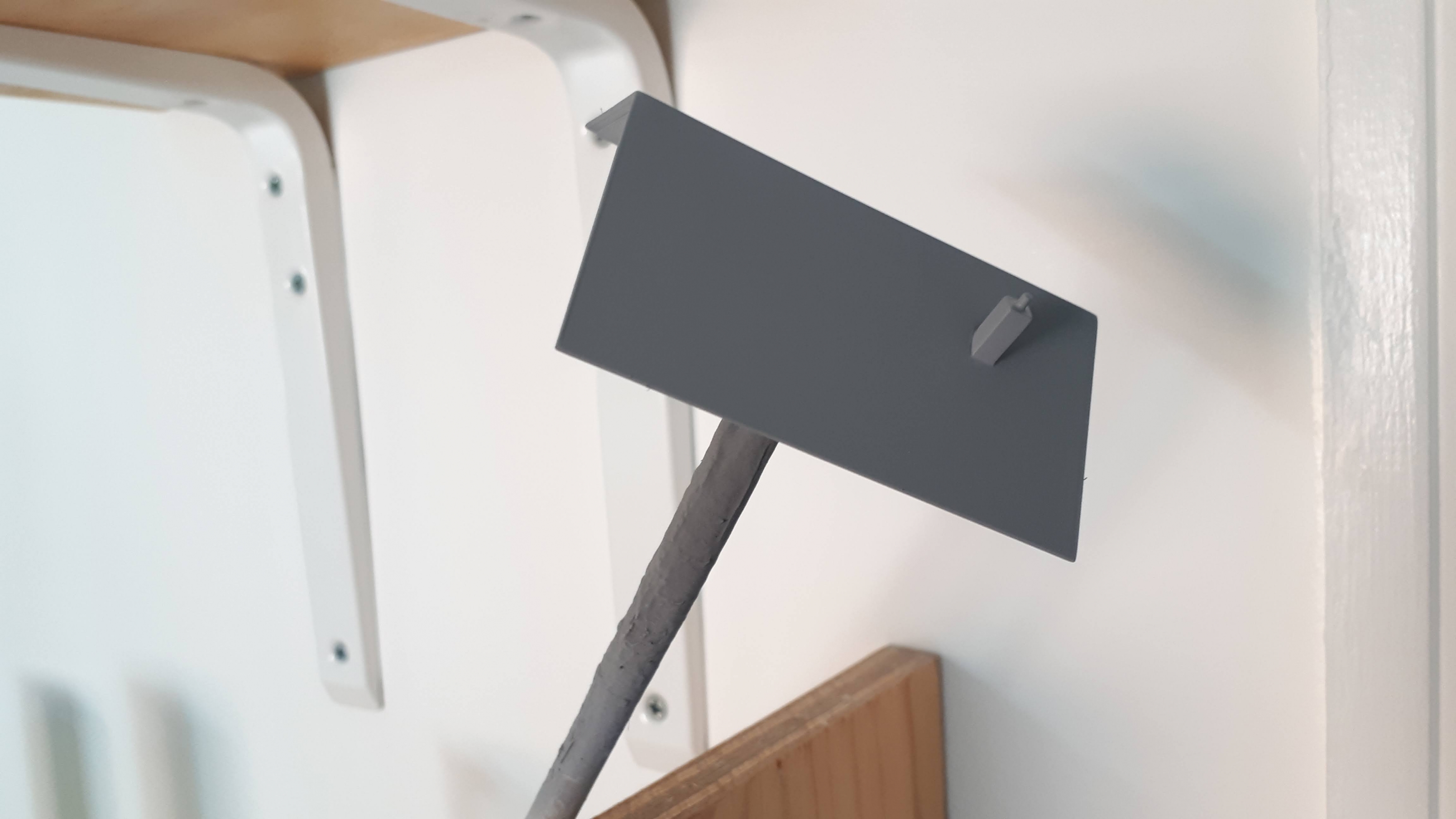

The past fortnight has not been that exciting in terms of progress. Almost all my attention has been focused on the art of spray can spraying.
I had resprayed the new roof of the farm a while back, as I was unhappy with bits of micro dust which had settled on it in the middle of spraying (which I have to do outside). I've now found the remedy is to keep a lens-cleaning air blower and a small paint brush handy as I spray.
After doing all this, the new layers of paint then had a rougher finish than the other roofs on the layout, which annoyed me. This was because I had been spraying with the last paint in the can, and I didn't realise the nozzle was slightly clogged. Hence a very mat texture a bit like fine wet or dry. This did not match the barn roof, which was meant to have been built at the same time and in the same way.
So I took the whole paint job off again with wet or dry. Meanwhile Hobbycraft had run out of the desired paint of course  :D Anyway, when I could resupply I gave a fresh paint job with a new can, using the small paint brush to remove stray bits of micro dust landing on the paint.
I am now completely sick to the back teeth of spraying the farm roof  :smiley-laughing:
However I have learnt a heck of a lot about spray can painting. I'm now soaking the can nozzles overnight in iso to clean them properly.
