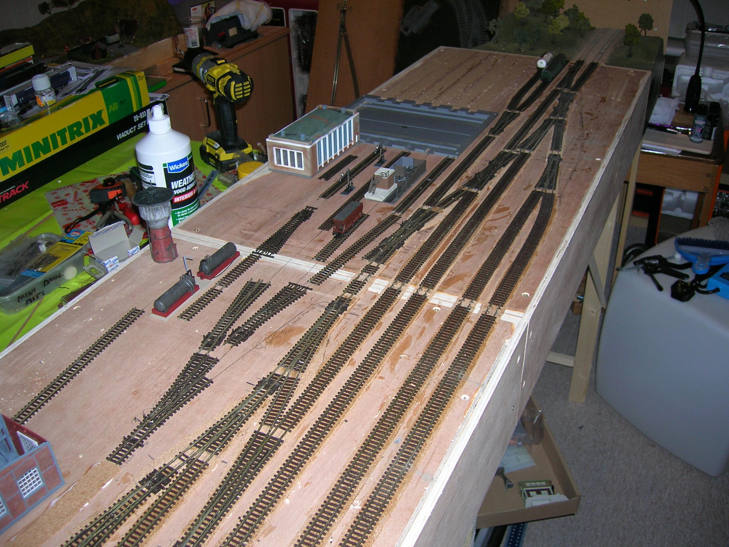

Wherever you source the cork I'd recommend you cover the baseboard with it. My reasoning is that you'll need the cork under buildings, platforms etc as well as the tracks so you might as well go for full cover and just trim away what you don't need.
You could buy cork tiles from your local DIY shed or one supply I've used in the past as have others is....

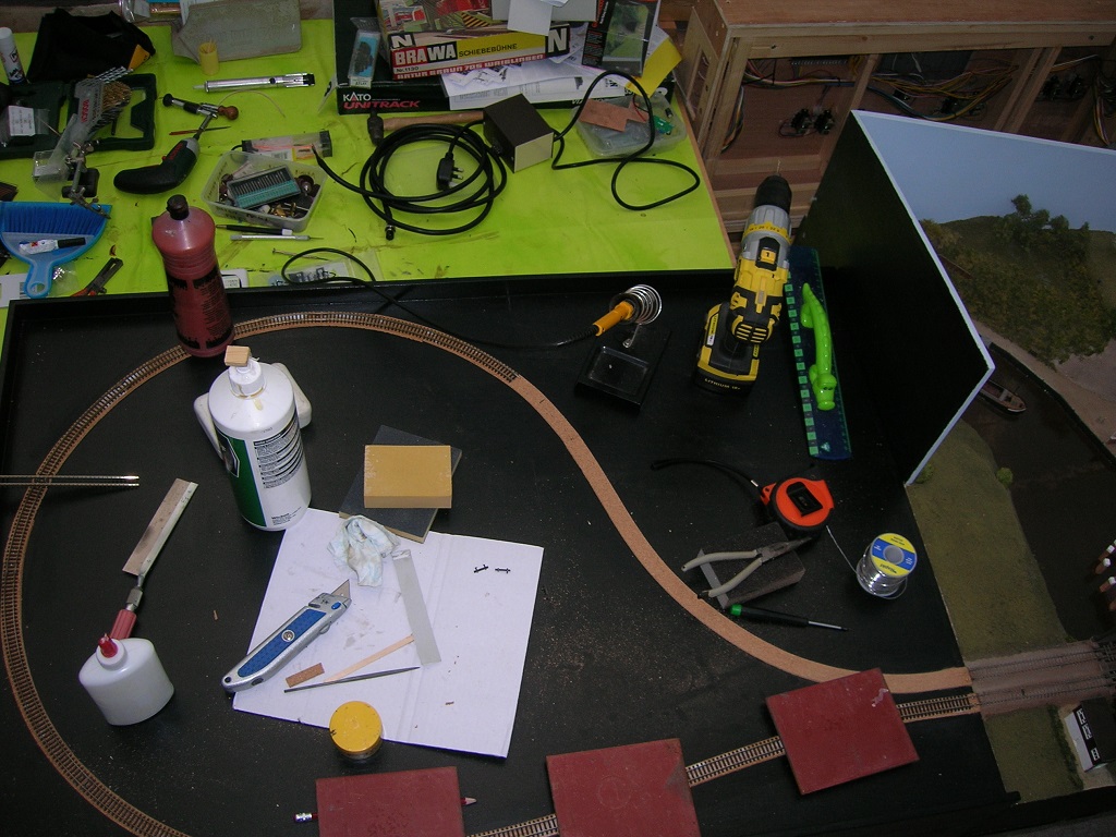

@Newportnobby  ... whereas I would always recommend DON'T cover the entire baseboard, it's a total waste of cork!!   Certainly you'll need to use a few rectangles of cork under lineside buildings that need to be set at the same base height as the track, but you don't need it under the general town buildings, roads, scenery etc.  Use it only where needed.
You don't need to use a single wide strip for double track, use 1" wide strips under each track.
For curves use 2x 0.5" strips either side of the centre line, as that's easier to bend round the curve.
The last batch of cork sheet I bought was from an ebay seller with a name something like "The Fridge Magnet Shop".  2mm thick if I remember correctly.
With the thin strips you get nicely raised track and a ballast shoulder, if that's the effect you're looking for?

There are 2 ways to look at it. If the cork is sourced cheaply enough then I'd go full coverage. If it ain't cheap your way is the best way.
