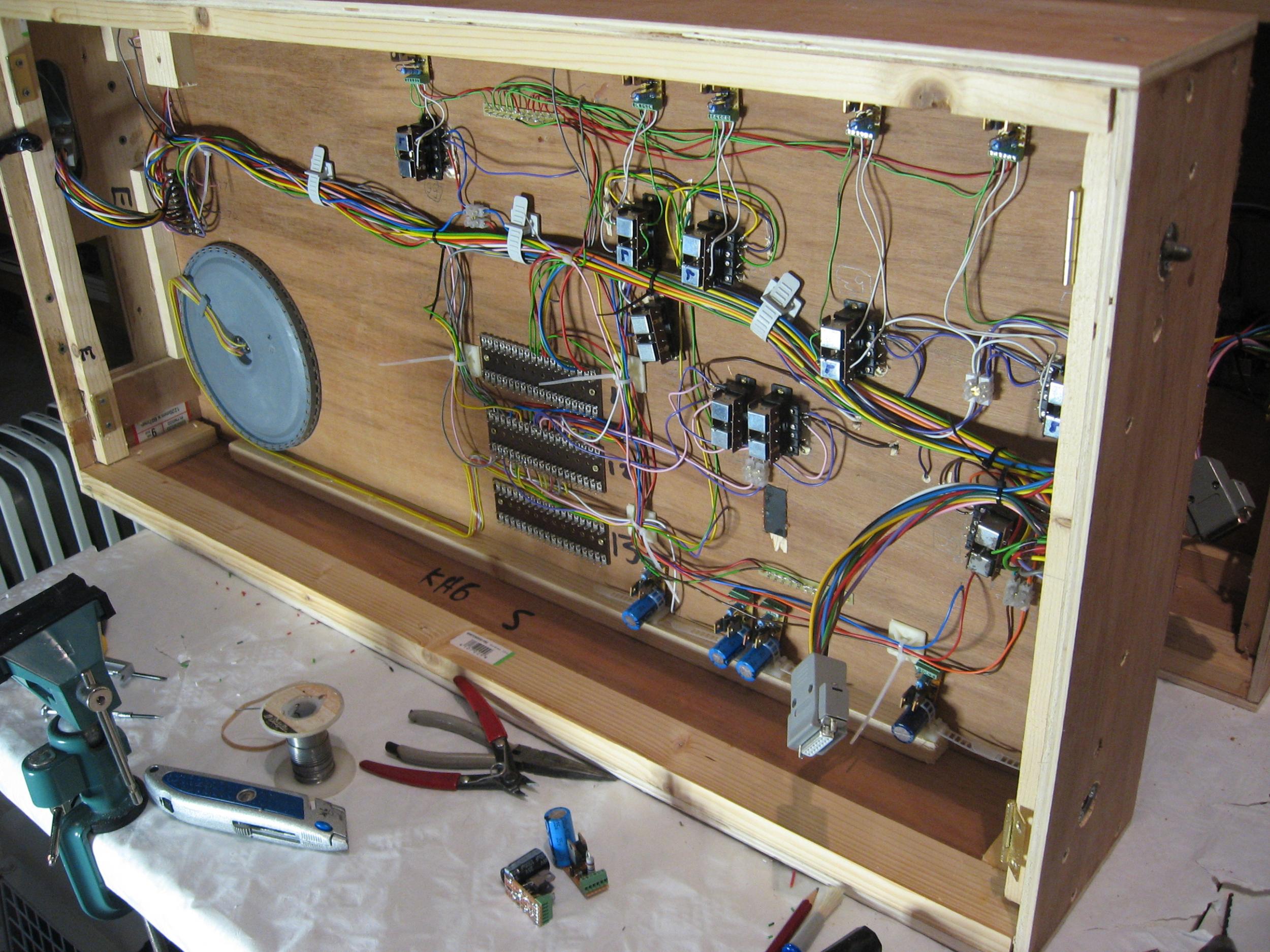

Personally I'd use 9mm ply rather than MDF, it's easier to work with, takes screws, pins and glue better.
25mm depth WON'T be enough to accommodate a Peco point motor on an under-board mounting plate, especially if you plan to use accessory switches.  Going by the dozens I've installed over the decades, you need 40mm.
You might as well use ply for the frame as well, and create a "box".  That's how I build boards these days.  That way you can cut down the front a little if desired, to give some scenic variation.
Here's the underside of one of the boards I'm currently working on.  It's 38" x 19" so quite similar to your space. 6" deep.  You can see I've run stripwood frame around the bottom edge, I do that for protection as the boards go to shows and get dragged around a lot.
