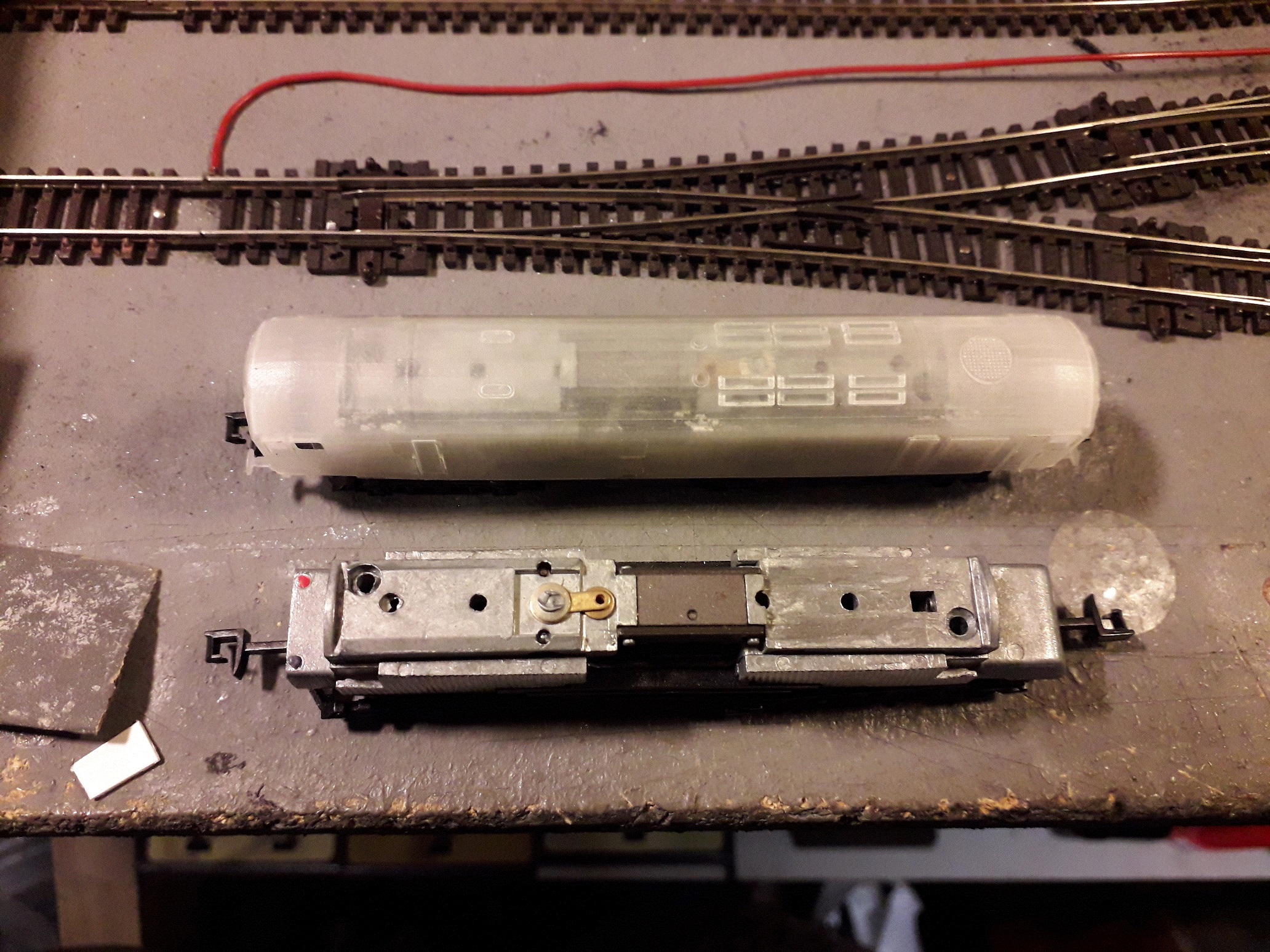

I have been working on a pair of CO-BO's and just got the chassis to fit, then found that the couplings were too short due to the body overhanging the bogies by some distance. @mark100 suggested using BH enterprises extra long whitemetal couplings but although longer, I found that they cause buffer locking on 12 inch radius points (medium radius to you) a certain amount of head scratching followed by a flash of inspiration, why not try the extra long couplings that came with the early Dapol autocoaches? so I robbed one coach of its couplings and attached them to one of the Co-Bo chassis and tried again. result? SUCCESS!
The autocoaches that I robbed were tried out with the left over BH enterprises couplings and a Dapol 14xx and I can confirm that they worked ok as the later models seem to have had shorter couplings, no doubt due to the huge gap the originals caused between engine and coach. I am a much happier hector today

The early Autocoach couplings were not NEM.
The later Autocoach couplings were - and those bogies are now shared with the Siphons which is why the siphons have such a horrendous gap between them.
Dapol of course made great play in publicising the siphons being "now fitted with NEM couplings"...
Bob

No Jerry, Bob, neither the loco bogies or Autocoaches use Nem style couplings, I am fortunate enough to have had 3 of the old style autos to hand, but I will be in touch with DCC supplies to see if they have any of the old style long couplings on Monday

A little progress made, but I am not yet satisfied with the bodies, a little more sanding and filling to be done, but I couldn't resist trying them out, so out came the Conflats and the Condor rides again!

So... my take on the Shapeways Co-Bo as painted and decalled by AEM. It sits on a rolling chassis made up from Farish spares from BR Lines, with the Shapeways bogie sides attached to the (hacked about) Farish bogies. I'm not entirely happy with what I've done, especially at the "Co" end, as ideally the bogie sides should be closer in to the wheels; I'm wondering whether to have another go. Taken from this view, it also looks a tad high, which is a little frustrating as I spent ages trying to get everything to sit level and buffer up correctly. Couplings are long shank 3D printed ones (Shapeways again); I'm wondering if it's practical to paint them black?
Would welcome any thoughts from more experienced builders; this is the first time I've attempted anything like this.
