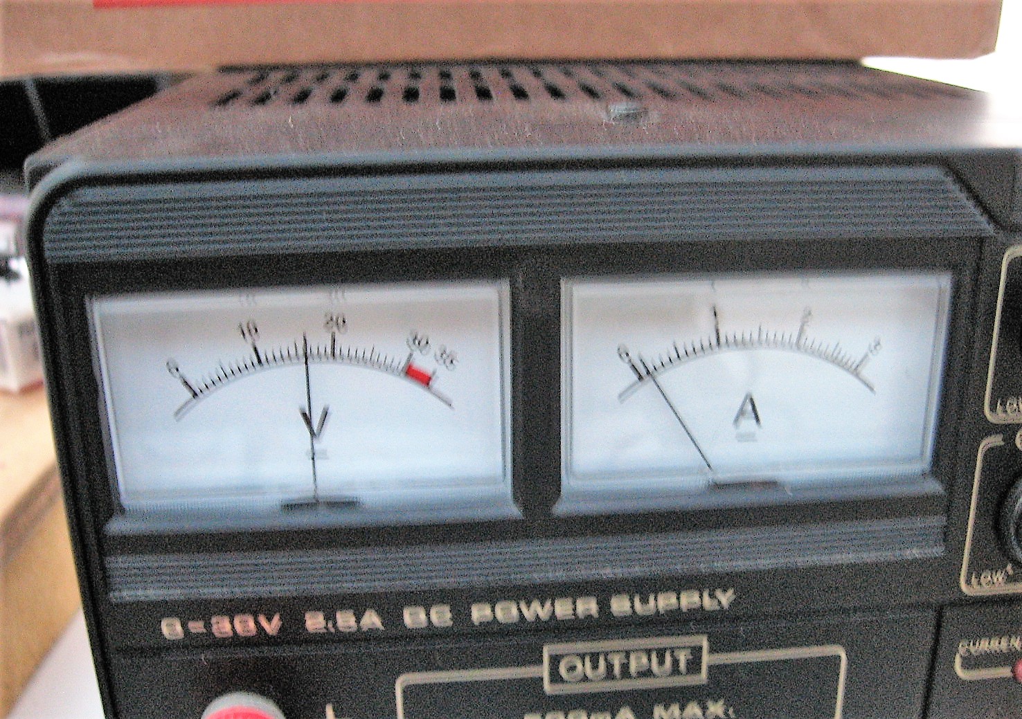

I'll run a test with one of my 9225s still unused in its box.  I'll run both bulbs at the same time at 16V DC (which is equivalent to 16V AC RMS)  for a few minutes
[edit] Yes they do get hot at that voltage!  I'd never noticed before but then I don't go around touching the signal heads very often! This was an excessive stress test though, running two bulbs at higher than suggested voltage.
I'll take the voltage down a little....
[further edit]  At 14V (the recommended maximum) one bulb draws approx. 60mA and the signal head is quite hot.  At 10V it's down to 50mA and is just mildly warm, and in my opinion the light is still acceptable for a signal.

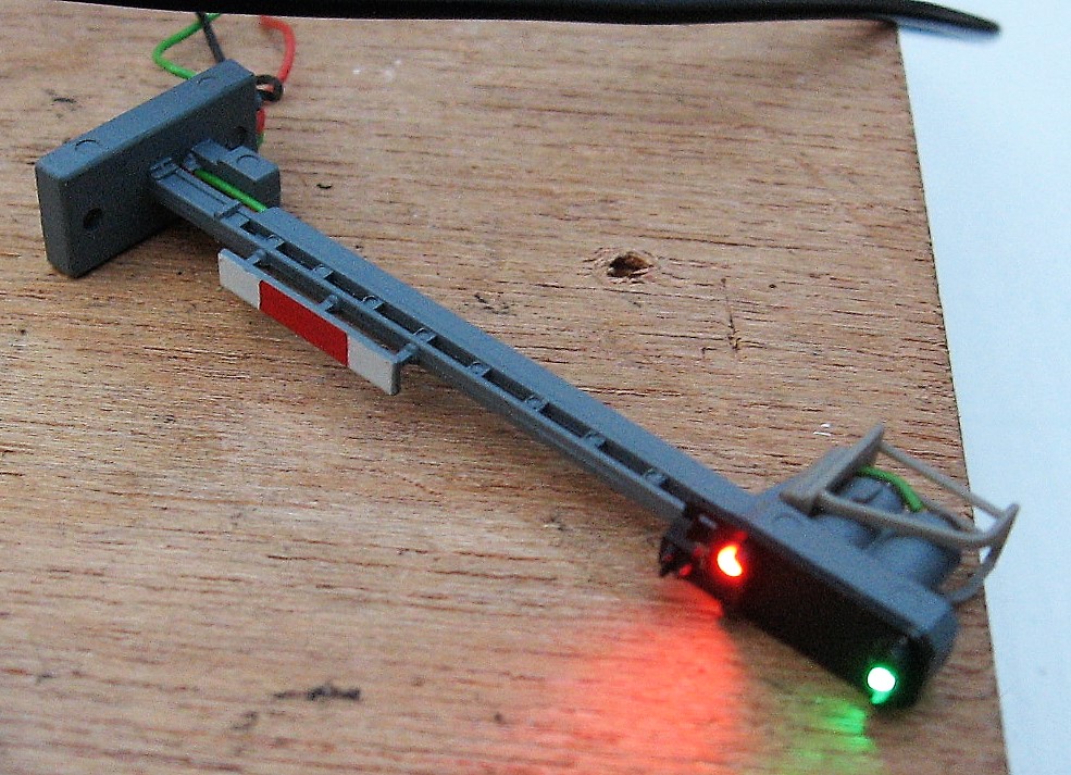

Just shows why we've moved to LEDs these days! an equivalent tiny LED might draw 5 -10mA, certainly the really tiny ones I work with are fine with 3-5mA.
Modern model signals eg. Busch, Brawa and Viessmann are all tiny surface mount LEDs, and can have many more aspects on one head than these old Fleischmann signals.

Thank you very much for doing all that, it is much appreciated. I have Viessman signals with the leds as well and so I tried one tonight to see if they would run hot. I had one on for about an hour and there was no heat generated. Thanks again for your help.
