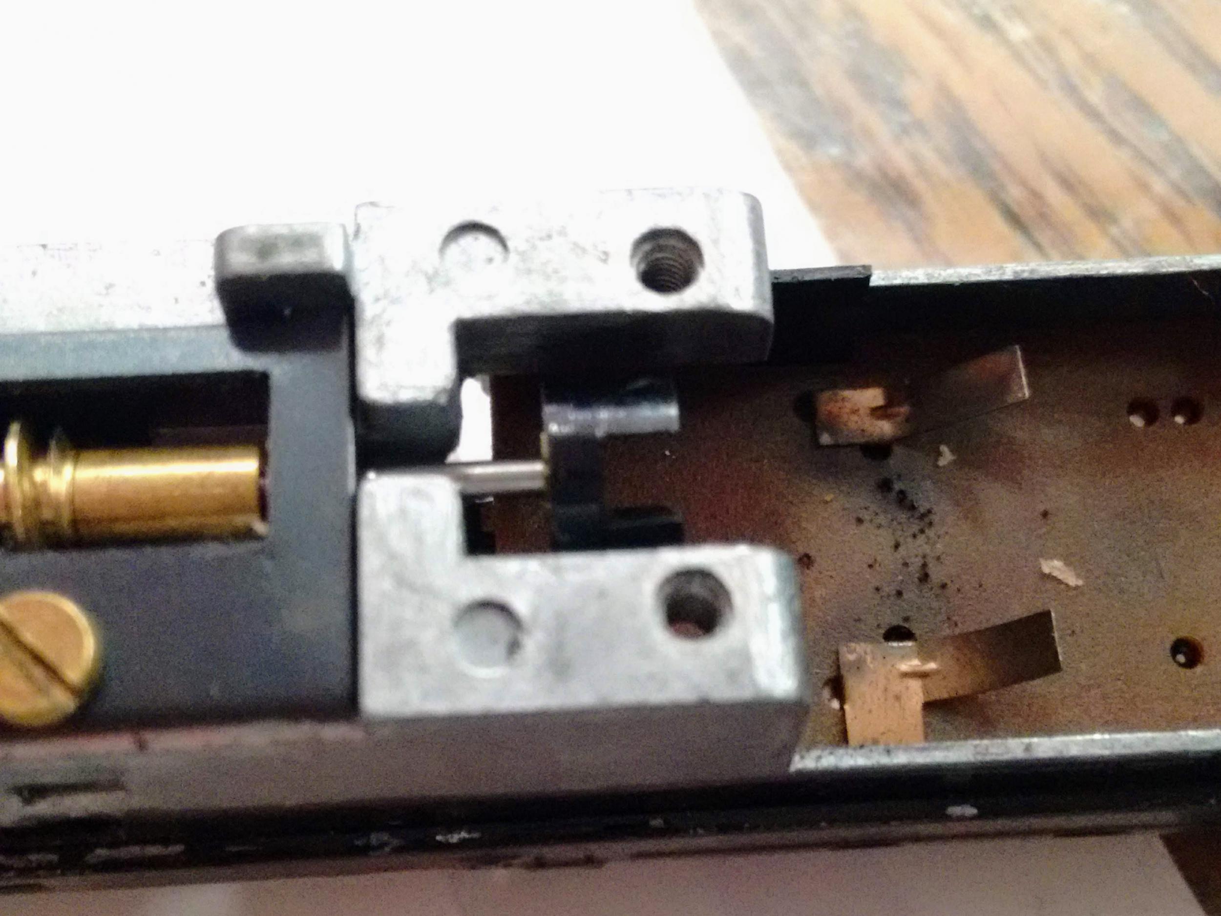

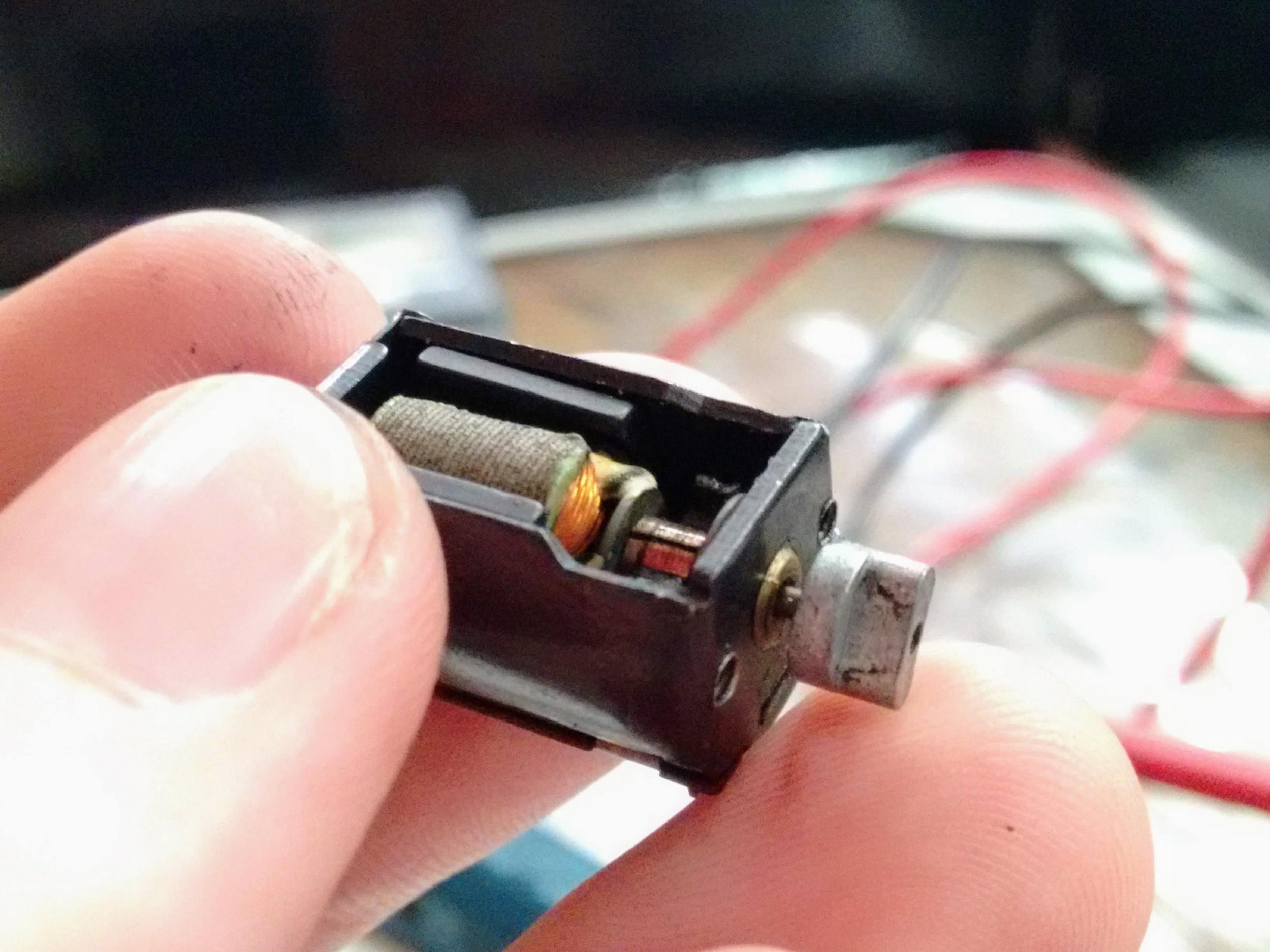

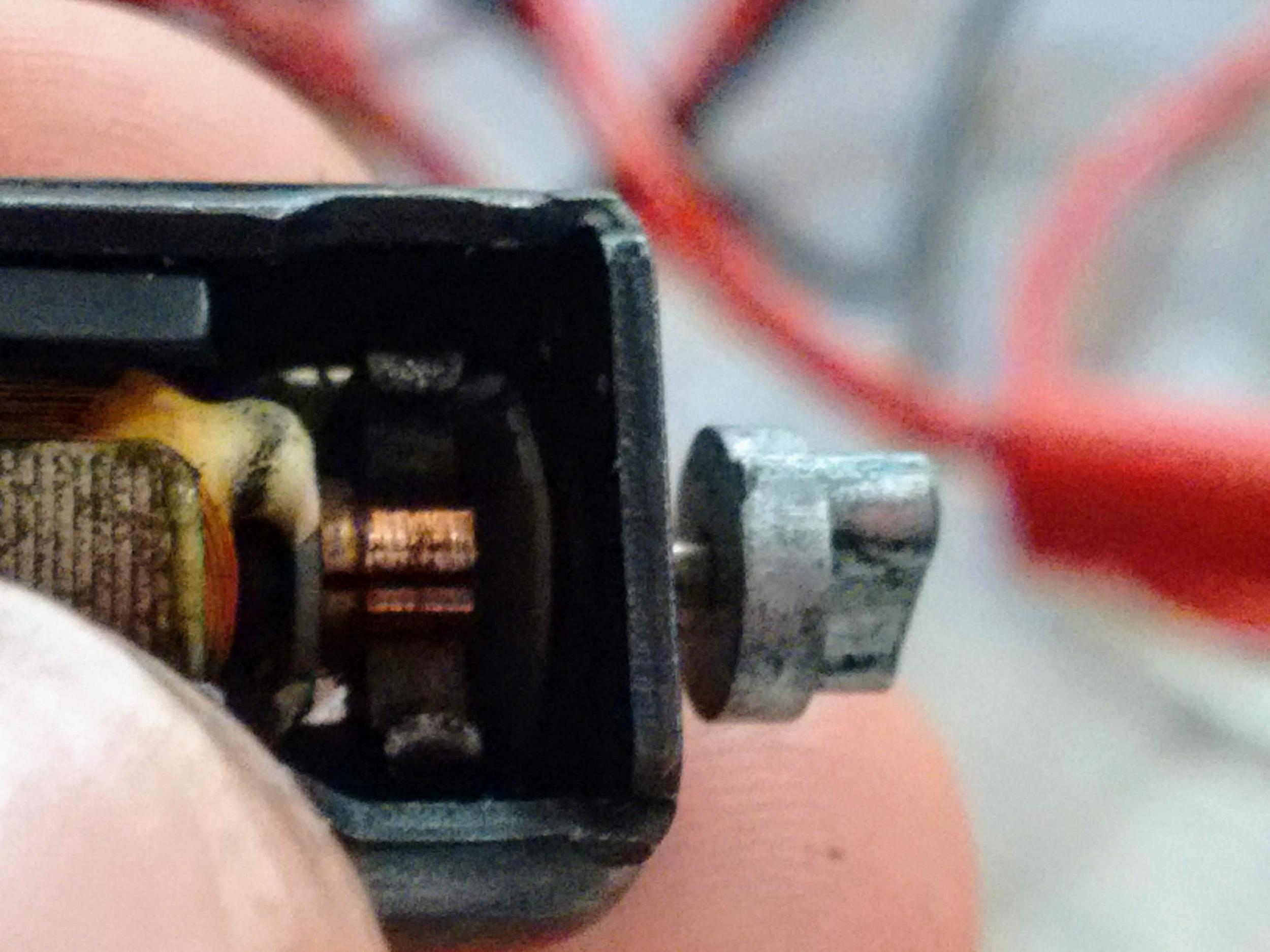

The other day my Minitrix warship (Hermes) suddenly stopped moving. I stripped it down and found that the metal piece which allows the motor to turn the screw thing (can't remember the proper name...) on one of the bogies is loose on the motor axle.
The metal bit on the end of the axle is no longer fixed to the axle so can turn without the axle turning. This means when the motor turns, the axle does not turn the metal bit and therefore the screw in the bogie is not turned.
The slot which the metal bit turns:
My guess at fixing it is to put a small blob of polycement (or equivalent) on the axle holding the metal bit to it.
However I'm not sure if this will work: it might not be strong enough, or the glue might block the motor from sitting back in the chassis properly.

Polycement won't work, that's a plastic solvent glue.
I had one suffer that problem way back in the 80s.     A tiny amount of epoxy resin on the shaft sorted it out just fine.
Something like Loctite would probably also work, or superglue although that does sometimes fail over time.
Whatever adhesive you use, just be sure you don't let it flow into the motor bearing.  Just need a tiny amount in the tip of the shaft and then push the coupling piece back into place and let the glue thoroughly harden.
The coupling piece doesn't come off at the moment, although I haven't tried too hard. If it spins, in theory it should be able to be pulled off so I'll give it another go and put glue on the tip of the axle as you suggested.

I've done that now and it seems to have worked (I managed to fix the short circuit by dismantling it and reassembling it a few times). Thanks for the help!

Hi Jonathan,
This is something that happens regularly with any Minitrix loco that have the cast metal drive coupling.
In the past I've fixed it byrunning white metal into the shaft hole in the cast metal and then pushing the drive shaft in whilst keeping the drive connector hot.
You do need to havea heatsink on the driveshaft though! I used some copper croc clips for this.
In cases where it was not possible to do this i filled the hole in the cast drive cooupling with white metal and then drilled out a new hole.
