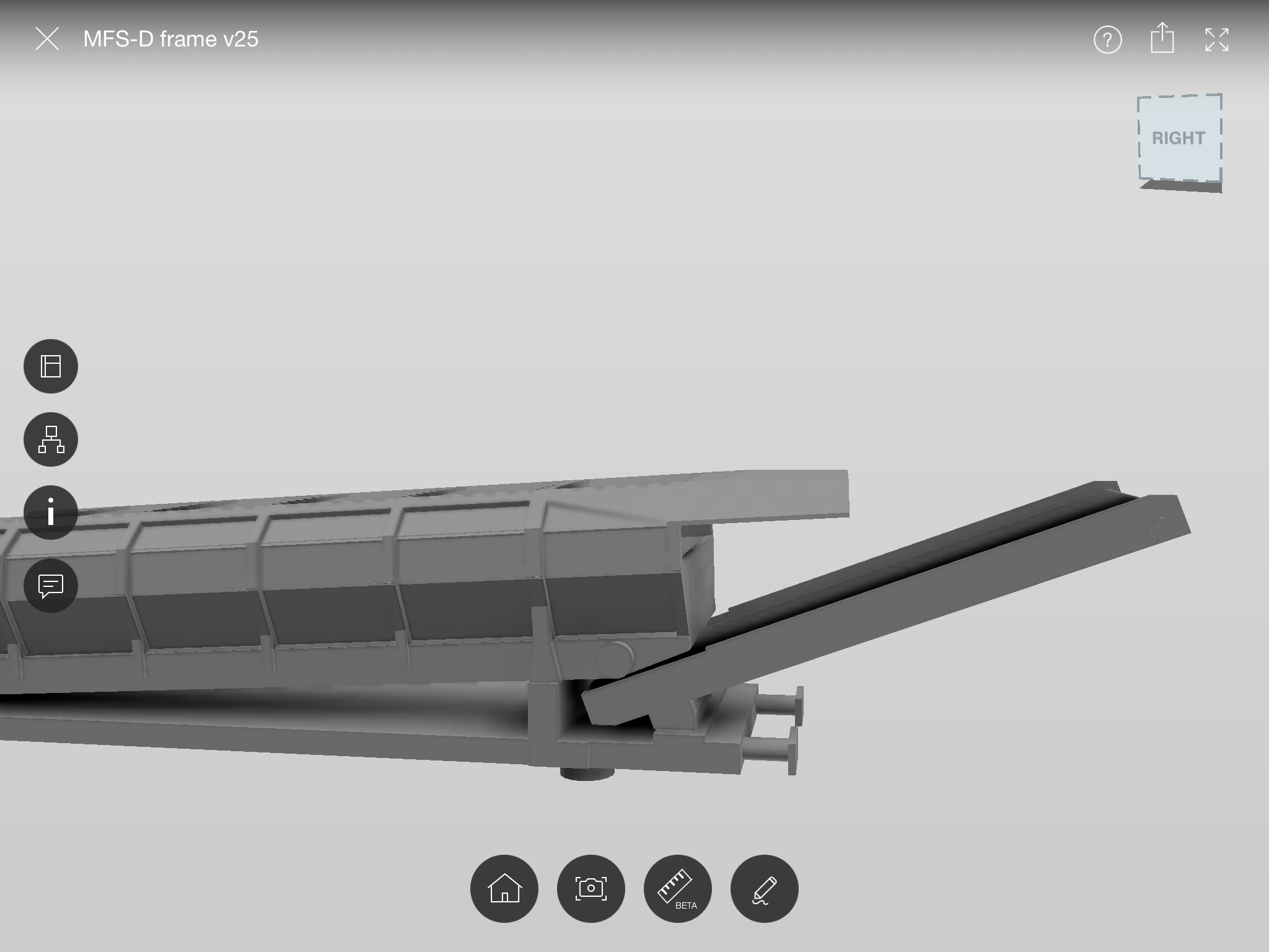

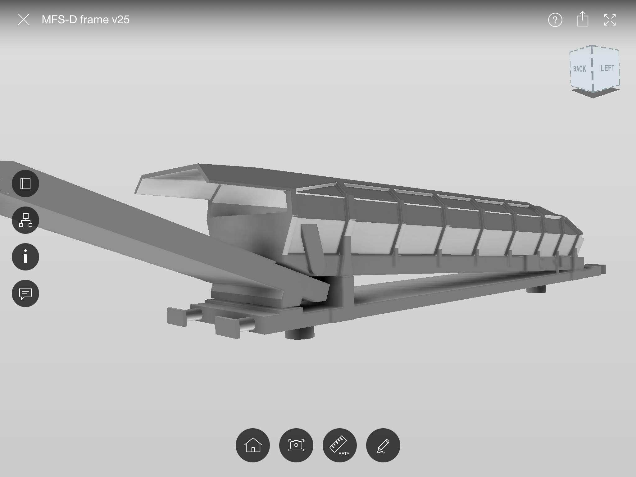

After some one getting confused about what part this actually is. It is only the hopper at the moment I have stared on the swinging conveyor between wagon and the frame for the wagon. As you can see in the cad I have started on the other parts.

Hi everyone sorry there has not been an update for a while. As I have been in Holland for a week then I noticed that the wagon looked smaller than it should so after some discussion we worked out that it needed to be widened by quite a bit so the actual wagon itself hasnít progressed that much. But now that problem is sorted I should to be able to work on the rest of it.

Hi everyone over the past few days I have been working on adding detail to the hopper and sorting out what other details I can add to the print . To complete the model I need to :
- add the cab floor/ seats
- put in the conveyor on the inside
- put holes in the supports for the hydraulic pipes
- finish off the conveyor
- add the boxes that are underneath the wagon frame
It sounds so simple in that list but it will definitely take a while to finish the wagon. At the moment I am thinking of making it a multi media kit where people would need to buy bogies , the wire to make it look like there are hydraulic pipes running along the sides and I am thinking of doing an etch for some of the more detailed parts like the hand rails and steps. What are your views on producing a kit for this wagon in this way?

I have now done some detail with the hydraulic motors and also I have finished the cab roof. I have also discovered that there are 2 versions of the MFS-Ds I will be modelling the more modern one so that it looks better with the current HOBC.
As you can see I am still quite a way off.  :hmmm:

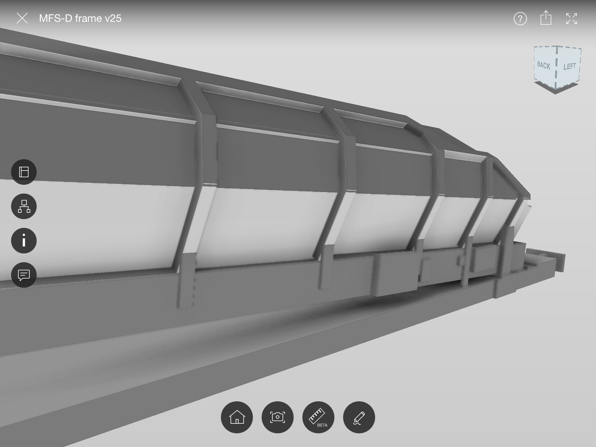

Sorry for not posting an update for a while but I have been away for a couple of weeks so I havenít had much time to work on the MFS-D. It is now starting to look more like a wagon as I have started adding the numerous boxes and storage containers that are underneath the frame of the wagon.
