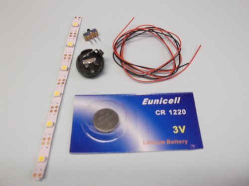

I bought the whole kit from "Layouts 4 u" . Price is 4.25 and everything here is included, along with simple instructions that are easy to follow. There is a choice of white or warm white, and I chose warm white.

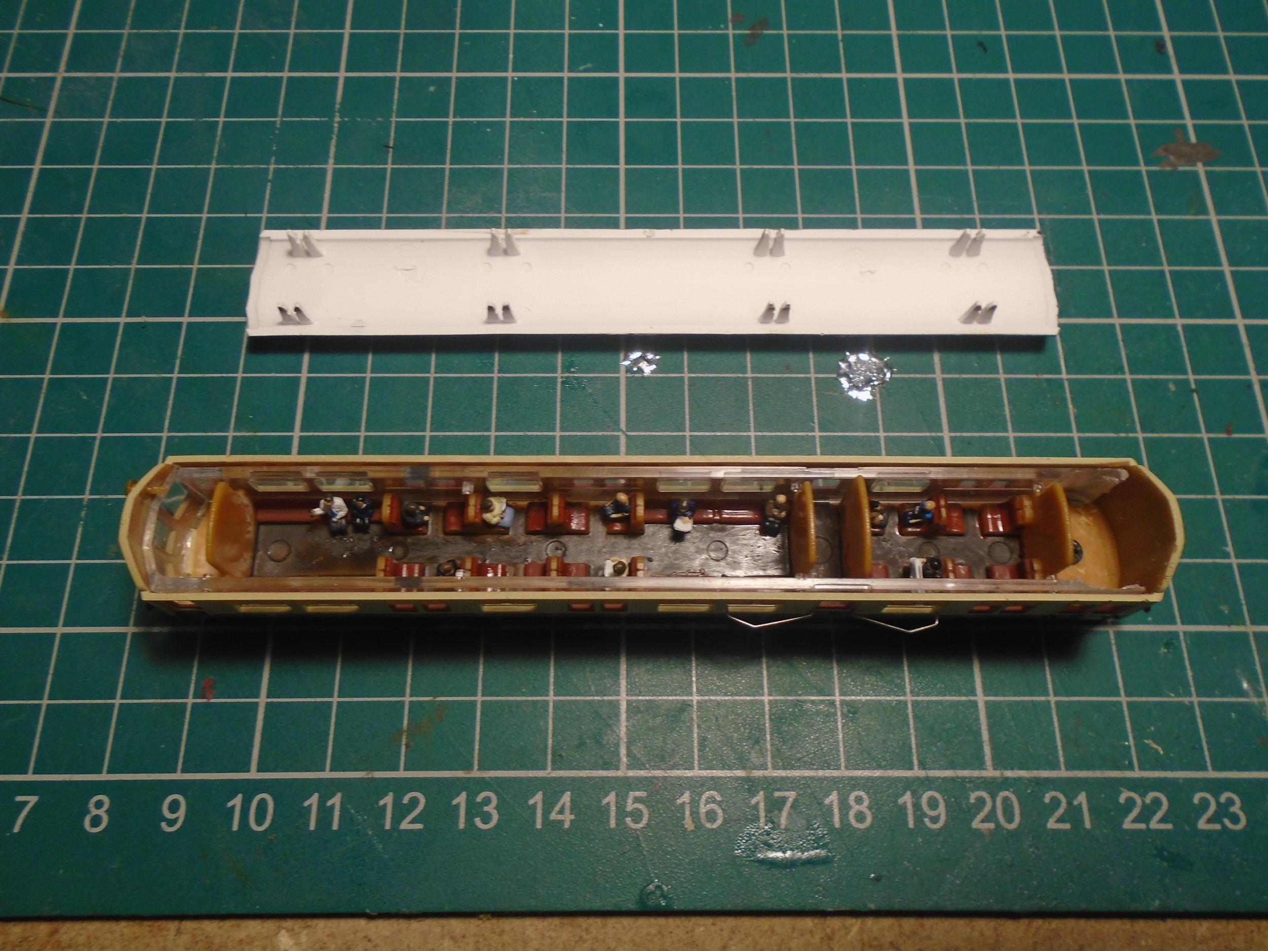

Firstly, I very carefully took the roof off by sliding a scalpel blade between roof and carriage sides, being so very careful not to scratch any paintwork. Then I painted the floor and seats, and put some little people in. As the windows are quite big, and the station is right at the front of the layout, I wanted nice figures, not the Chinese "hundred for a quid" ebay type ones. They certainly have their place, but not here  ;)

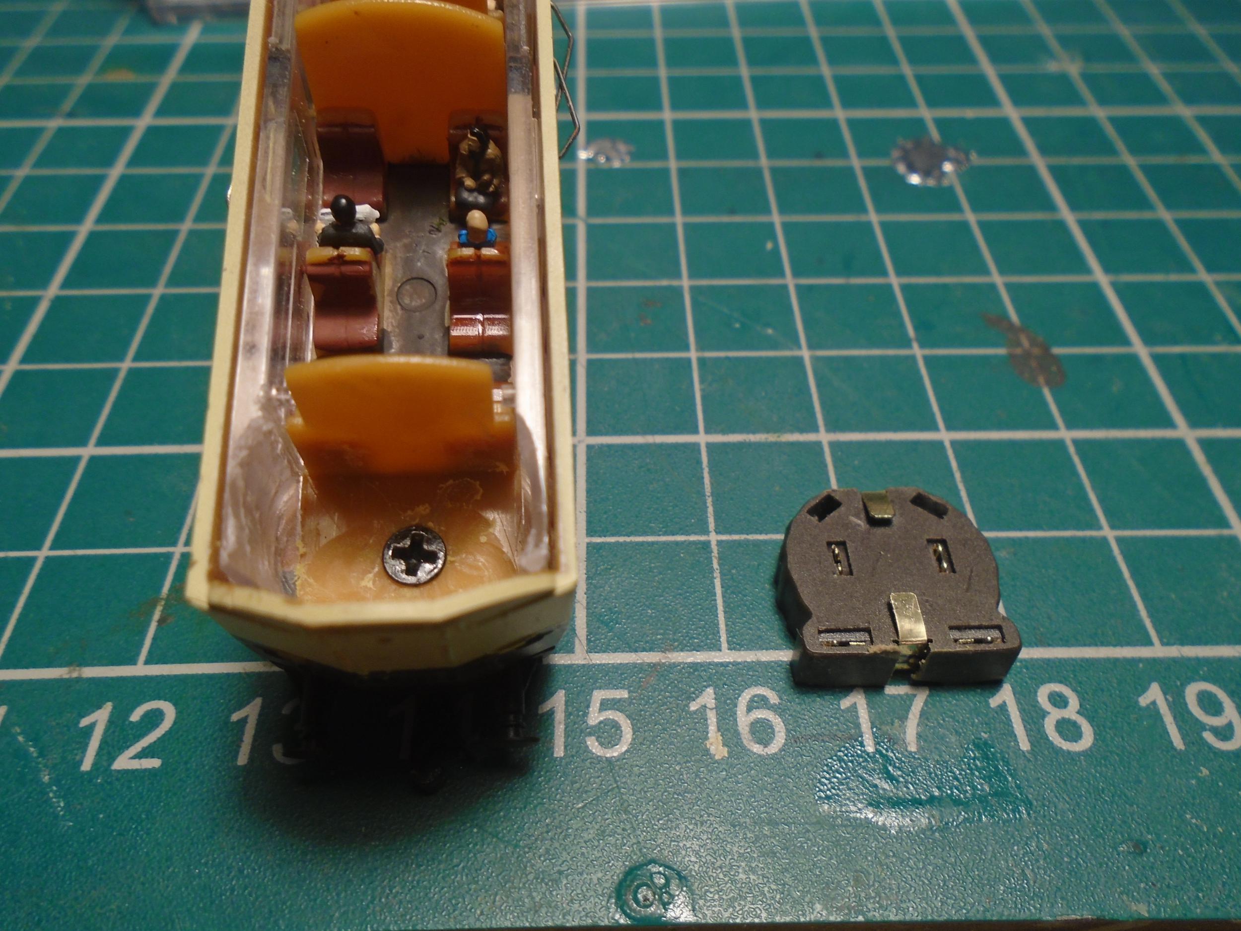

The glazing panels are really thick, so the battery holder does not quite fit. I used a dremmel to grind a curve in the plastic and that lets the battery holder sit nicely. Also to give more room I ground the screw housing at the bottom of the compartment down, and used a countersunk screw. I also bent the battery contacts inwards rather than them protruding over the edge of the case.
Ideally I would have taken out the glazing, and cut the ends off replacing the windows with the stuff from Metcalfe kits. The glazing looked to be just clipped in, but I tried really hard to unclip it, and was in severe danger of braking something  :worried: so did not pursue that course of action. If I was doing it again perhaps I would persevere and do that

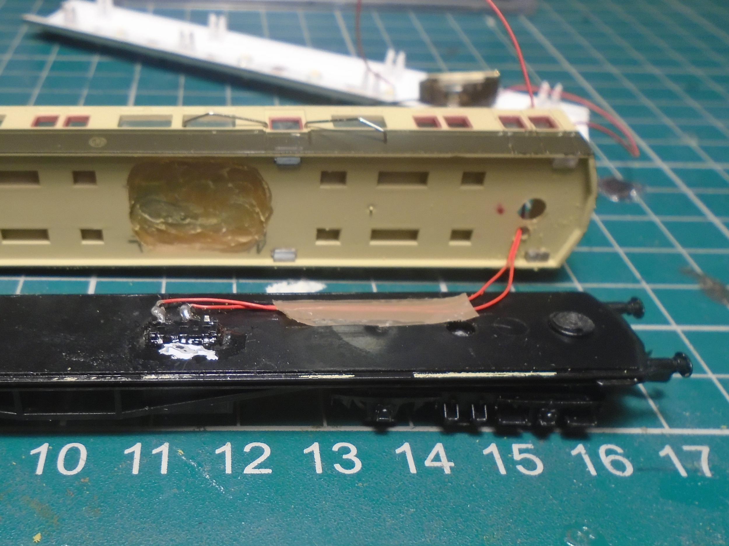

Next up was to cut a hole in the undercarriage for the switch. Before gluing it in, I held it in with blu-tac and ran it round the track to check it would not catch on anything.
With it glued in place, I soldered the wires on, and bent the terminals flat. The switch terminal area would not sit as flat as I would have liked, so out came the dremmel, and I made a hollow in the bottom of the coach body for it to nestle in. Even then there was a very slight bulge when the body was screwed on, as the screws were only at the ends, so I decided to glue it together for a tighter fit, which was great. It also meant that I did not have to use the countersunk screw, which was catching a bit on the wheels at that end where it came through the bottom.
On this photo you can see the clips for the glazing panels I could not unclip. Also to get the carriage body off you need to unclip the handrails from the bottom of the steps on both sides. I kept them clipped to the body so I would not loose them.  :thumbsup:

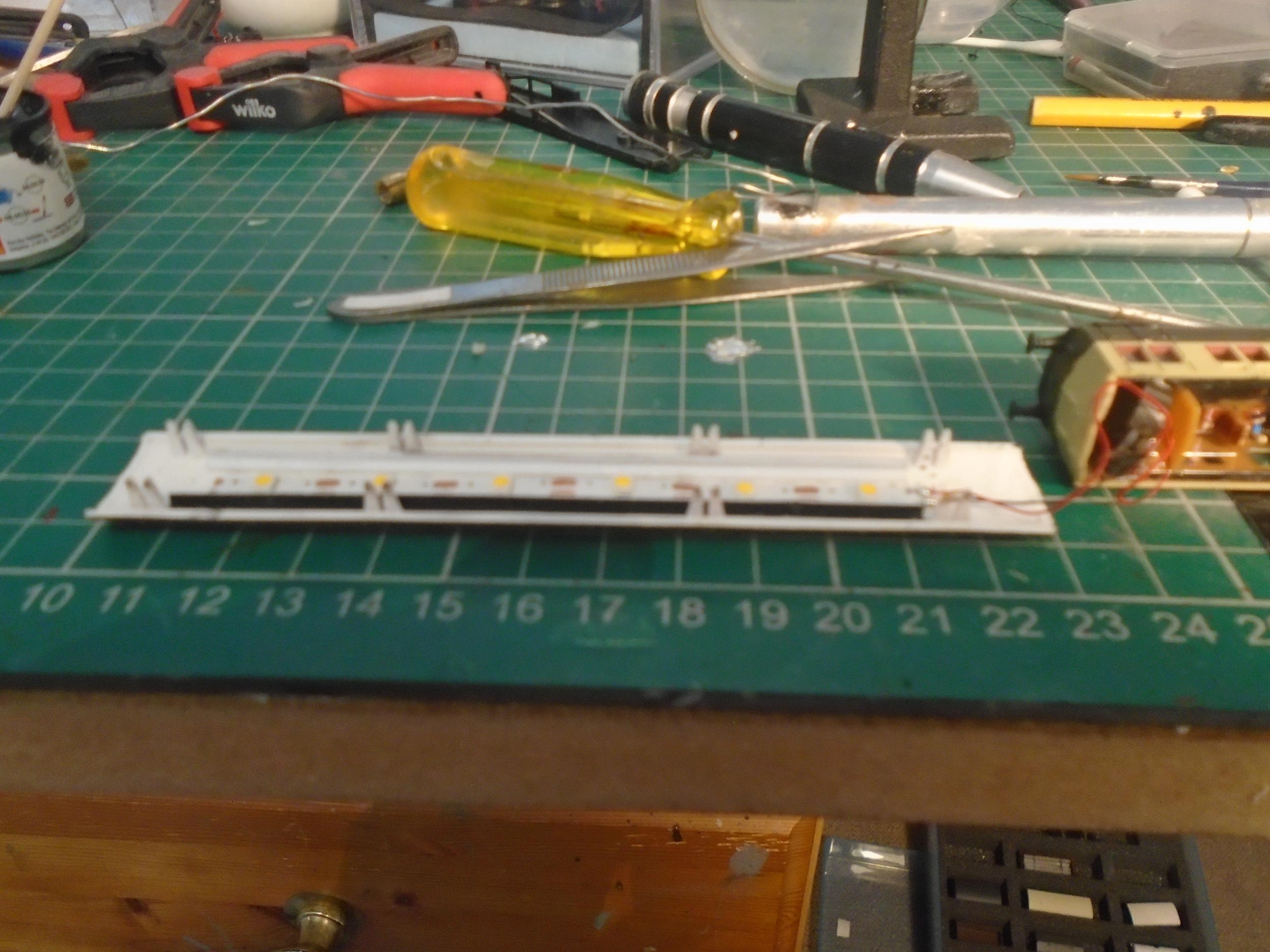

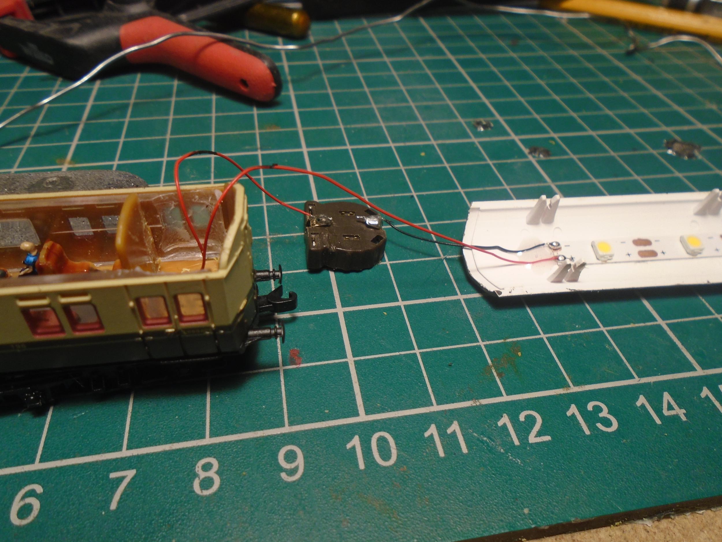

Then with the coach and undercarriage now together, The light bar (self adhesive) was fitted onto the roof, and the battery wired in. I used a bit of glue to the wires where they were soldered to the lightbar just for a bit more security.
When everything was clipped together, there was a bit of light leaking through the join of the roof and coach body. That was easy to fix though, with a couple of lengths of 3mm angle glued along the inside of the roof, with the outside faces painted black. The bulkheads in the carriage needed to be cut a bit to accommodate this. Sorry this pic is a bit blurred

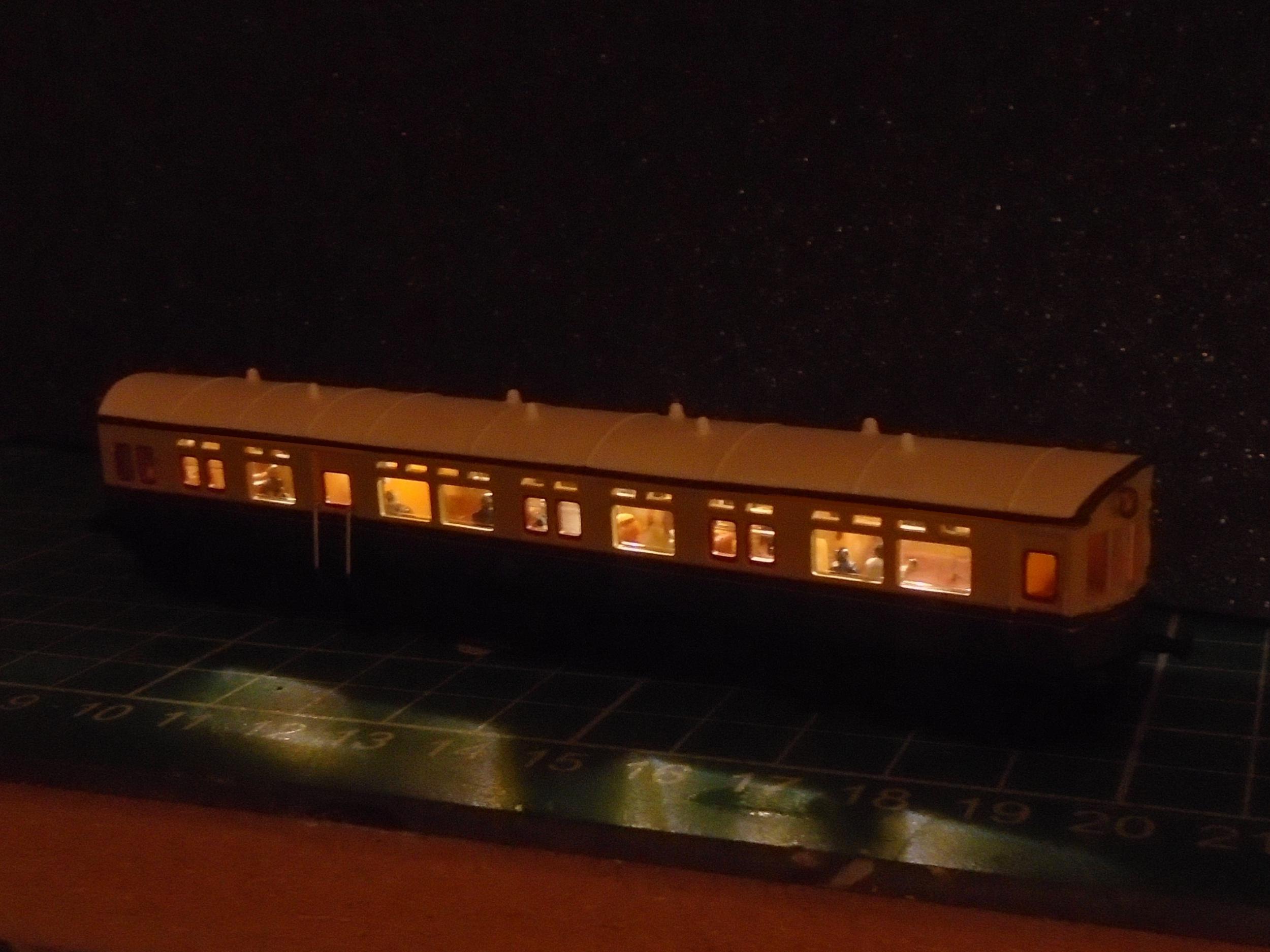

And here we have it ..... project completed ........ :claphappy:
