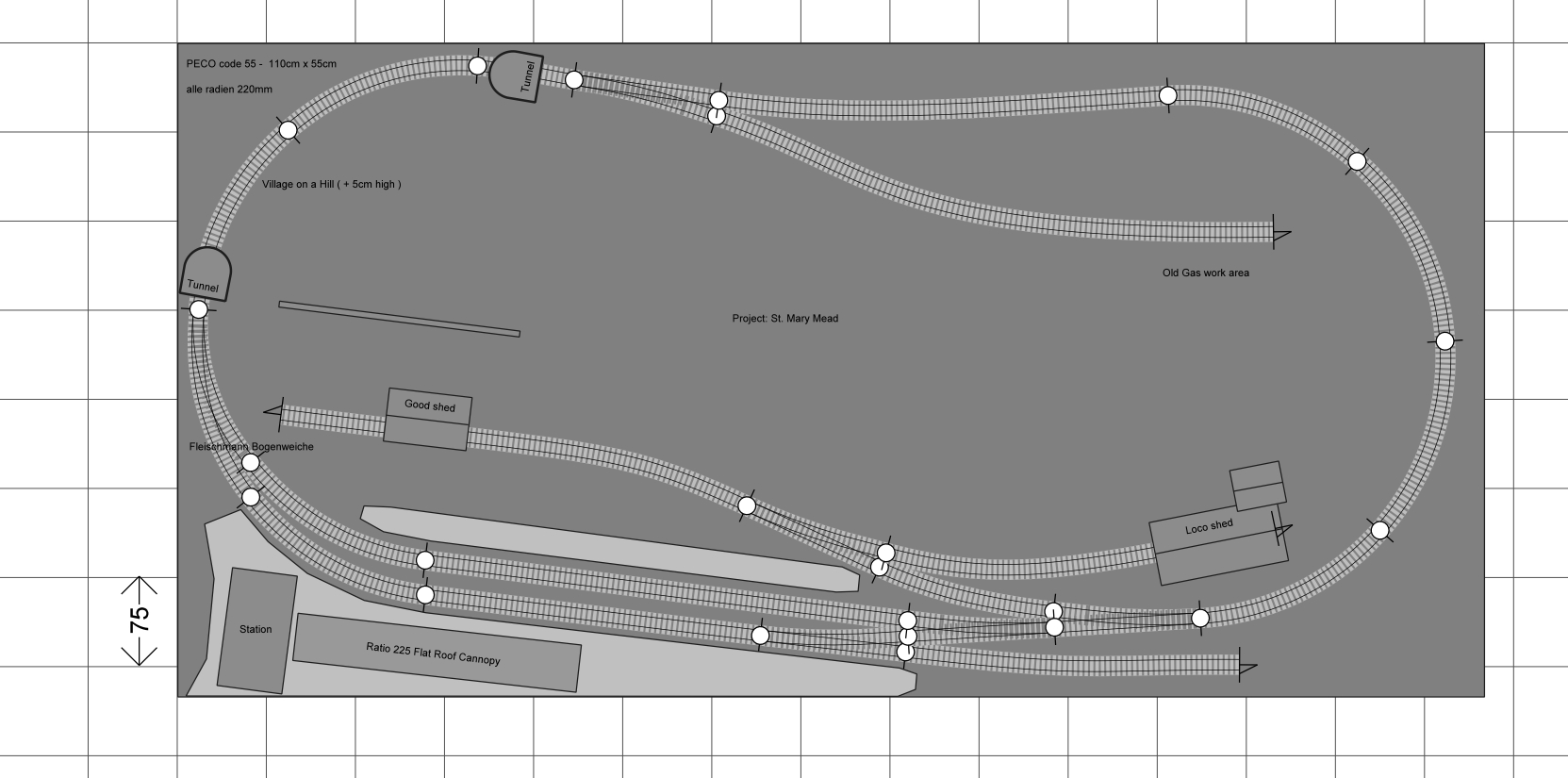

Now today i show you one of my plans for a small Modelrailwaylayout.
Let me explain some local circumstances :
I am under the rooftop, here is my little Kingdom,  from this room i can went out, to the roofterrace or over the circlestair downstairs  into our flat, so you can imagine that the room is very small, there is not so much space for a layout.
Here are my desk, my computer, and my Toys, and in the wintertime some plants and flowers from the roofterrace.
But I found a little space behind me in the corner of my room, here it is possible to build a 120cm x 60cm ( 2 x 4 ) layout, better a little bit smaller, because here i have two small „Lack“ IKEA tables 55cm x 55cm which i want to use as the basictable of the layout.
I planned a lightwight flat baseboard made from 10mm poplar plywood which is measured 110cm X  55cm  ( 3,6 x  1,8 ).
The Project Name is St. Mary Mead
Where the devil is St. Mary Mead  ?  you don´t know ?  remember,  its easy, Mrs. Marple is living there.
It is a fictionel village with a Branchline Railway Station.
Some more details:
Planned with Any Rail 5
Track should be Peco code 55 all radii 220mm
Using DCC for drivin the Locos
Era 4 & 5 ( mostly Steam some small Diesel and DMU )
Buildings from Hornby Lyddle End, Graham Farish, Ratio and Metcalfe
And here ist the plan, tomorrow i will print it in 1:1 scale.
Good night.
Michael
 :sorrysign: the picture looks very small

I very much like your track plan, especially as you have no track parallel to the baseboard edges :thumbsup:
Small diesels should be OK with 220mm radius but some steam locos may not so I suggest you seek opinions from the forum before making a purchase. Every loco is different as they are hand built but even just 10 opinions may help you decide.
Good luck, especially with sneaking your purchases past your good lady! ;D

« Reply #6 on: May 18, 2018, 10:32:02 PM »
Hello ,
first, thank you all for your interest about my planning.
Today i printed the AnyRail plan in 1:1, cut it and glue it all together.
I put some of my Hornby Lyddle End collection for  inspiration on it also some goods wagon
and my newest Train, so we have a nice overview.
Too much buildings in the village i think or they are to close together.
The goods shed seems to big for the little station, i take a look for a smaller one.
I like old gasworks but it can be replaced by the Grafar Brewery ( like beer much more than gas )  :beers:
Anyway, it is the first test, nothing is fix.
The Village will be located on a small hill ( 5cm high ) not on the track as shown, so i need a Tunnel  under  the village.
On the photos you can see the small space in the corner for this layout.
Let me know what you think about my planning and what you prefer, beer or gas.
Good night.
Meickel

« Reply #9 on: May 19, 2018, 08:33:51 AM »
Looks pretty good to me.
If anything, avoid straight lines for village roads, a gentle curve will, I think, work better on the eye.
Not sure about the house astride the track though  :D

I like the Lyddle End buildings and have several to put on my main layout. A great shame they were discontinued :'(
