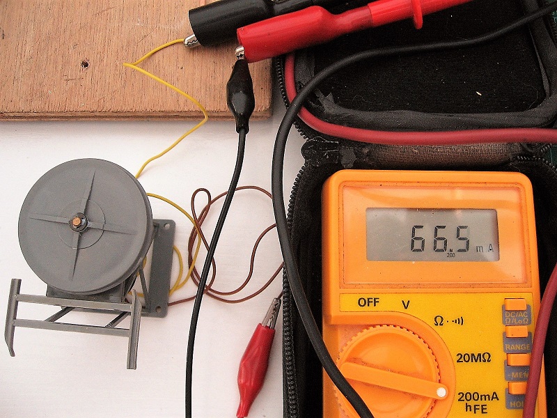

Online ntpntpntp
  • Posts: 2514
Re: Brawa n gauge cable car
« Reply #6 on: May 11, 2018, 01:47:56 PM »
I still have a set mint in the box which I bought over 25 years ago.  I recently dug it out to test and found the original grease had hardened and gummed things up.   I dismantled the mechanism, cleaned everything and re-lubed with a tiny amount of PTFE grease. It now runs very sweetly on about 6V.  @Big Pete maybe yours has gummed up and is drawing way too much current and blowing motors?
I'm toying with the idea of creating electronics with a PIC to drive it with PWM and a couple of sensors to time it when the cars reach the top/bottom.
Also recently acquired the Brawa funicular set equally mint, so now I have plans beginning to form up in my head for a mountainous board with both systems running!
« Last Edit: May 11, 2018, 02:35:29 PM by ntpntpntp »

Online ntpntpntp
  • Posts: 2514
« Reply #9 on: May 11, 2018, 06:44:46 PM »
@Big Pete  For you to have gone through three motors would seem to indicate there's something else going on.  The motor really shouldn't be dying unless it's being overloaded due to some other problem such as the gearing being much too stiff?
It's not difficult to strip down and lubricate the gearing, there's a split locking collar retaining the main large drum, if you remove that you can get to the other gears - but I presume you've done that previously anyway in order to unscrew and remove the motor for replacement?
You mentioned £1 (+p&p) to replace the motor, that sounds extremely cheap so where are you getting these replacements from? Are they originals as supplied by Brawa? Are they definitely 12-14V motors?
I've just dug mine out and measured the current draw: at 6V (which seems plenty fast enough) it's drawing 65-70mA. At 12V it draws 85mA but to my mind it's running far too fast at that voltage! I have no reason to believe that it would draw much more current once installed as a complete cable car system, the cars are so light, the non-powered drum at the other end rotates freely, and there's plenty of torque from the main drum it doesn't slow or draw more current if I apply finger pressure.
If you can extract and post the entire mechanism (motor and gear drum on its tower) I'll take a look at it for you if that would help (purely as a fellow enthusiast not a professional repairer!). PM if interested?
