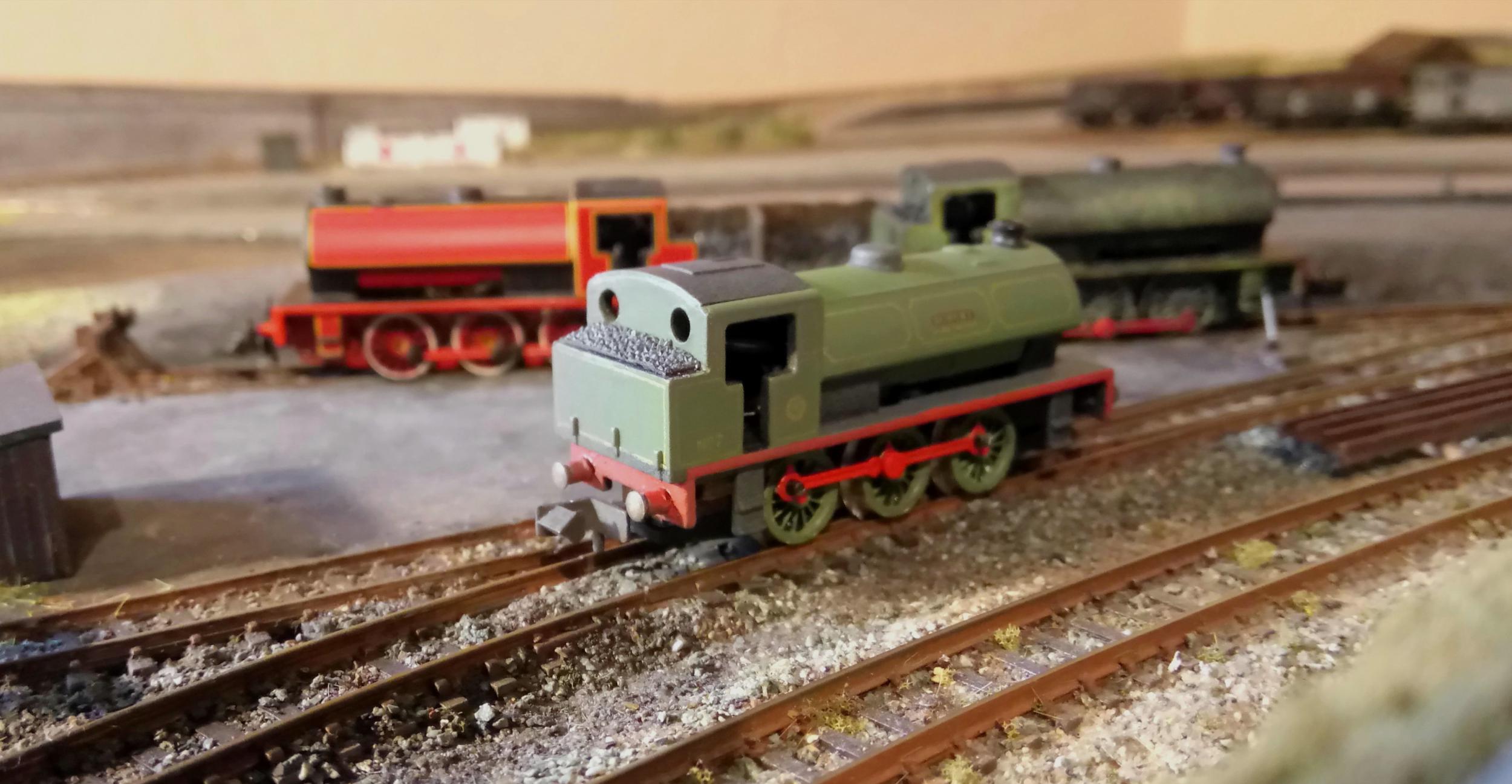

So, I carried out my previous window treatment.
Preserving the existing paintwork wherever I could, I needed to paint the cab back sheet, the wheels and touch up some blemishes on the bunker. I couldn't find an exact match, so lightened some Humbrol RC408 Apple Green with a little thinned matt white, which came close.
I used some left-over home made decals to line the bunker and tank front.
Repainting the cab interior gloss black, as on a previous J94 gives the bodywork a thinner appearence around windows and the doorway.
Here's the final draft result, lightly weathered and stabled next to Diana and NCB No.8. Like those two its windows will be glazed and the 'coal' replaced with the real thing:
Not a detailed scale model in the class of Dr Al's exhibition standard J94 but I feel a worthwhile improvement on the original.

Ok, that's about it for this little project:
I mentioned that I bought the body shell seperately. It's mounted on a Grafar Class 08 chassis which causes the interesting side effect that the loco runs the opposite way to my other J94s. I assume the bottom plates are different so that "nose first" running is consistent across loco types.
Shan't be double heading with this one then!
The elderly chassis (Ring and U-bend couplings) appeared never to have been oiled, so I gave it a complete service following Hyperion's procedure. Several half-hour on half-power runs in each direction, and both ways around, got it running smoothly.
To accommodate modern T-bar and Spring couplings, I simply carved off the round lug at each end of the chassis base plate and discarded the third retaining bolt.
I added longer couplings to allow the loco to push and pull things around tight corners. A little rounding off of the T-bar ends allows these to function well in the older round chassis mount.
Overall a satisfying little project to nudge a very old loco along the spectrum from toy to model!
